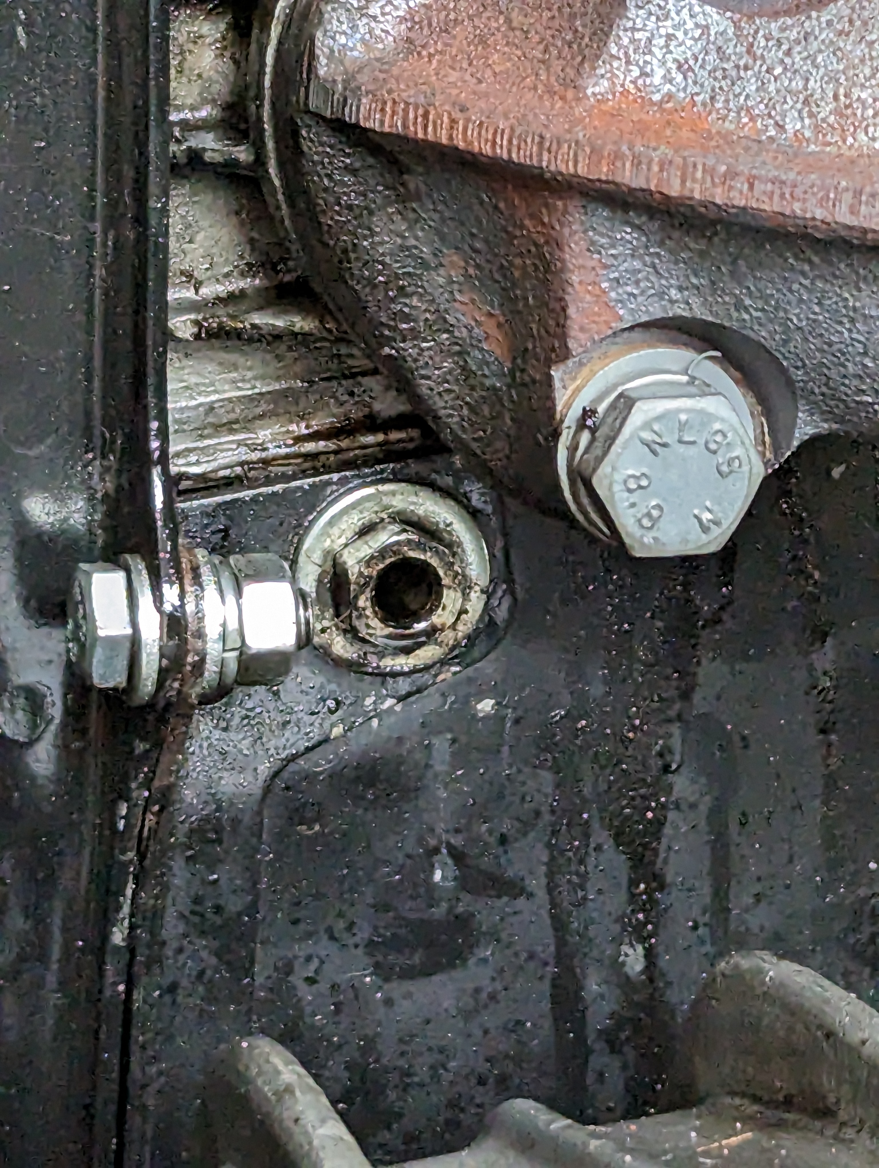

One thing I have noticed is that there is a hole in the front of the engine above the timing belt that occasionally spurts small amounts of dark oil through it under acceleration. A mechanic friend said there should be nothing open and that it may be an inspection port that should be closed - but I'm not sure this is accurate because the inside of the nut is unthreaded. In terms of why the oil coming from it is black, I'm unsure because the sump oil is clean (which is full). There's a pic below.
