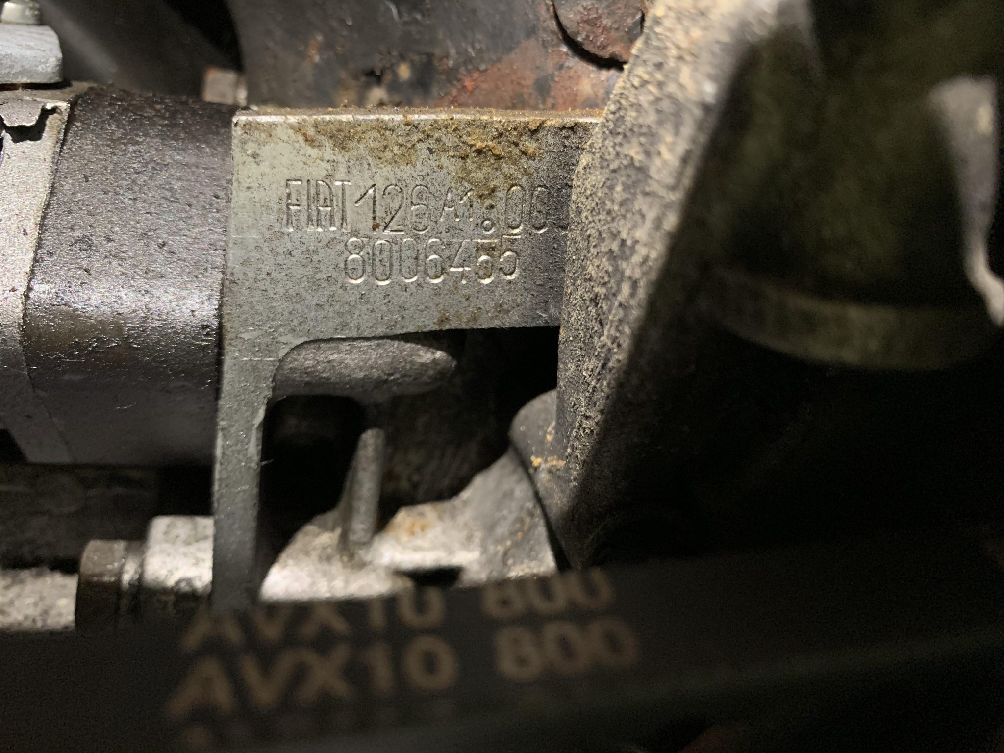

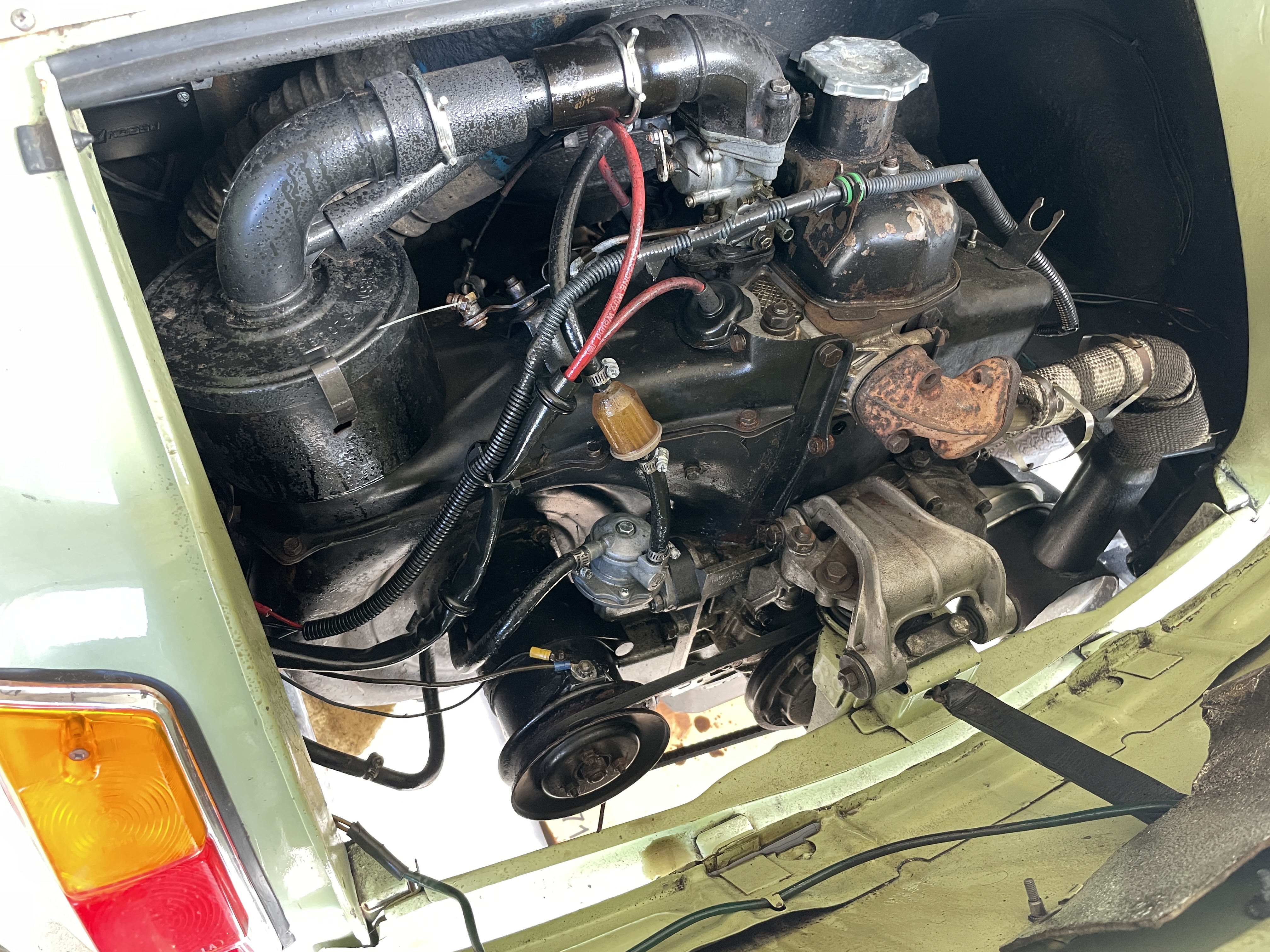

Yup. That would appear to be the case. A 650 with a dynamo

That's a new one on me----but PLEASE remove that fuel filter between the pump and the carb. (a) being plastic, it could melt and leak all over the dynamo and (b) you do not need a 4th filter---there is one in the carb, the top of the pump and the tank unit.
