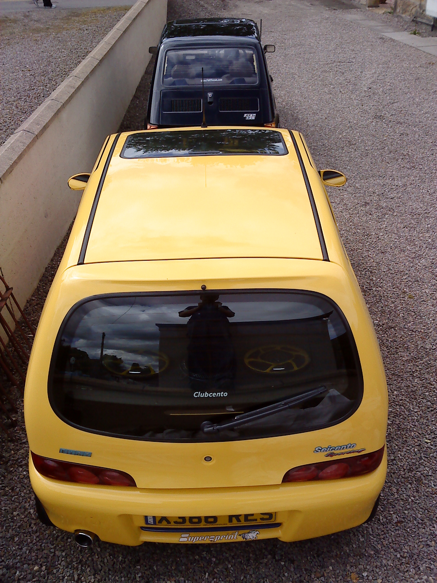

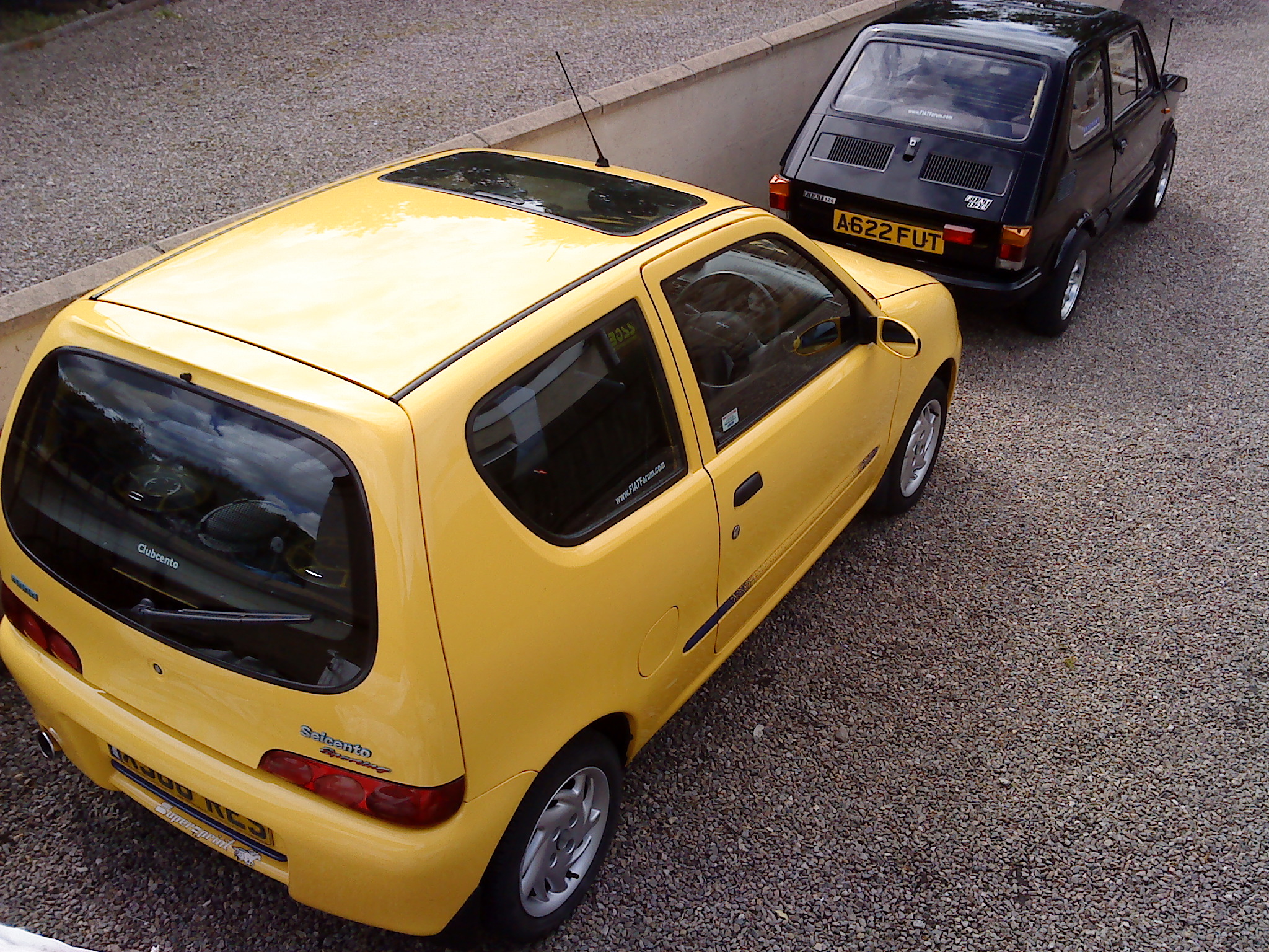

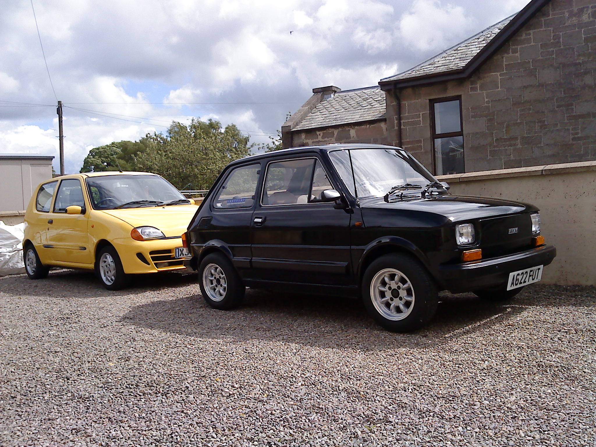

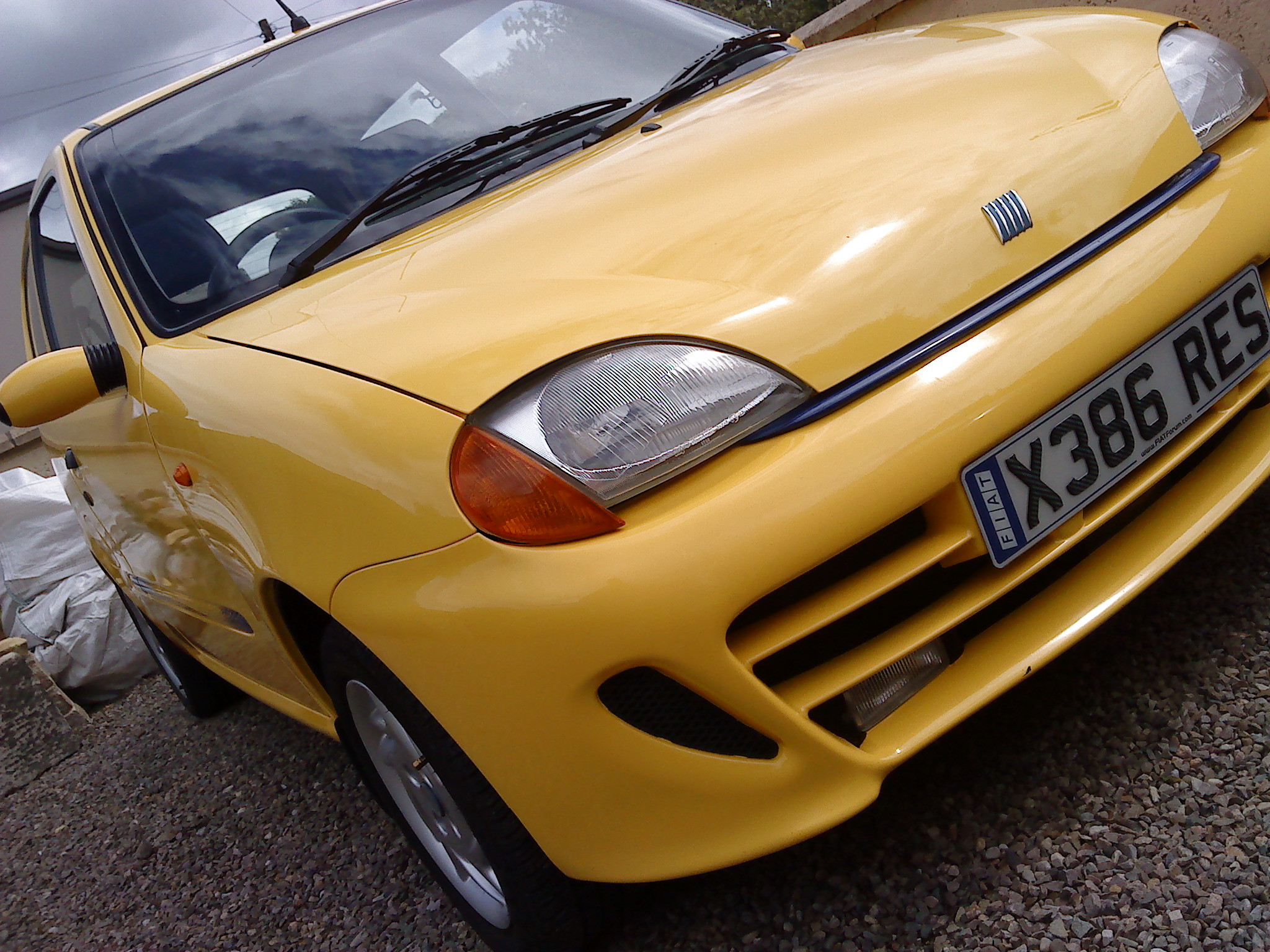

With the Scottish Italian Car Day looming, it was about time I gave the cars a proper clean. I'll warn in advance, I didn't get any pictures during only after so there will be a bit of reading for anyone interested.
I began with the Sei as it has more day-to-day scrapes and bumps.
  1. Autoglym Clean Wheels and a clean, stiff bristle paintbrush to get all the cack off the wheels
  2. Hose of all the loose dirt, of which there was a lot - there's a 'dustbowl' carpark behind our house :eek: and rinse the wheels
  3. Using a Sonus sheepskin washmitt and Autoglym Body Shampoo and Conditioner I then set to work getting the heavier deposits shifted, considering how little of this stuff is used (20ml for 10l of water) it fair shifted the muck! Rinse and dried with mf towels
  4. Meguiars Clay and QD - first time using clay and it was great, and the amount of filth that came off that I couldn't even see!! Dried off the QD with more mf towels (lucky I have about a dozen of them!)
  5. Autoglym Intensive Tar Remover - loads of black spots noticed when claying, used almost the whole bottle! I think in future doing this prior to clay would be a better idea.
  6. Autoglym Super Resin Polish and Autoglym Glass Polish - applied and removed with AG professional polishing cloths, good stuff

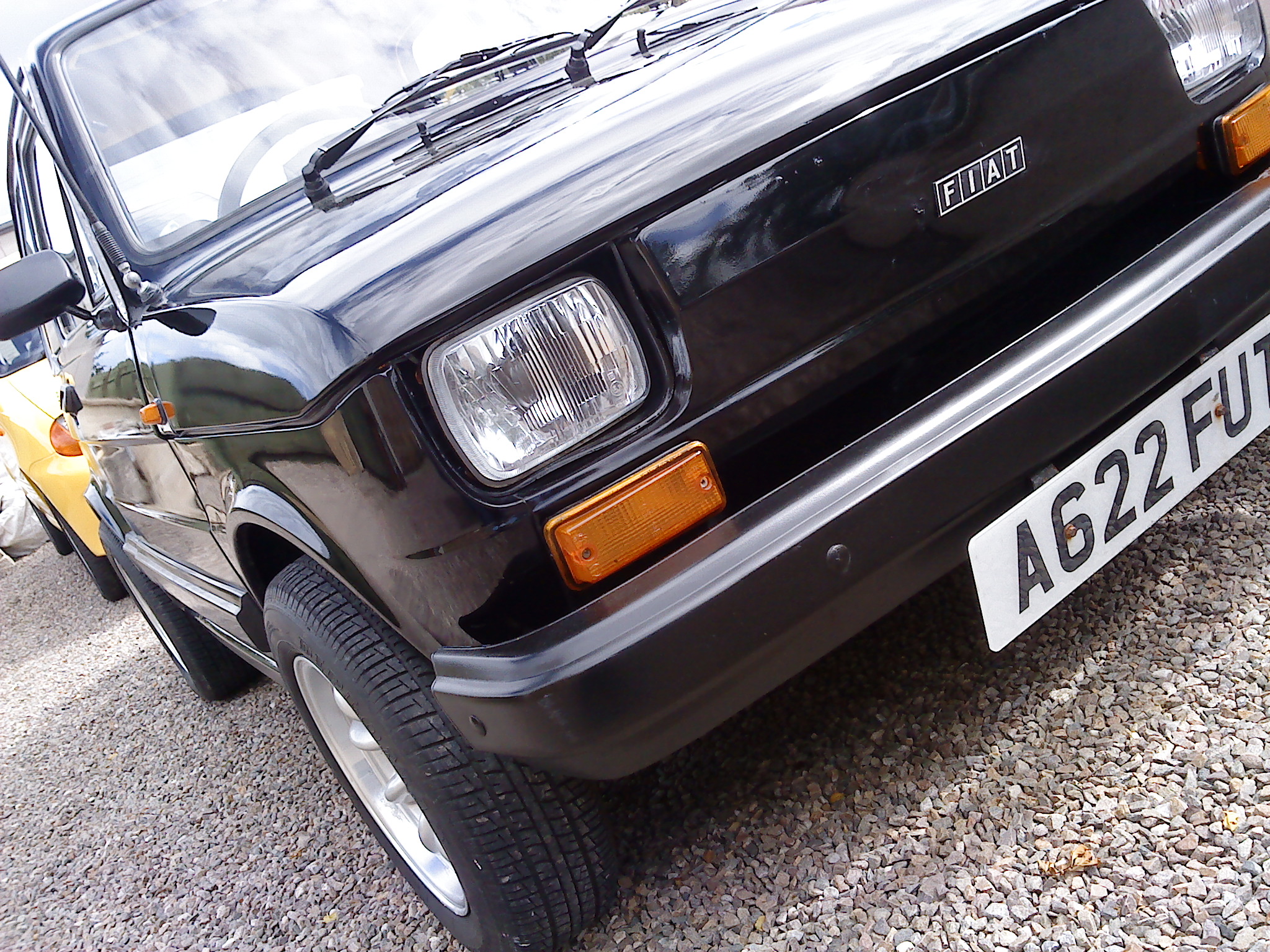

The 126 followed pretty much the same path, minus the tar remover, as it's not been exposed to much road use yet. After all the polishing had been done, it was Autoglym Bumper Care to get all the black plastic and rubber bits nice and shiny again.
For a first effort I'm very happy with the results, they don't reflect quite like Andy, Tris or Matt's cars do - mainly due to the shockingly poor respray job done on the 126! The results you can see for yourself!

tar removed before claying, although it makes little differance, did you dry the car after washing as theres not much point if your claying (unless it's seriously sunny), could possibly do with a sealent/wax of some sort although SRP will provide some protection. good stuff apart from that. Oh, dont use clean wheels to much its stupidly acidic look into some bilberry or very berry(cannot exactly rem lol) and then do the wheels i.e clean them, clay, polish, seal and even wax if your like then you can just use normal car wash to clean them save using alloy cleaner which does make the lacquer peel eventually. Megs and QD is ok for a start just change to a sprayer shampoo/water mix after finishing bottle as Meg's and QD in general is pricey to go claying with...
