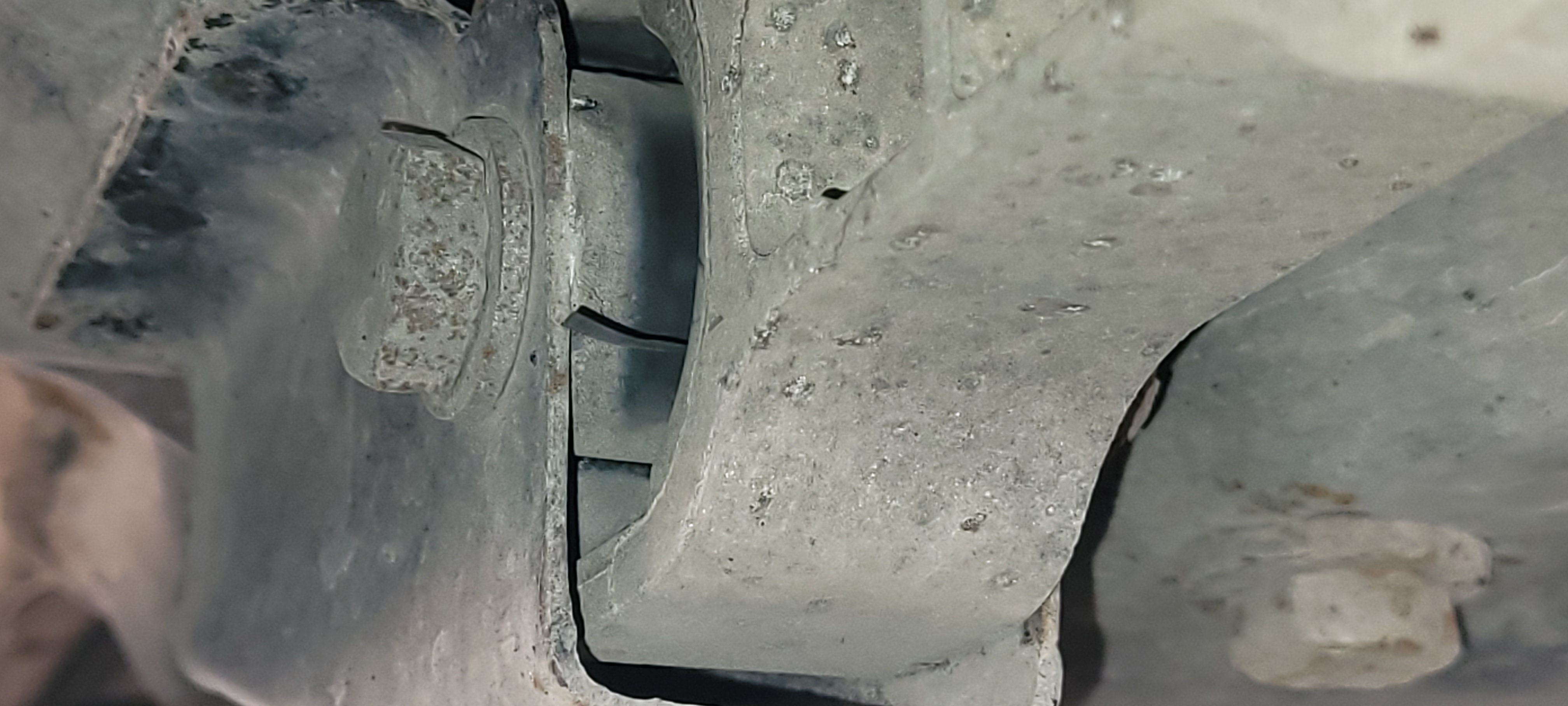

Can anyone tell by looking at the pictures below if this mount looks OK? If it looks OK, does anyone have any other ideas?
Edit: if it's not possible to tell from pictures alone, how can I test it to be sure?

Looking at your "dog bone" engine stabiliser in the photo it doesn't look bad , however it may be an idea to see if it moves a lot when leverage is applied, in case it is soft rubber/cheap pattern part.
I would have gone for that mounting first as a common issue on many makes of front wheel drive vehicles, though it may be an idea to check to top mounts also.
It's difficult without driving a car to diagnose correctly as many things can cause similar problems.
Generally it shouldn't carry on jerking once foot is off or on pedal as the change in load should only move the engine once in that direction, forward or back, so if longer jerking issue may be something else.
Unlikely to be clutch side as in hydraulics, if it does it only by moving the accelerator.
However if car has a "DMF" dual mass flywheel they can cause a snatch in transmission if badly worn, but I would have thought some metallic noise around that area with bonnet up may be noticed.

Thank you for the reply.
I'll jack the car up, drop it on some stands (maybe just drive it up the ramps if there's enough clearance), put the jack under the mount and see if it moves. I'll also take a look at the other two mounts and see how they look.
Once my foot is off the accelerator it does continue to jerk for a second or two and is quite aggressive.
The only noise I have noticed with the bonnet open is when the radiator fan turns on, possibly a bad bearing but that's another issue.
Once my dad is back off holiday I'll ask him to do a test drive as he has a much better feel for this kind of thing.
I have a trip to wales planned in a few weeks and really want it sorted before then.
Edit: I forgot to mention, it only really happens in 1st and 2nd gear, it happens in 3rd sometimes but nowhere near as aggressive.

The jack under the mount will be less effective as a test , the movement is forward and backward , basically the engine hangs from the two top mounts but the one on the bottom stops it from moving front to rear, so as long as the car is safely supported try and move the sump area forward and back.
For the jerking to continue with foot off the pedal doesn't really match with a engine mount issue to me.
The torque effect in lower gears makes it more noticeable.
Good to have dad as a second opinion, it's what makes us feel useful.;)

I tried pushing on the engine and there is a fair amount of play as seen in the video below. Is that normal or excessive?

Does seem quite a lot, more than the look of the mounting indicated. Is there any signs of the rubber separating from the metal of the bush?

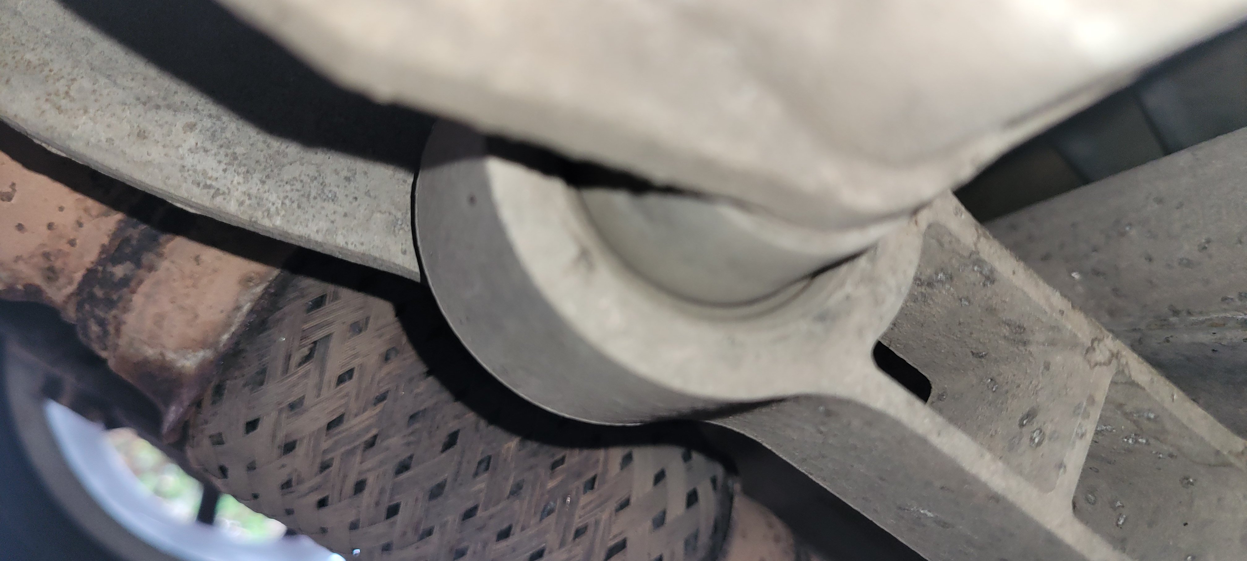

Not that I can see. There does seem to be a bit of loose rubber flapping around in this photo though.
The car was only bought last week so I'll take it back to them and try and get them to sort it out, I'd just like to narrow it down as best as possible before I get in contact with them.
Edit: I had a look at those powerflex things, might be a good idea to add one if I end up getting a new mount fitted.

Does look a bit suspicious, can you see any more movement or breaking away of the rubber when you put a bar or lever to move it?

I'd change that mount.
The movement looks excessive and the rubber is breaking up, so odds on that it's the cause of the shunting. The engine mounts might also be contributing to it.. but bushes tend to work until they don't, so if there's no visible signs of deterioration on the engine mounts, then they're likely to be okay.. Anyhow, a new bottom mount will highlight any other excessive movement, so do that one first.
