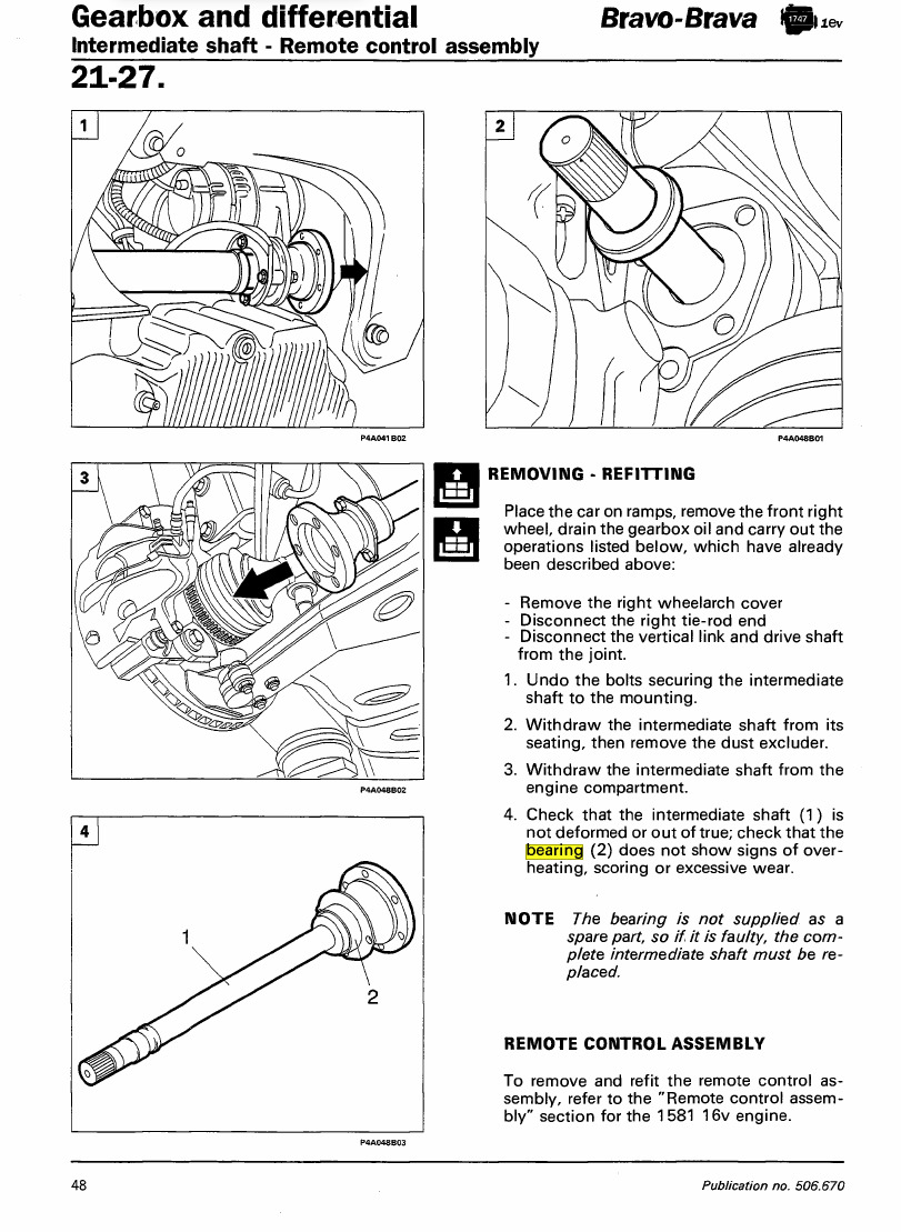

Hi,
I have a with my Bravo HGT 2.0 20V. It's shaking from 0km/h. I determined the reason is worn out intermediate shaft bearing.
Now according to Fiat Service Manual it is impossible to remove bearing. Maybe it's not but i doubt it.
Has anyone removed this bearing? Is it possible?
And also what are dimensions?
Thx
