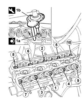

Does anybody know what is the head tightening sequence and the torque please ???? :bang:

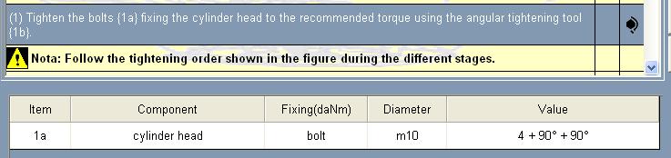

You can judge 90 degrees though Phil, I'm sure I can.
4daNm though- that's 4 slaves at 15 cubits in old units isnt it?
love you guys ))) :worship:
Yes that's correct
4 daNm = 4 decanewton metres = 40Nm = 29.5 lbf ft
