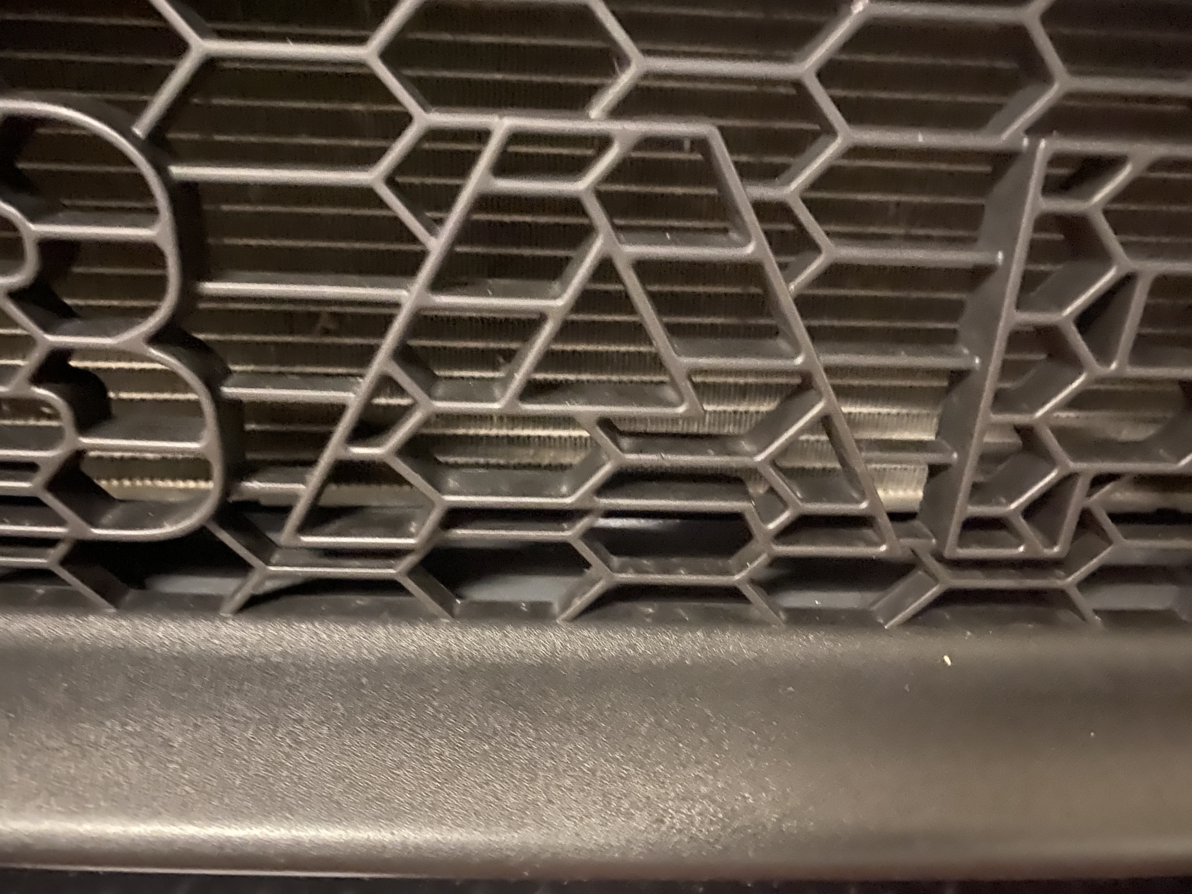

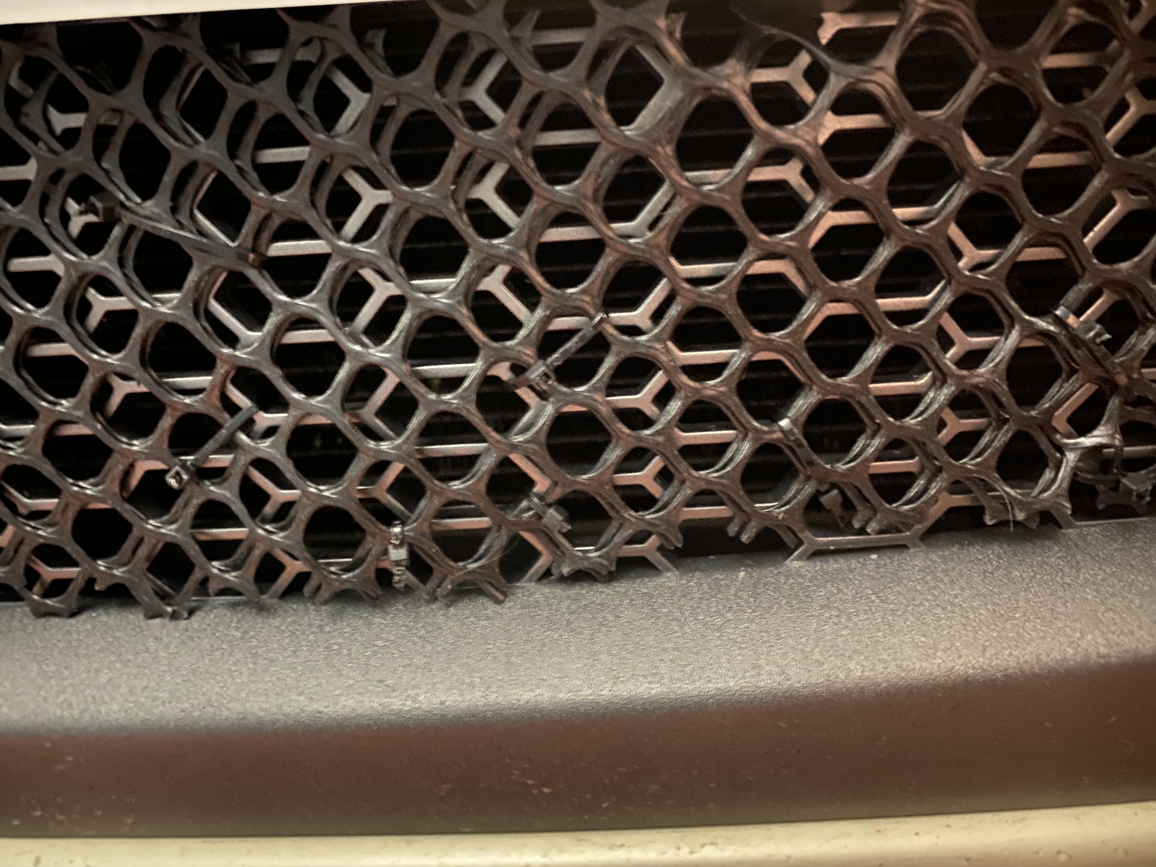

I have had problems with my condenser being damaged by stones going through the very open lower grill in my Abarth Aniversario, I have placed posts prior to this one relating to this, The air conditioning rad is very easy to damage when a stone hits it, this is NOT covered by any warranty. Hence I found on ebay some black plastic chicken mesh, cut it to the same shape sa the lower grill and used small black cable ties to hold it in place. I fitted this 3 weeks ago, in the back of my mind I did have a little worry it may restrict the airflow , but NO! I have just returned from a trip round the Cotswolds with an outside temp of 25 deg, the dashboard temp stayed midway as it should be. When I returned home it was amazing how much debris had been stoped from going through the original holes.. I actually doubled the mesh & fitted it to the front grill, I would have preferred to have placed it behind but this would have meant removing the whole front bumper (too much hassle) Astheticaly unless you look closely no one would notice the modification but the benefits are rely great. Hope this is helpful. Barry

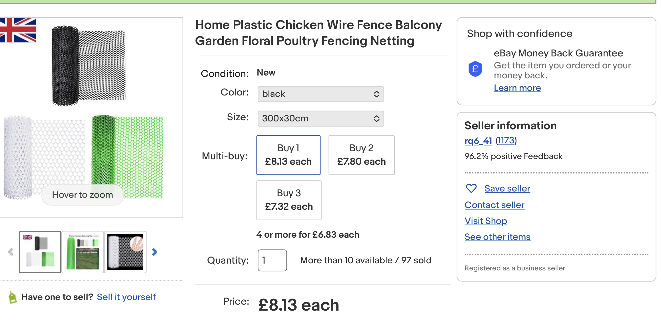

Photo of plastic chicken wire from ebay

No I agree that is much too close & restrictive, if you look at the beginning of my post there is a close up photo, the mesh is soft black plastic, it works 100% I fitted it in the summer when it was over 35 deg. The temp on the dash has stayed exactly where it should be. The one thing is I am not getting any debris hitting the radiator behind it. The original standard grill is definitely to ventilated, it proves it as when I took the car in to an Abarth agent to complain the gas had leaked from the air conditioning, straight away they said “oh we get that happen all the time, the stones go through the open grill at the front & piercing the condenser & sorry its not under your warranty“
