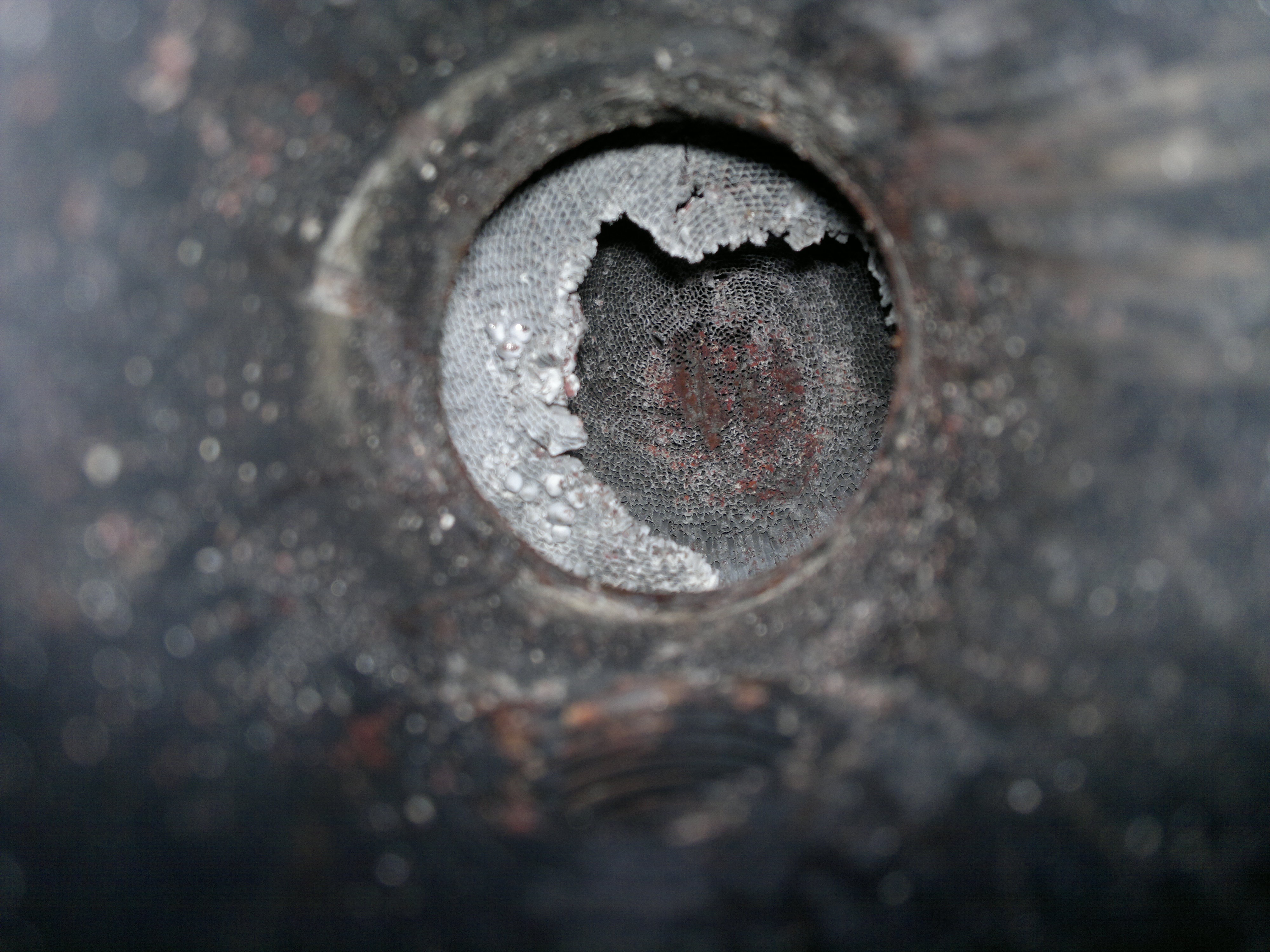

lambdas last from around 50,000 to 110,000 miles but if your changing your cat you should really change both lambdas too. I suspect the reason my cat blew itself to pieces was because of a dodgy lambda. i think it was incorrectly tracing and therefore sending incorrect fuel level signals to the ECU. the ECU would then turn the fuel up and it would run rich. excess/unburnt hydrocarbons in a cat will kill it. ill see if i can dig out the picture of my damaged monolith.

EDIT:- my cat damage looking up from the 'downpipe' you can just see the post cat lambda threads in the pipe out of focus at the bottom of the picture.
