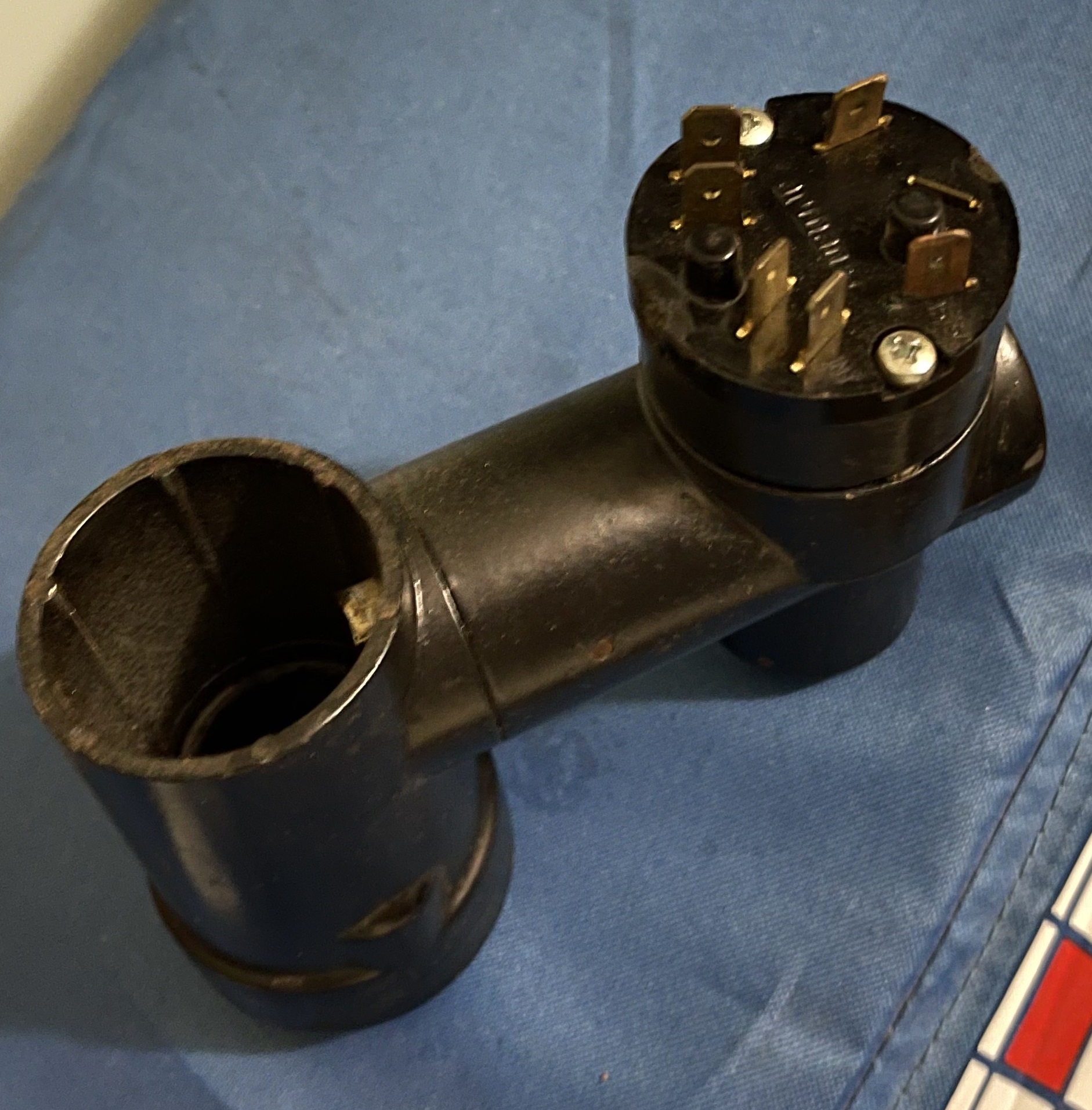

If you're confident that it is an electrical issue and the problem is the barrel:
The barrel attached to the steering column works much the same way, assuming you don't have a solenoid starter. You can check to see if the wires that lead to the back are secured and not loose. You may or may not have a set of Philips head screws (see attached photo)- if you do, tightening them might help. Also, there may be a cover over the leads to prevent access to these wires and theft of the car. If that's the case, you might need to remove the steering wheel to lift off the entire barrel/steering lock assembly.
