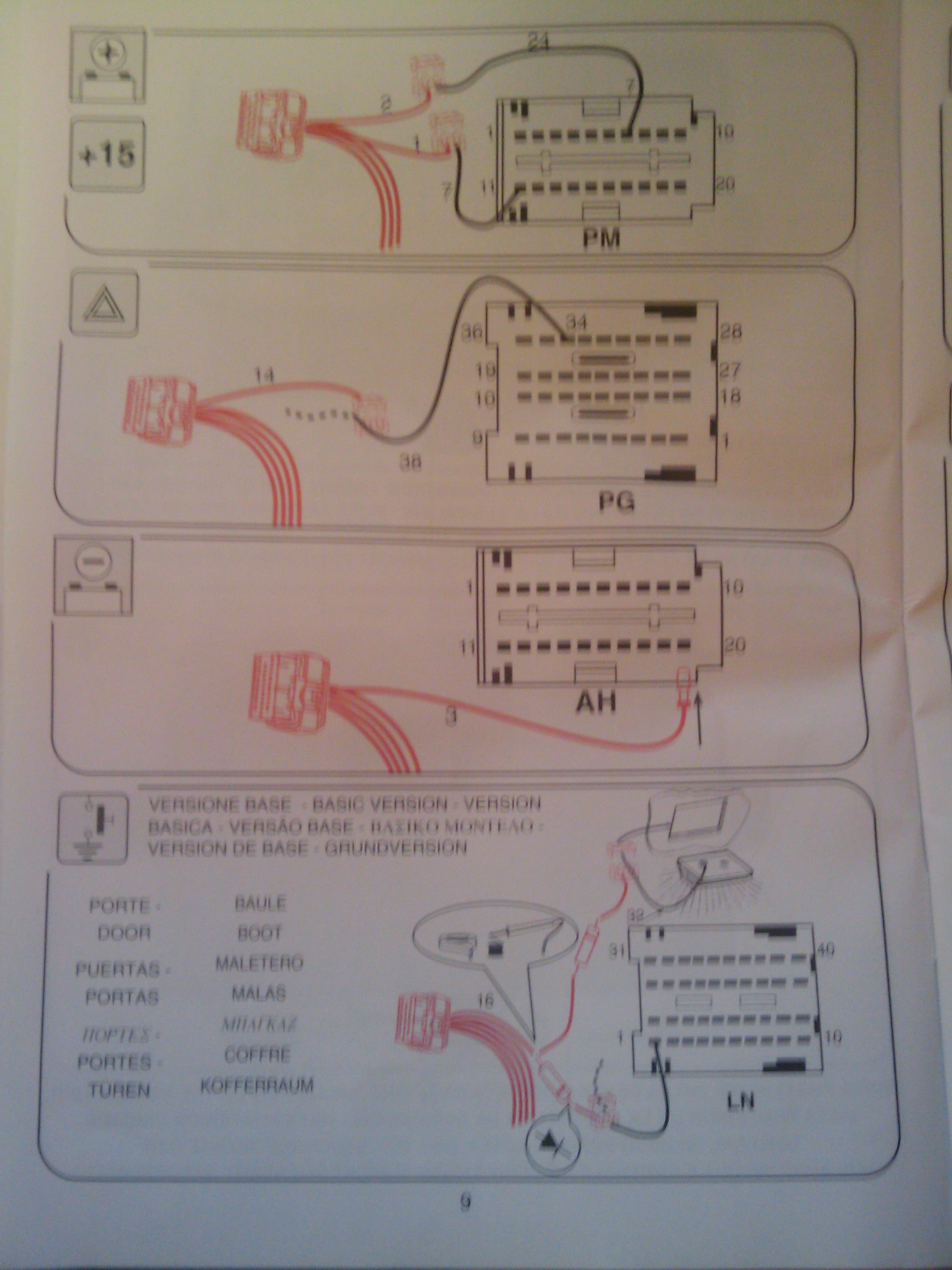

I lower the fusebox/body computer as makes getting to the rear connectors easier. If your not confident you can at least mount the ultrasonics & LED then leave all wires at fusebox for connection by electrician as this will save them time and you money
