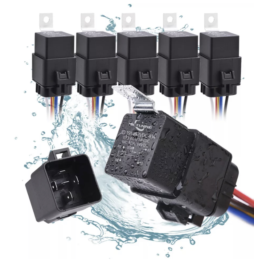

There is a large relay separate from everything else somewhere behinds the passenger side headlight, in front of the battery. I’ve attached a picture so you can have a rough idea what you’re looking for.
These are “skirted” relays that are supposed to be waterproof, when mounted up the right way the skirt around the bottom should stop water getting in, but if they’re ever removed and not put back and end up hanging upside down then the skirt acts as a handy little beaker collecting and filling the relay up with water. (What you’re looking for should be black)
Once you find the relay you can remove it, which will stop the light being on permanently, then you can look at getting a replacement I recommend eBay and search for what ever part number is on the relay.
I’m also quite lucky where I live in Norfolk we have a wholesalers who specialise in car electronics, if you have something like that near you they may be able to recommend an alternative replacement.
Fiat did a bit of a hack job on the Evo cornering lights, just threw in a couple of totally inappropriate relays to add the functionality but I’m not even sure they’re protected by any sort of fuse, as I was never able to find the fuse that went to the lights themselves, only the fuse on the switching side of the relay. To give you some idea of how much of a hack this was the relay is actually from the radiator fan of an Leyland daf van
Hopefully that’s not too technical for you, find the black relay, remove it. Then try and find a replacement.
