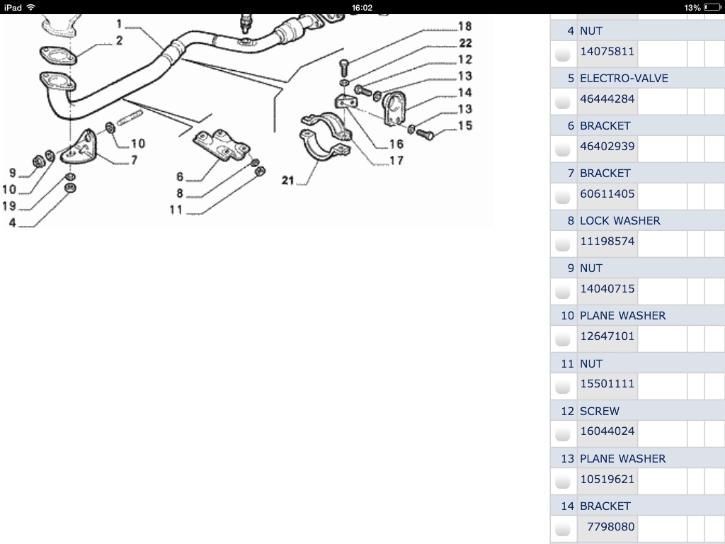

My exhaust keeps blowing from the join between the manifold and down pipe, been back to the exhaust place a couple of times and they keep blaming the engine moving. Went to a garage and asked them to check the engine movement/engine mounts and they said no issues!
So decided to take a look myself!
Bracket number 7 is missing and there was no bolt on bracket 14. I've attached an eper screenshot so you can see what I mean.
Also the rubber center on bracket 14 can be pushed out, is that an issue?

Also any ideas where I might be able to get bracket 7 from?
