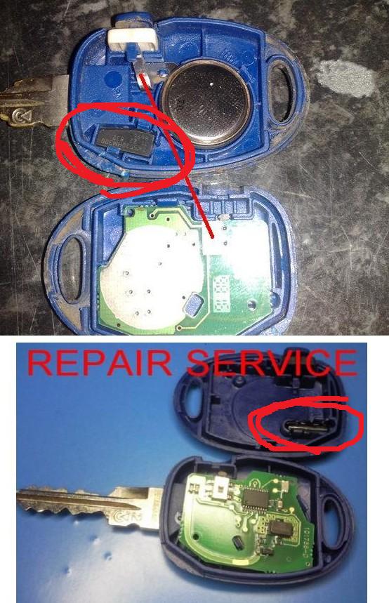

This is a picture of the immobiliser chips inside the keys; Ignore the PCB (printed circuit board) that is just the remote central locking and a utterly seperate system. The key's chip at the top is from a Mk2 1998-2001 Bravo it is a black flat and almost rectangular a more modern style. At the bottom is the Mk1 1995-1998 immobiliser chip and it is brown shaped like a capsule or pill.
I can say my immobiliser turns off much much quicker since i had my original pill style chip copied to the more modern black rectangular style chip.
Sorry for the long post hope it makes sense and good luck (y)
