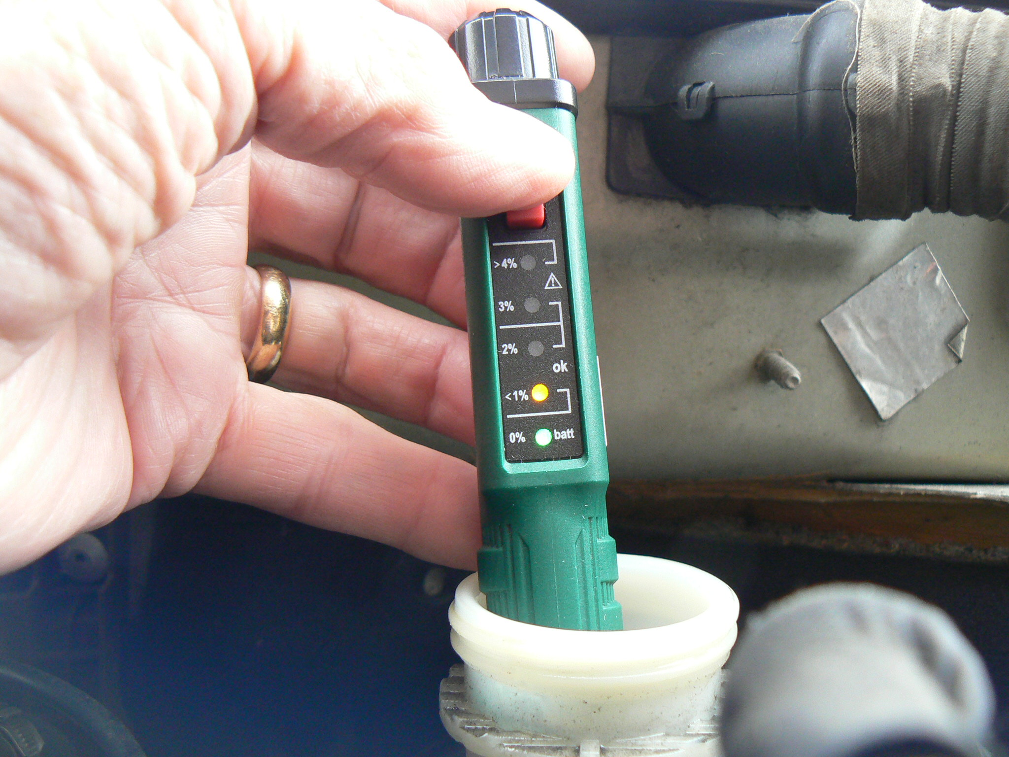

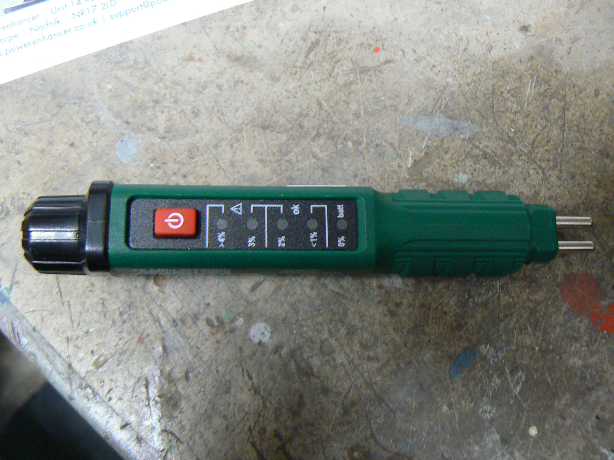

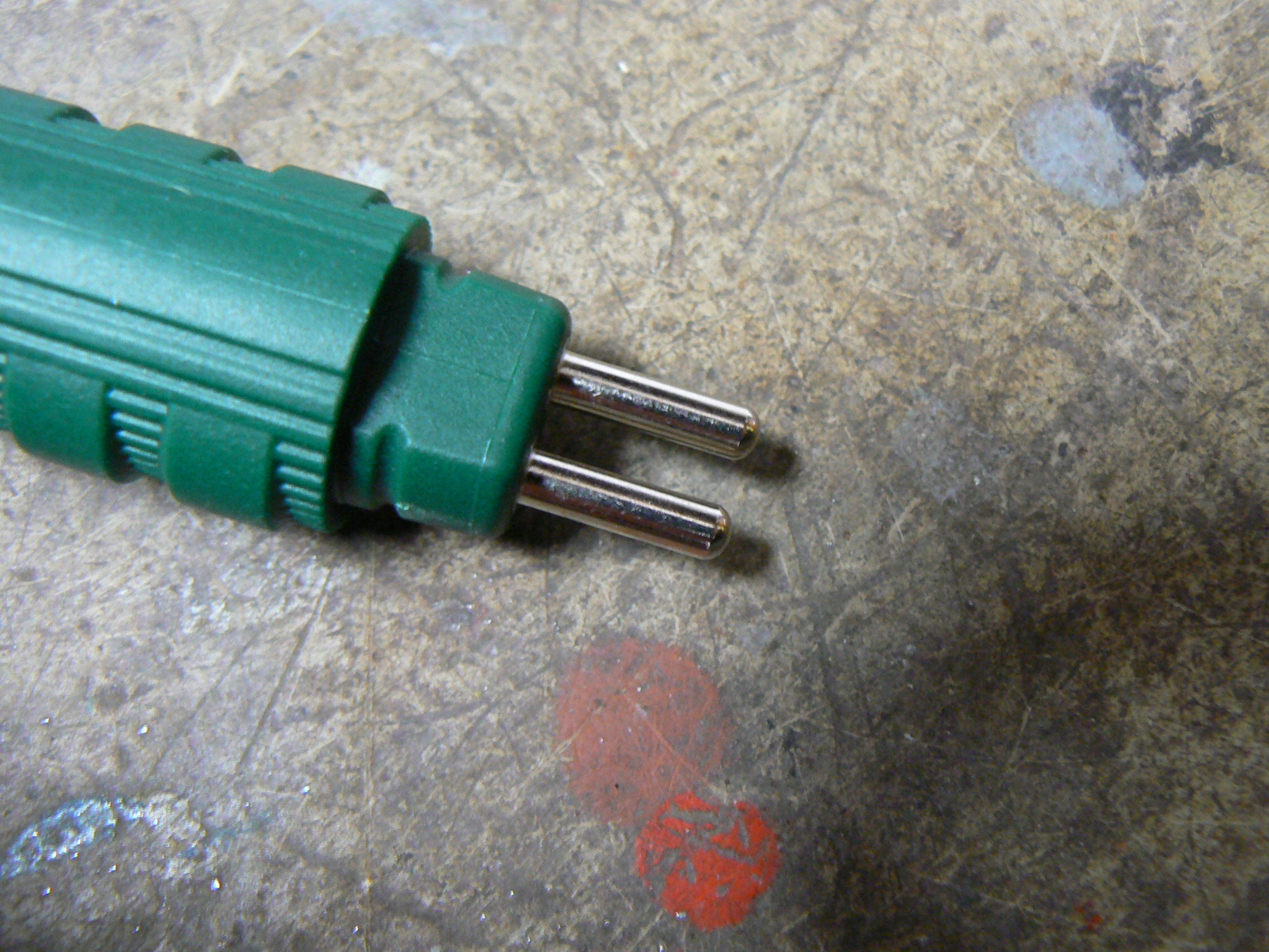

The resistive tool:

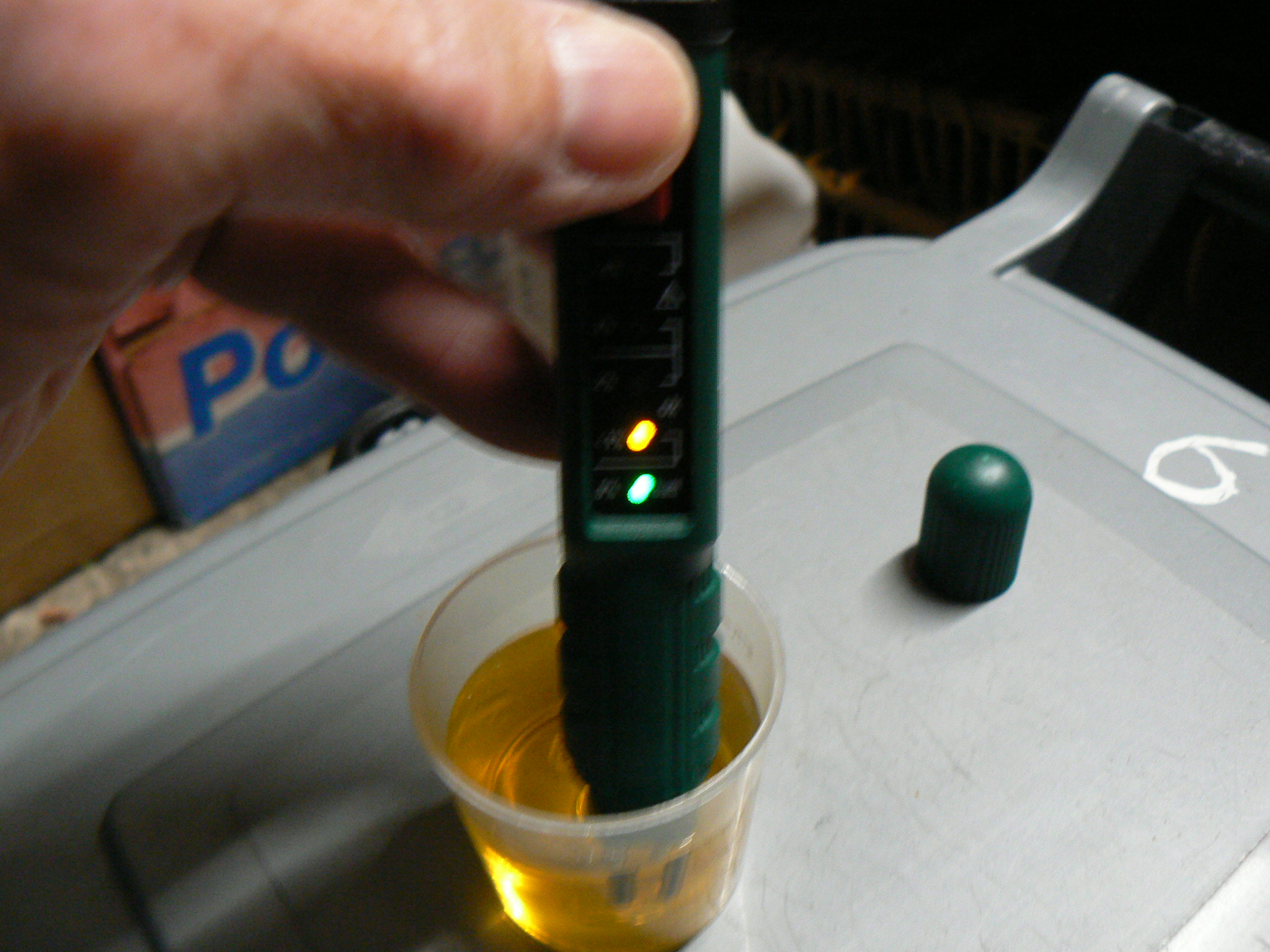

Takes a triple A battery and is operated by dunking it's probes:
into the fluid and pressing the red button on the handle:
whereupon a series of lights illuminate against the scale indicating the percentage of water in the sample.
Having only bought it this week I haven't actually tried it yet but it seems very simple to operate. My intention is to check with both the older "boiling point tool and the new resistive one and keep a record of results which I'll compare after I've done checks on several of the family cars. Then we'll be able to see how accurate and reliable the new tool is? Bearing in mind that the different specs of fluid exist I'm interested to see the new tool has DOT4 printed on it. I believe it probably won't be so accurate if used on DOT3 or DOT 5.1 and maybe a little less reliable on DOT4 plus? It's going to be interesting to see.

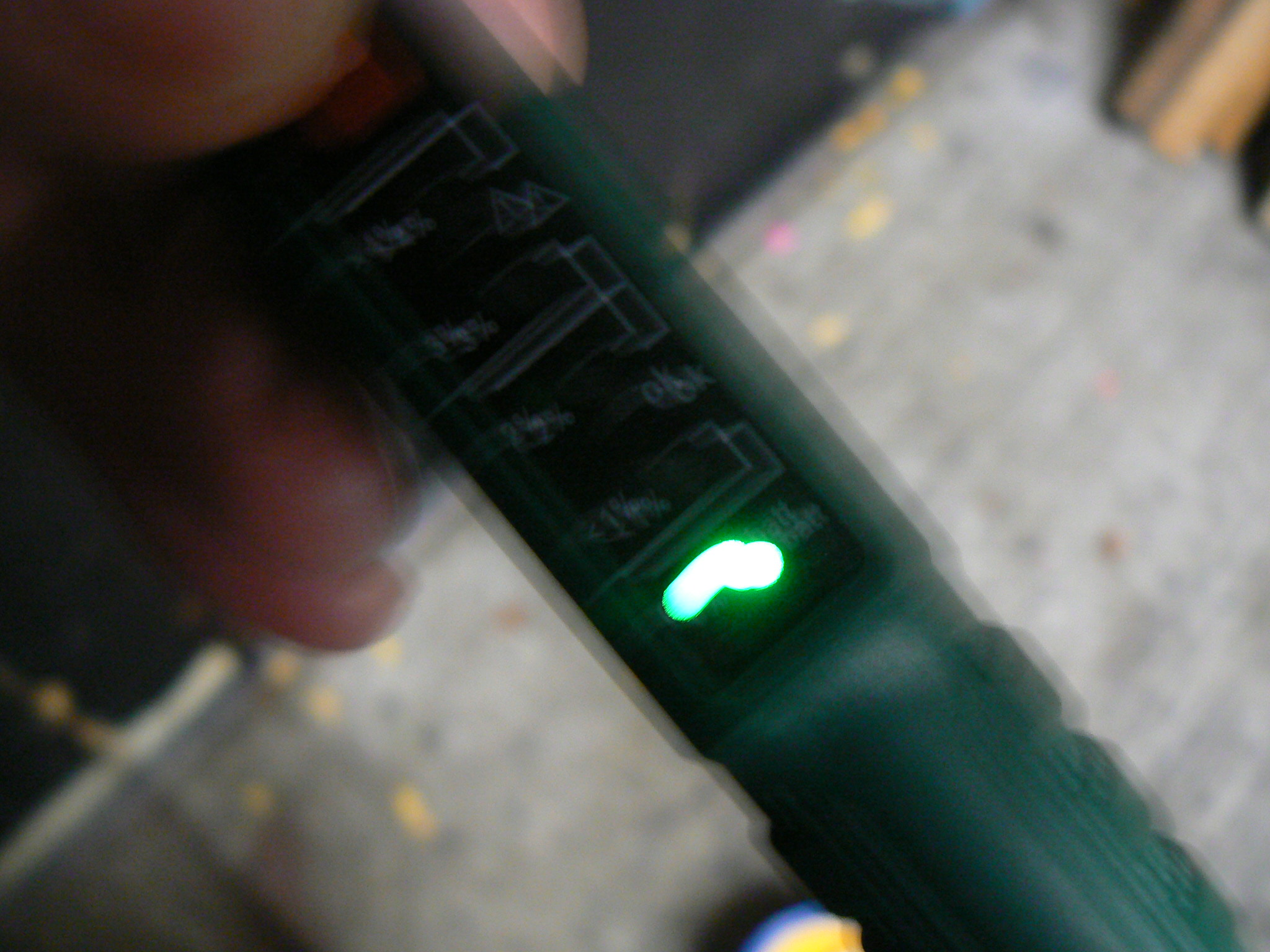

Ok, just finished "playing" in the garage and I really enjoyed doing that and I'm now nicely destressed!
I found the bottle of Napa DOT4 brake fluid and it's still two thirds full with it's top nice and tightly screwed down I poured some out into the wee container supplied with the Liquid Levers kit (see pictures in my original post at the top of the page) and tried the restive (Lidl Parkside brand) first. To make it work you press the red button and it briefly illuminates all the LEDs then settles back to just illuminating the green bottom "battery ok" LED:

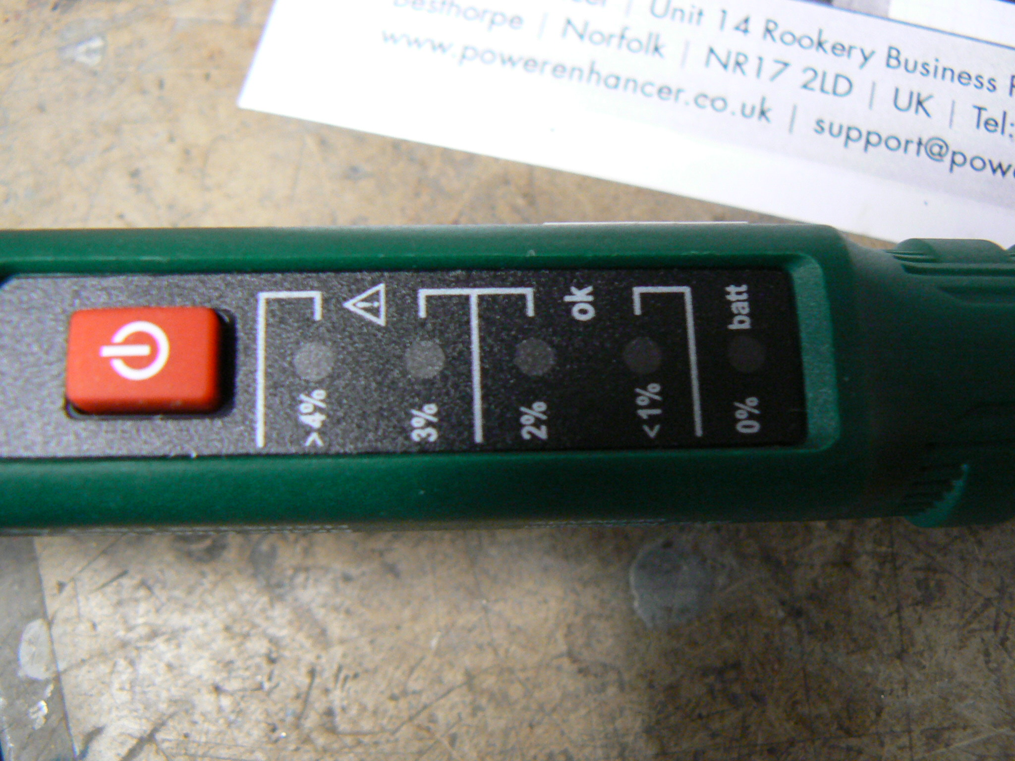

This means it's "on" and ready to go (It'll "auto off" after a wee while if you don't use it or you can switch it off by pressing the red button again). So, with it now on, you immerse the probes in the fluid and right away it illuminated the first light only:
Which the scale lists as ok (below 1% water content). Two LEDs lit would indicate 2%, 3 gives 3% and 4 gives 4% Above 2 and you need to think about changing.

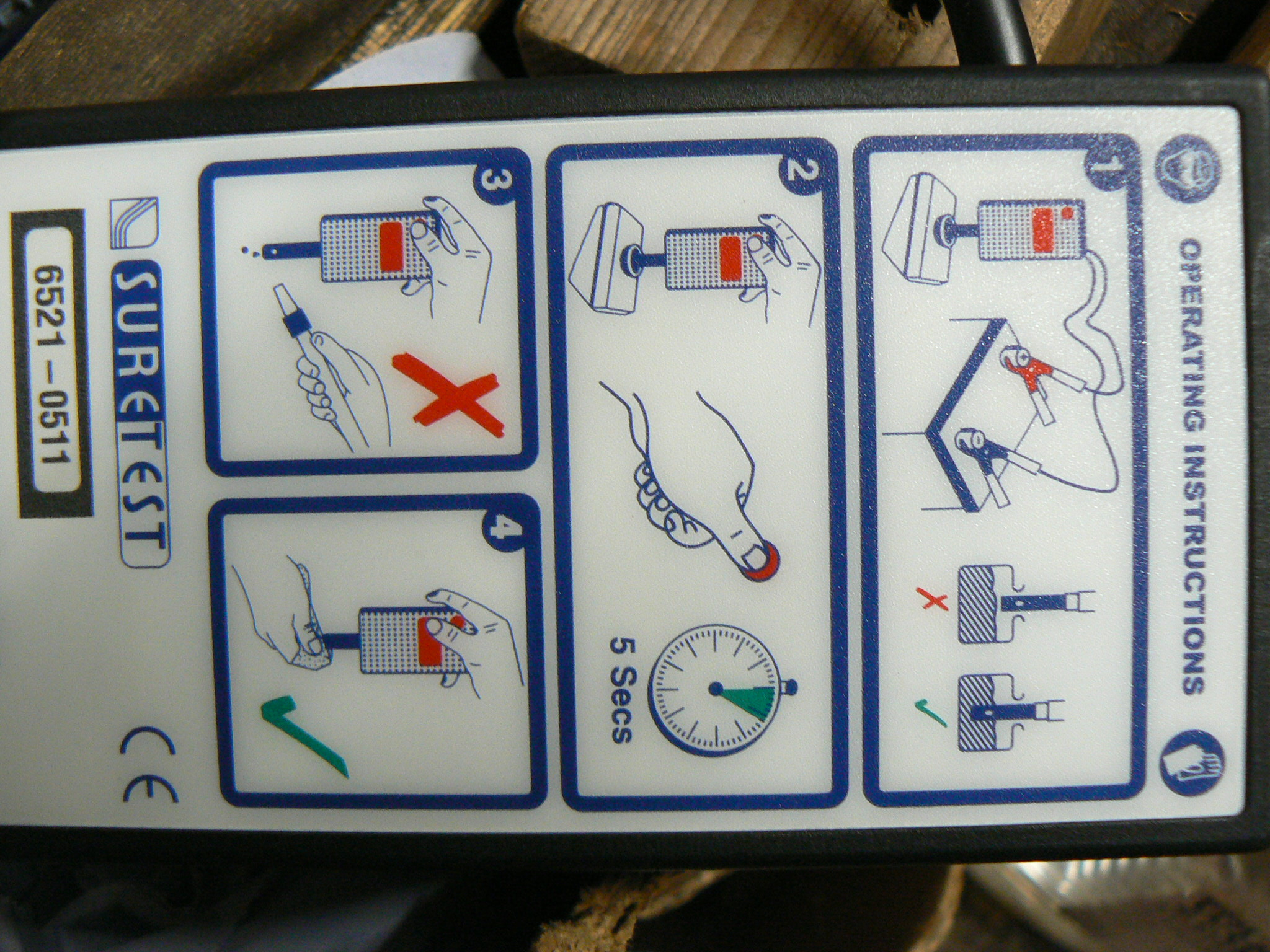

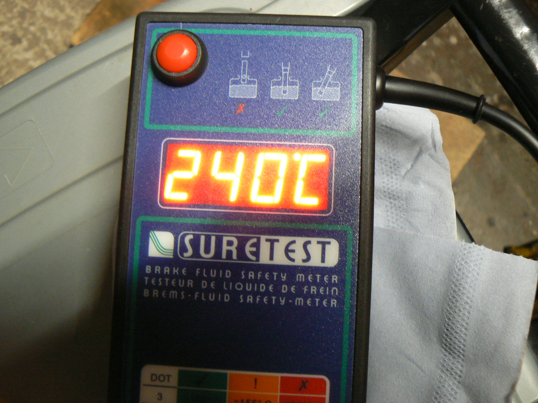

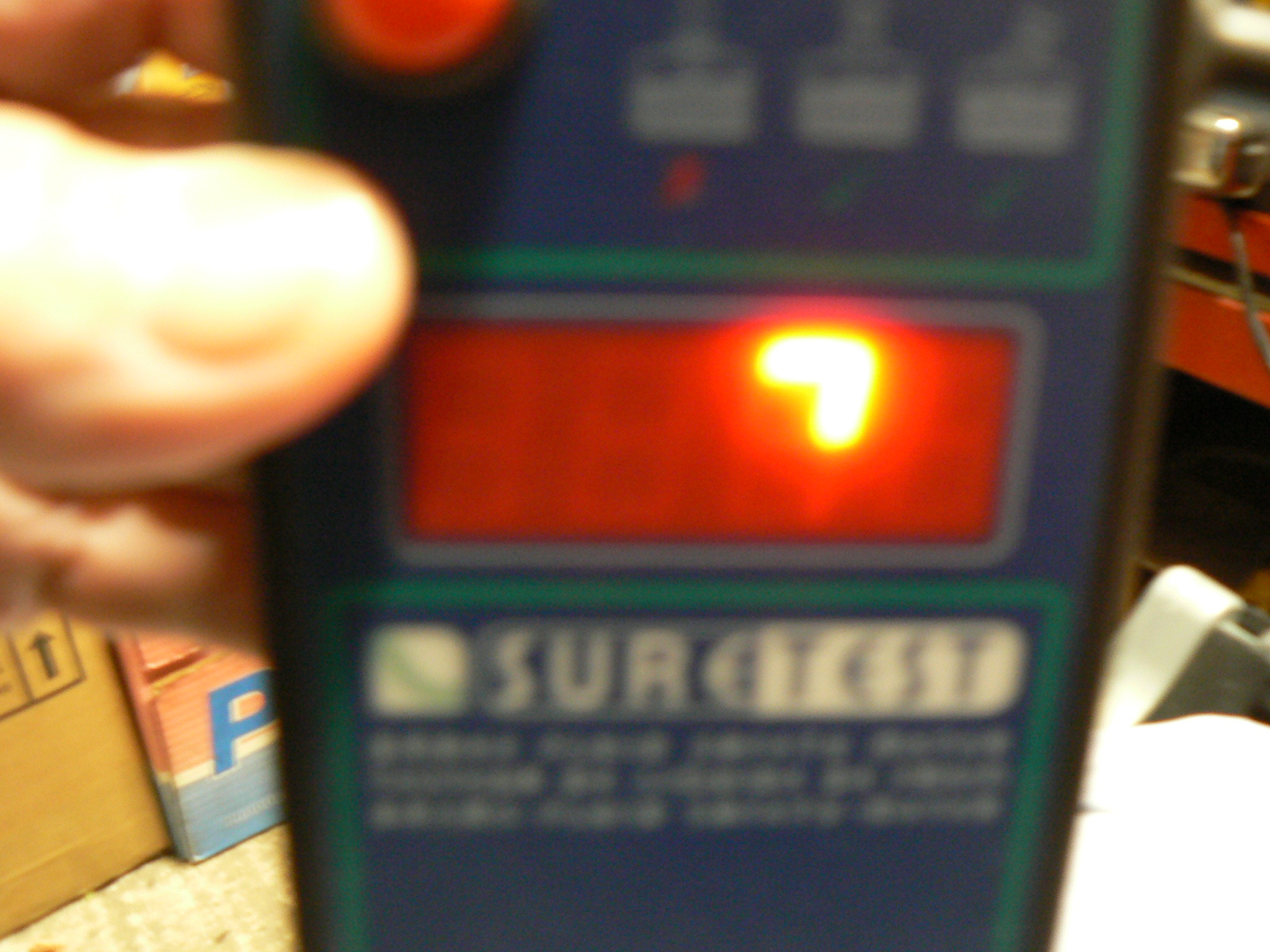

Then I repeated the test with the Liquid Levers boiling point tester. which has a very handy "how to" guide on the back:
so you really can't go wrong with this simple to use tester. The most important thing to remember is not to press the actuator (red) button when the tip is not immersed in fluid or you risk frying the heating element!

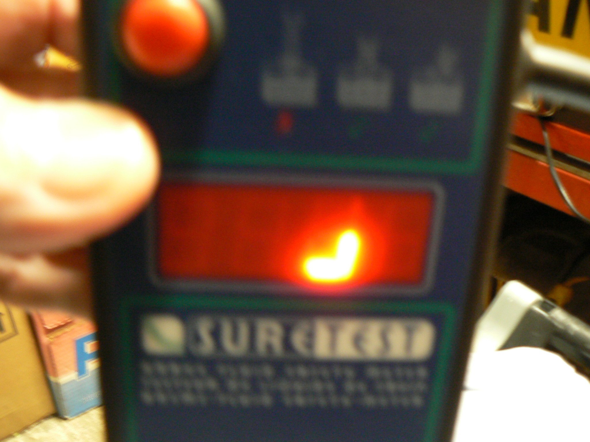

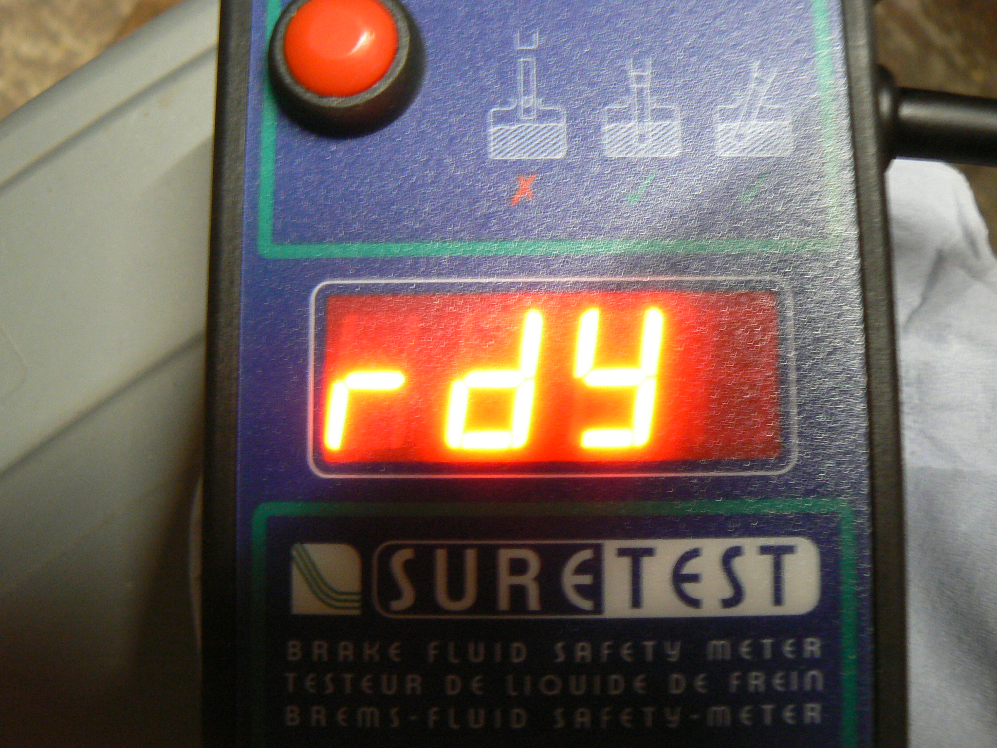

First you connect the power leads to the battery - this turns it on, there's no switch - I don't think they are "protected" so be careful to connect Pos to Pos and Neg to Neg. Having done that the tool tells you it's ready to go:
Next you dunk the probe in and out of the fluid a few times to get a representative fluid sample into it and to stabilize the sensor temperature. Then, making sure the probe is immersed above the level of the bleed holes you press the big red button for a few seconds. The machine is operating - heating the element - when the display starts displaying random shapes:

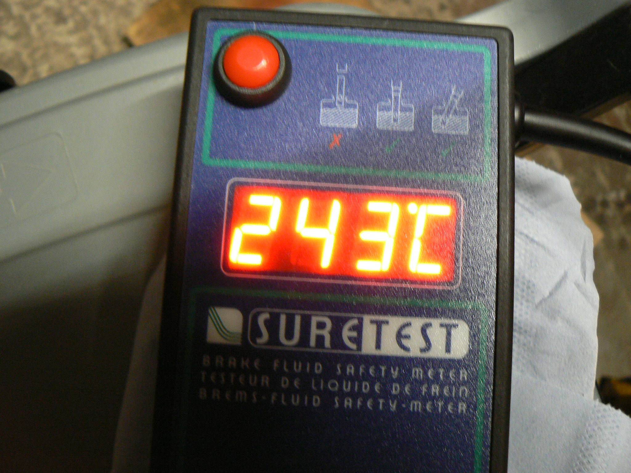

You can release the "big red button" once it starts to do this. the random flashing slows down and when it's "happy" it displays a steady reading:
The manufacturer recommends taking at least two readings for maximum accuracy so I usually take 3 and find the first reading is often marginally low. In this case the second and third attempts produced:
and I find this difference representative of other readings I've taken so not really significant.

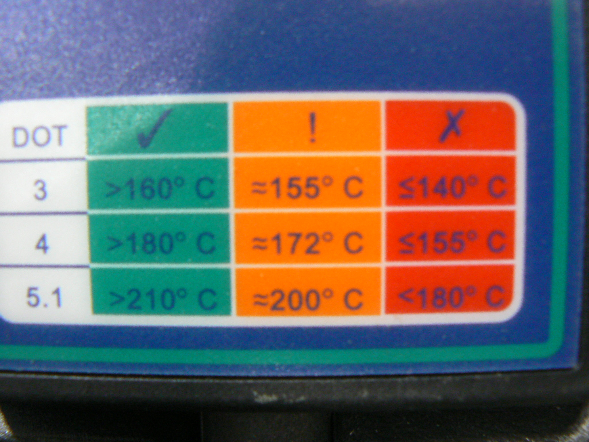

The minimum reading for DOT4 is 155 degrees C so this fluid is in excellent usable condition - Visually it looks nice and clear too.
So far the below 1% and the boiling point reading of 243C seems to be consistent - great! Just for reference the max reading the tool can give is quoted to be 272C but I've never seen it getting near that.

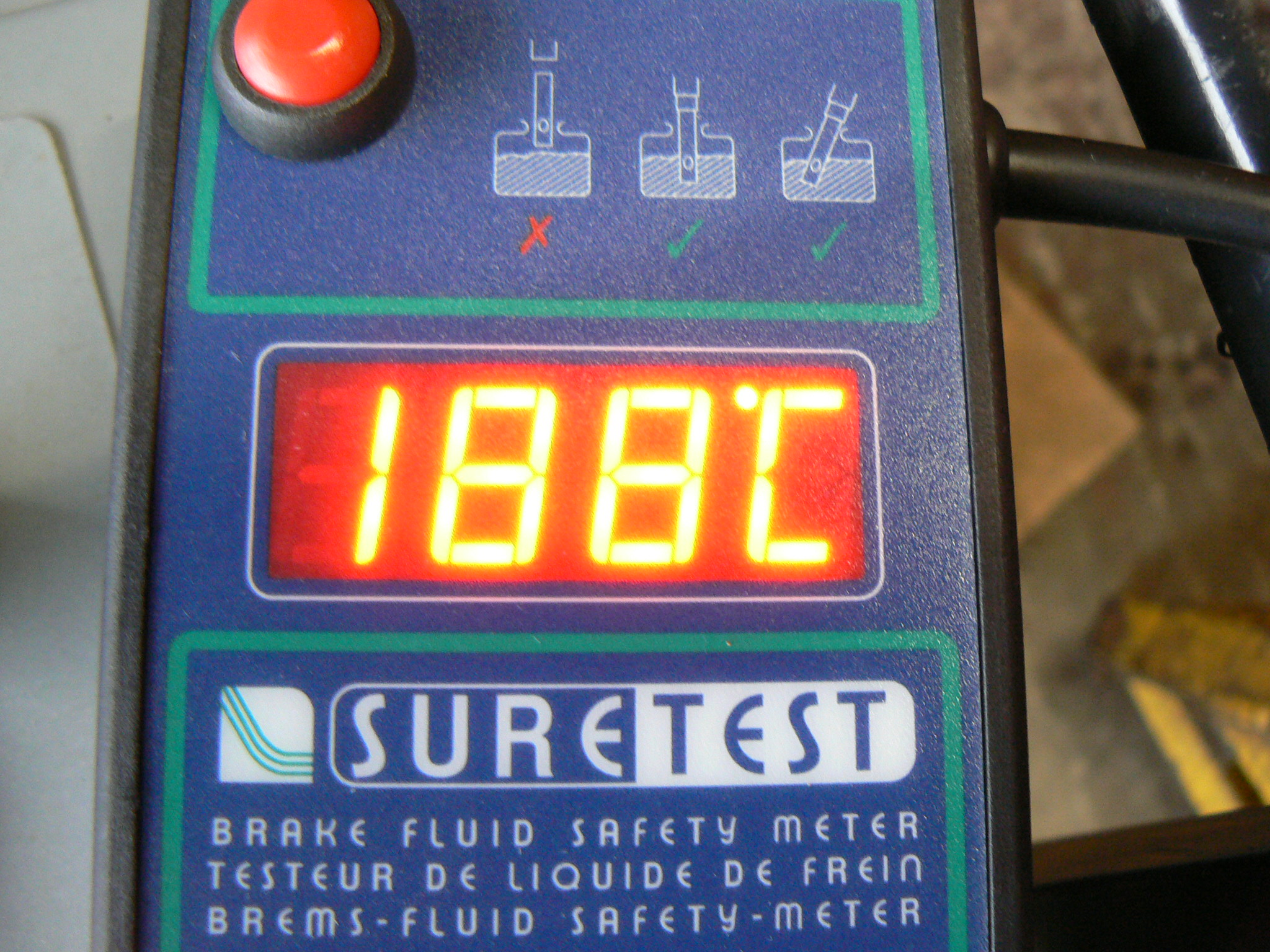

So, emboldened by this outcome, and as it's not raining yet, even the slight drizzle has stopped, I thought I'd check the cars.

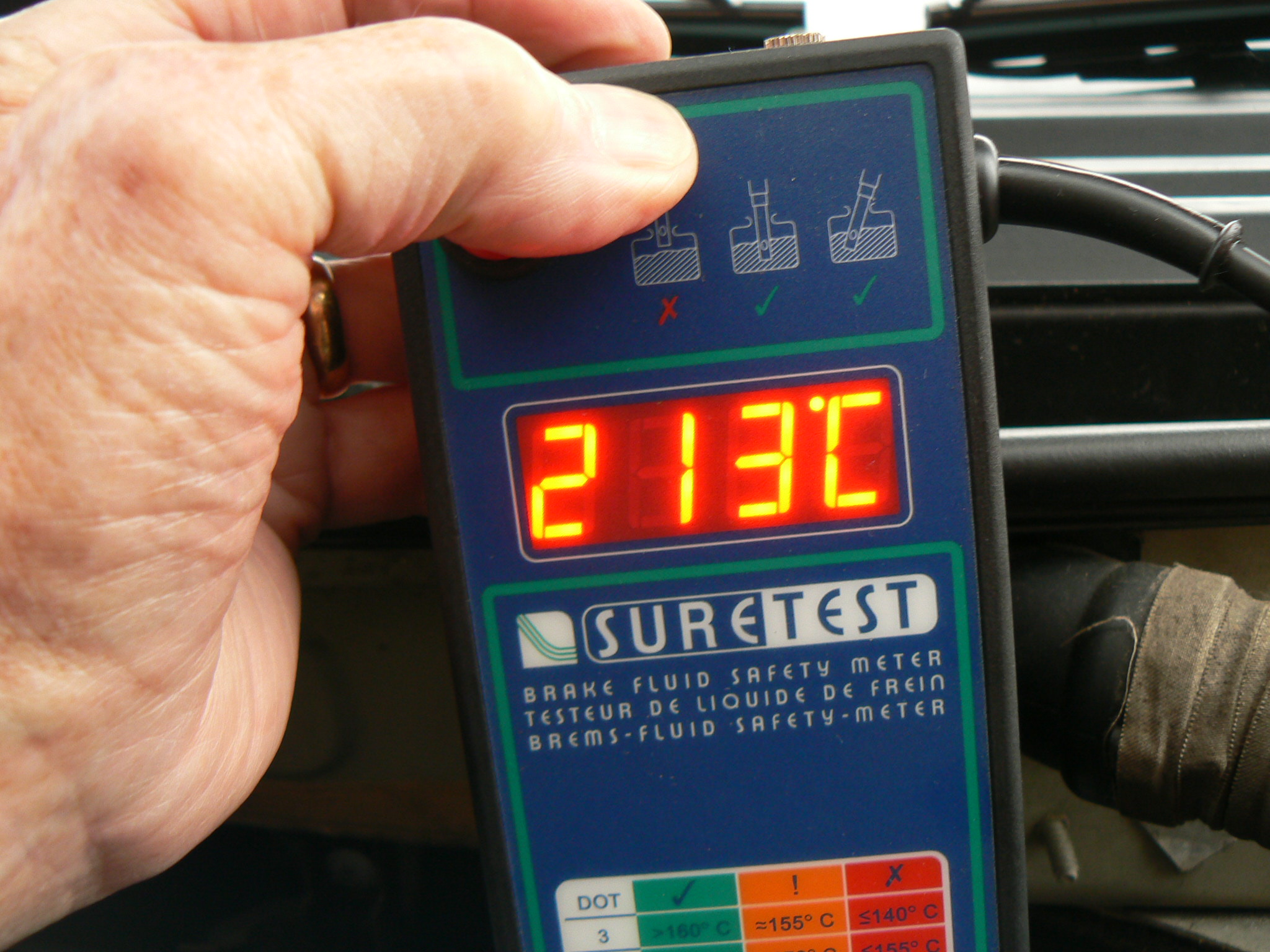

Becky the Panda first. She was bled out with the same Napa fluid I've just been testing around Easter time? when the rear brake cylinders were renewed. The fronts were not bled at that time but the fluid in the reservoir, master cylinder and rear system will all be new at that time. Possibly some cross contamination from the old fluid in the front may have occurred so the outcome will be interesting (note to self, must bleed the calipers before long.)
Very pleasing to see the resistive tester returned a less than 1% result with the boiling point tester showing 213C:
I think this is probably the expected comparative result? 213 degrees is still a lot above the 155 degrees boiling point at which renewal is recommended for this DOT4 fluid so I'm happy with this outcome both in terms of how the fluid is aging and in terms of the expected reading on the resistive tester.
Then I thought, Ok, go for it boy, let's check Twinkle (the Ibiza). Her fluid was not changed by me. Back around March of this year I let our local VAG indy do a cam belt on her and service the aircon. So while she was in I asked for the brake fluid to be flushed through with new fluid too. so it's probably not NAPA fluid but I know it's DOT4 because I asked. Which disappointed me slightly because it should have been DOT4 plus, but it'll be OK and I'll bleed it through with the "proper" stuff next big service. The good thing, for the purposes of this investigation, is that I know it's DOT4 in the system right now.
I won't go through it "blow by blow" because the procedure is the same as for Becky. The results were:
but the resistive tester still showed just one LED lit - so less than 1% water.
I'm slightly suspicious of this resistive reading. The lowest acceptable reading for DOT4 is 155C and for DOT4 Plus (or Super some call it) is 180C so at 188C I'd have thought it would be on the cusp of illuminating the second LED? But then this resistive tester is calibrated for DOT4 so it's presumably going to fail it at around a reading of 155C. which I'm guessing will be the third LED (of the four possible indicating LEDs) what I don't know is what temperatures the various LEDs illuminate at.
Anyway, interesting results? Looks like the fluid in the bottle is bearing up well and can be safely used for top ups. Becky, who had her fluid renewed as I detailed above so I know it's been thoroughly flushed through the reservoir, master cyl and rear system is showing results you would expect. However I'm a wee bit suspicious as to just how thorough a job the garage did on Twinkle. Even accepting they used DOT4, when it should have been DOT4 plus, I would have expected the readings to have been a wee bit better. Also the fluid is darker looking than Becky's and there is a very small sign of black deposit in the filter insert of the master cylinder reservoir - where you top it up. I'm not so sure they did a very comprehensive flush through so I'll be doing it again myself soon. I want to replace the DOT4 with 4 plus anyway.
By the way, I tested each system and the bottle sample with the resistive tester first just in case the local boiling of the fluid caused by the Liquid Levers tester reduced the water content in the sample. Also I powered it from my large jump start battery which I know is in very good order and showing 12.6 volts open circuit at this time so there could be no variable introduced due to differing voltage levels in the vehicle batteries. Although actually I don't think this is a factor as all it has to do is heat the coil up 'till the sample boils.
