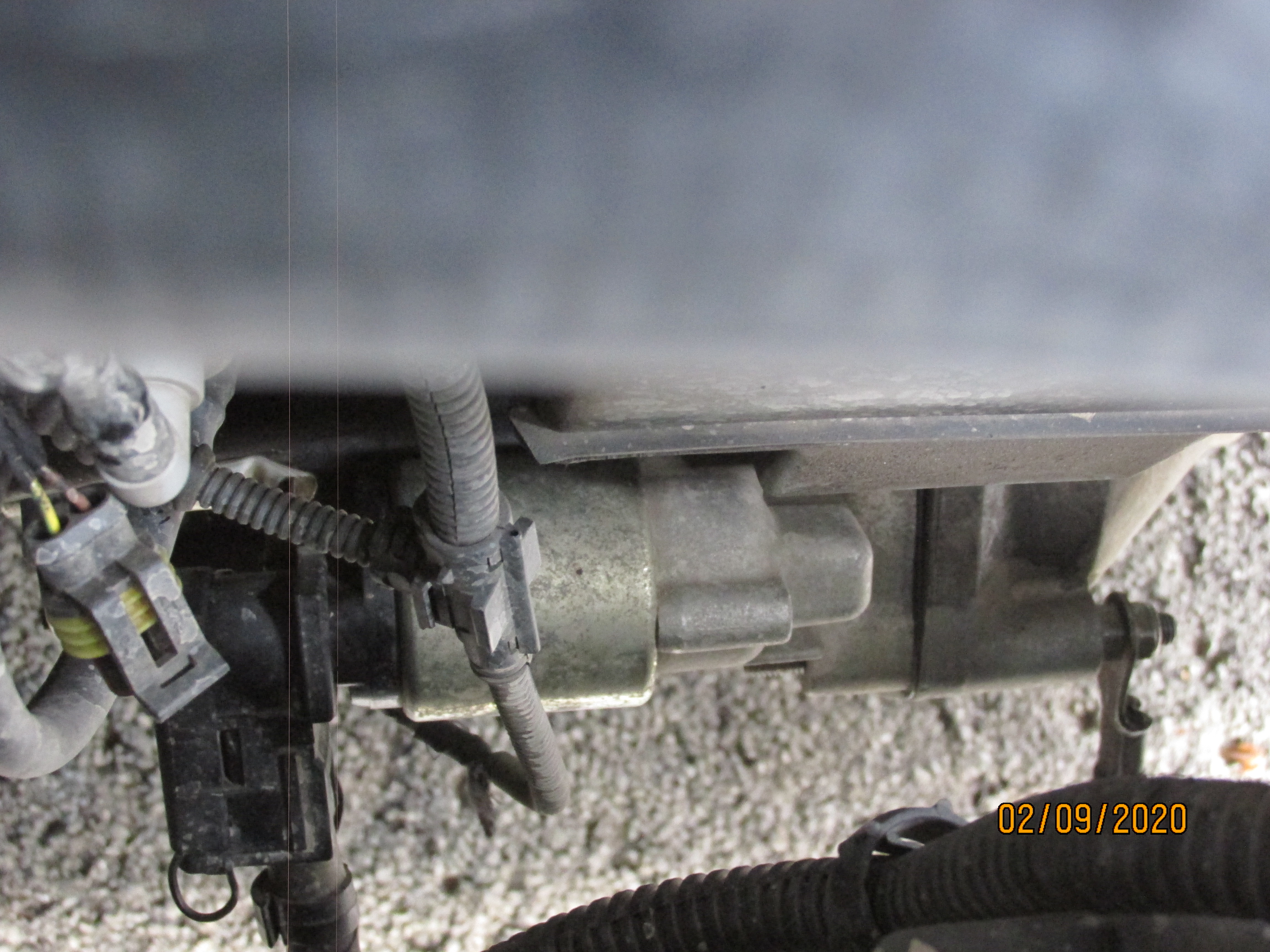

Hi,, just replaced the battery (engine) in my Burstner a class motorhome, built on an 05 2.8jtd and when first switched on after reconnect, I get ABS light and handbrake light. Tried a short drive, never got to 10mph due to no room, and several swith on/off cycles. No change. Any thoughts- this fault was never there before the battery was replaced. Should it be necessary to plug a laptop in, what do I need? IIRC I have fiat ecuscan somewhere, but what about leads? I have an ELM 327 (may not do abs??), or a generic bluetooth OBD reader. I also have a vgcomm which I suppose is useless for fiats. If I need something, what should I get? All help welcome!
