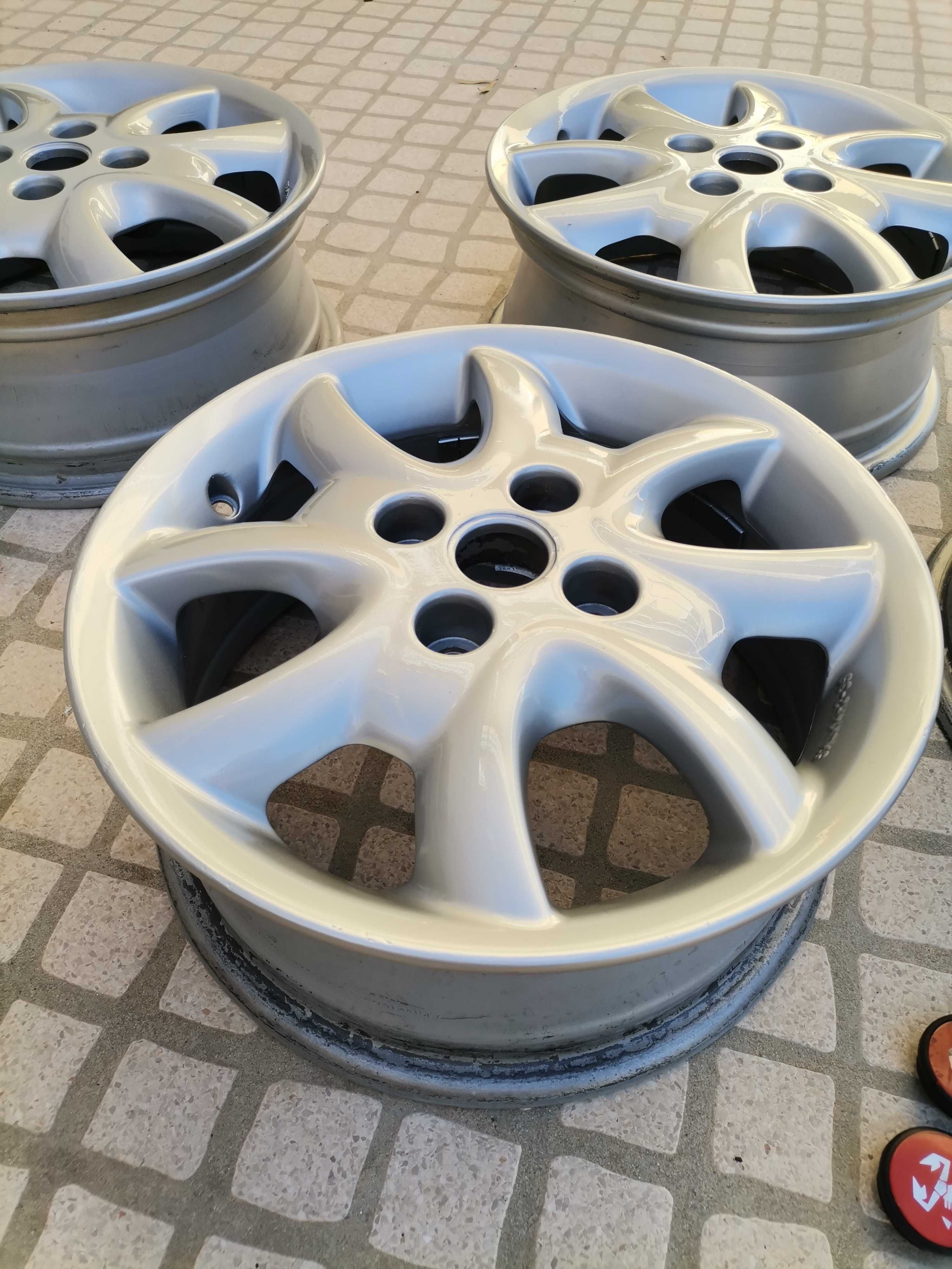

Feel kind of stupid right now .
Was under the impression that it needed 10mm spacers.
To be clear you are talking about these abarth ones . Right?

I'm going for 185/50R14

Yes, he got them off a Schumacher one, went straight on his cinq, the reason I asked for radius is that, although he has uprated brakes, I’m not sure the calipers were bigger!
