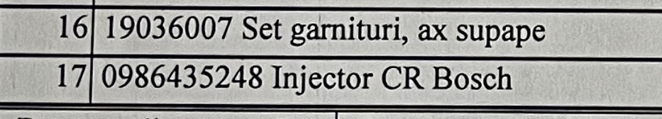

Hi, do you remember what part number injectors you used? Was it 0445110520?
It was done at a service, I only have this id from the invoice (attached). Also 10 characters but different
Is the van still working fine? Have you confirmed that injector codes saved successfully after the programming (in "Parameters" tab)? Also, is your van Euro 5 or Euro 6? Thanks.

Yup, it goes great. 5000km since then. Noticed a slight oil consumption now (250ml/1000km) but unlikely injectors’s fault. I confirmed the ids, checked and rechecked. It’s euro5.
