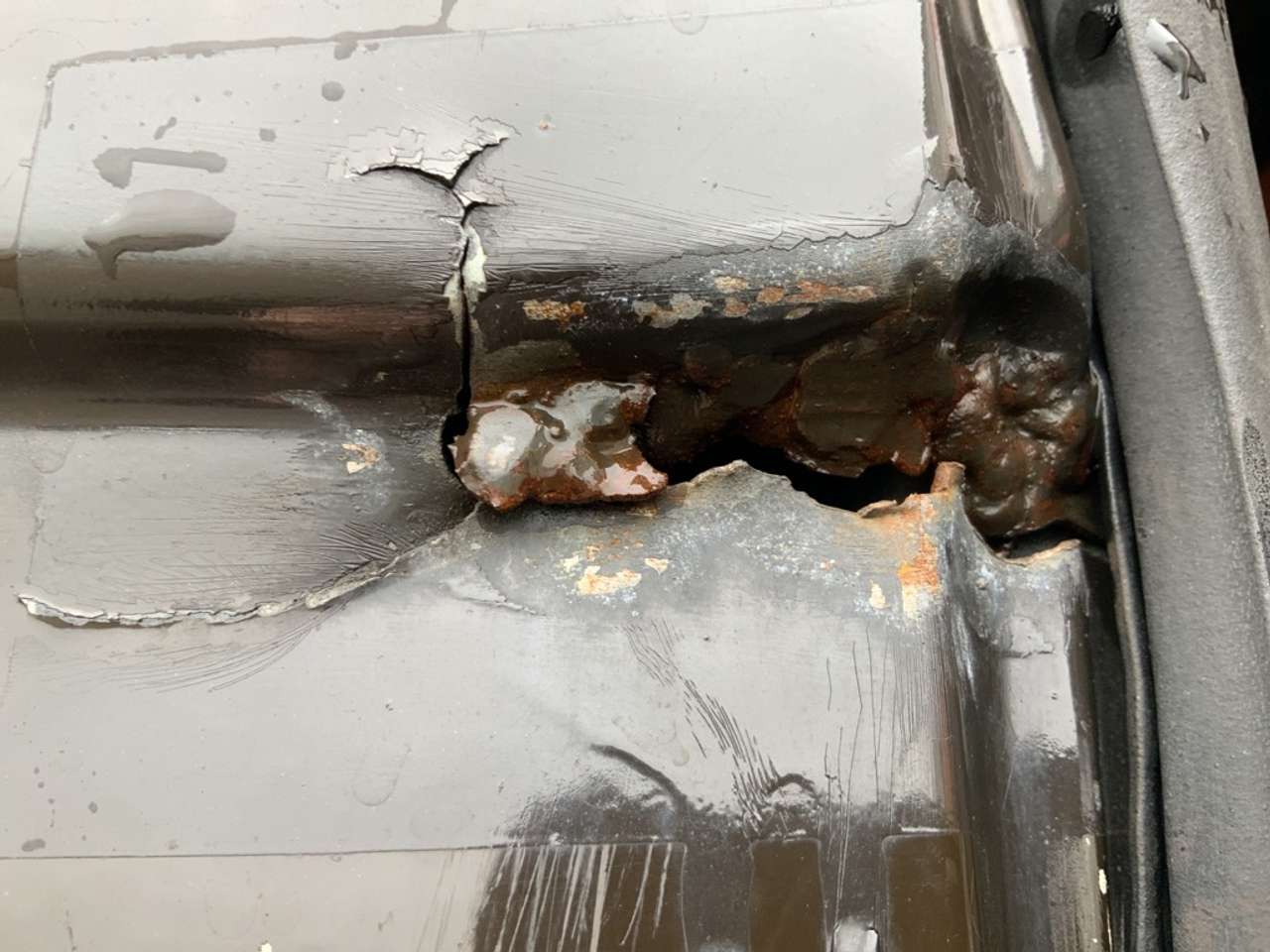

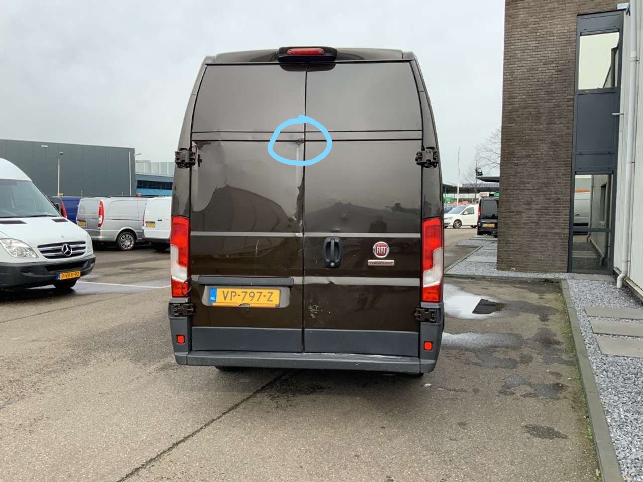

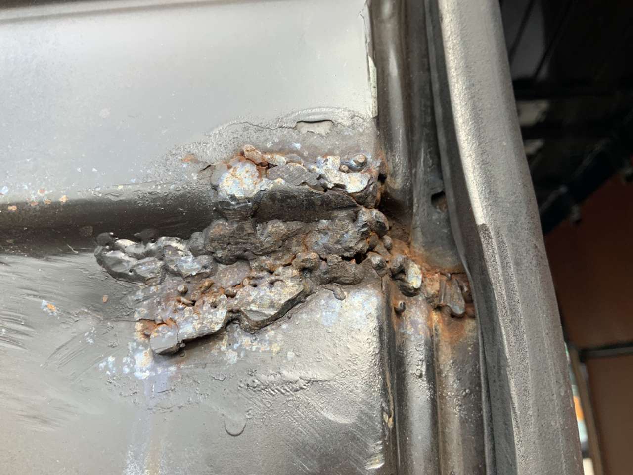

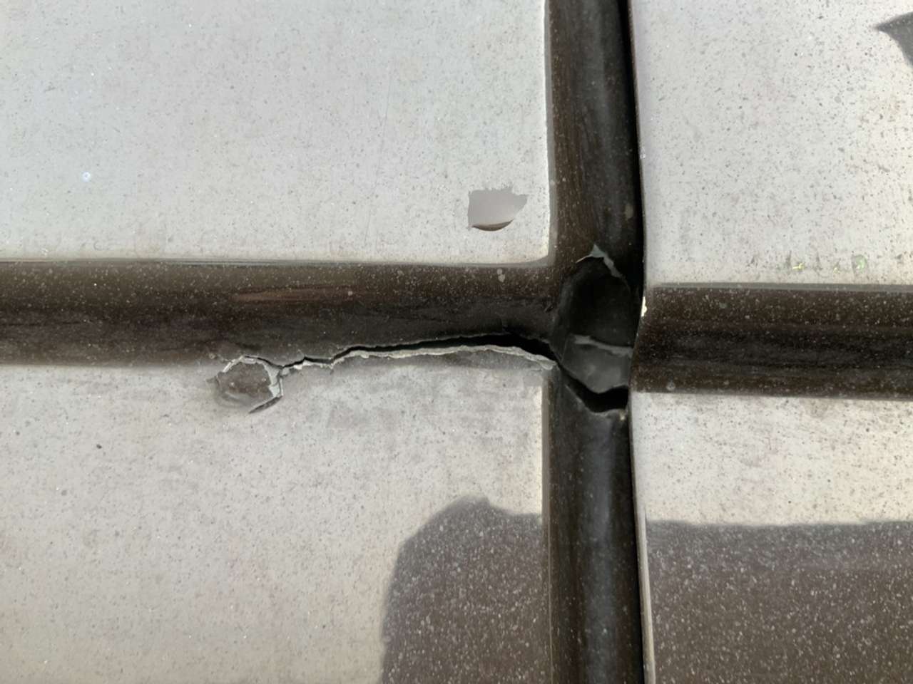

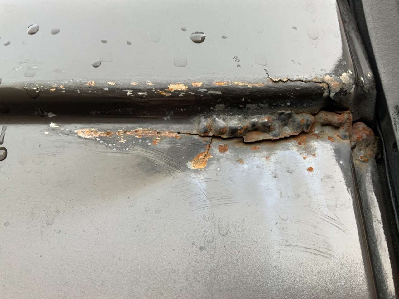

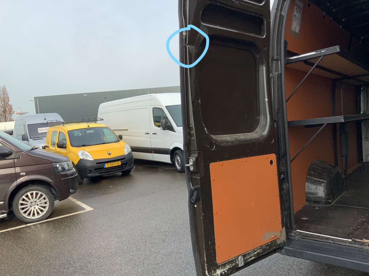

i recently was walking around a batch of 2nd hand UPS vans, all from 2015 and between 100k-200k km milage. Besides the usual dents and bumps i saw that all buses had the same damage on the left rear door. I couldnt find anything on the forum, therefor this post.
i understand these doors have been used a lot as a delivery van. Some have been fixed from the inside but it looks like they cracked again. Is this a known weakness of these high rear doors? Can this be fixed by doing some plate repair work or will it always be a weak part?
