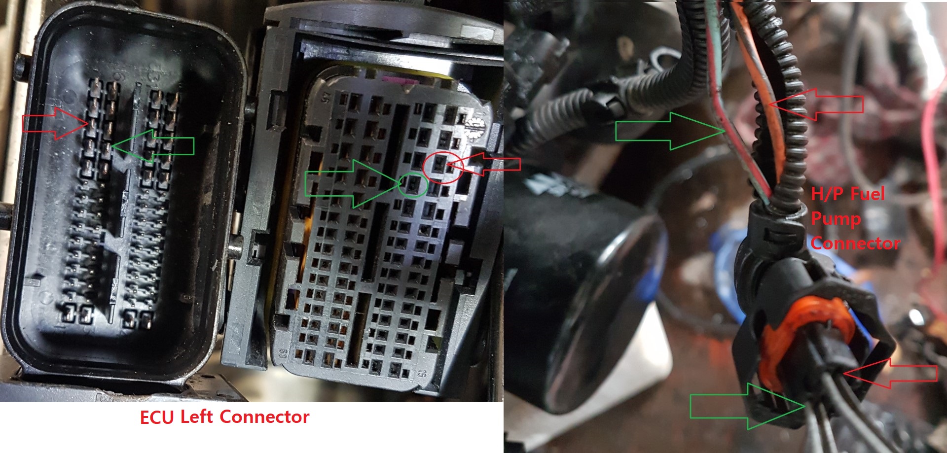

Yes I think your right, becaue when I remove the left block connector from the ECU, the 0.3volts goes to 0 volts. I managed to get a workshop manual on ebay, going to try trace those ECU wires back to high pressure pump and/or relay. These wires plug into the regulator valve on the H/P Pump, getting a reading of 2.5 ohms across the 2 terminals on the regulator valve, suggests the pump is fine.
Look's like the wiring pin out is fine between the H/P Fuel Pump and the ECU. I was not the first to test this as I could see the pin marks in the wiring connector at the ECU end. Going to bring the ECU back to the guys at autokey who setup ECU & ignition a few months ago.
So Pin 3 & 19 on the ECU Left connector are not sending out an voltage to the H/P Pump.

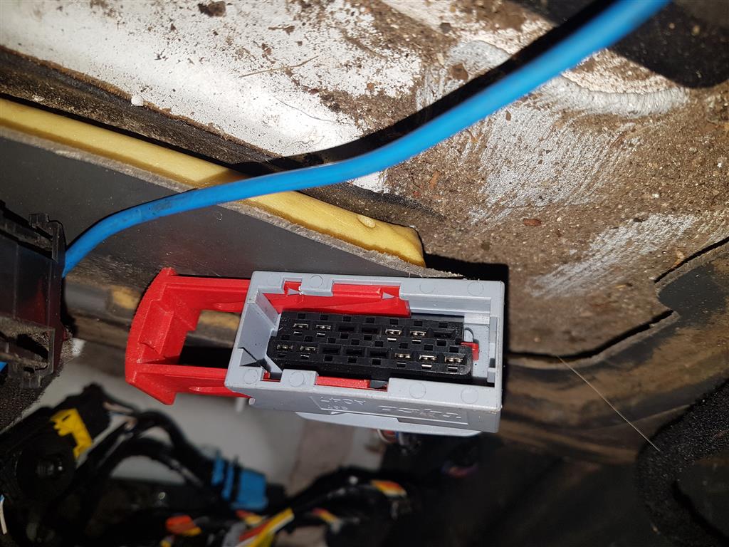

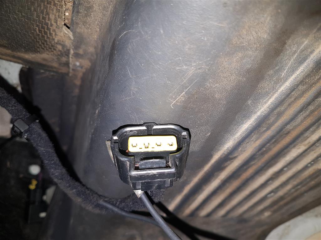

Seems that a fuel relay is missing from the passenger footwell, the grey/red connector. dose anyone know what this Black/Yellow connector plugs into? Same area near passanger foot well / battery box area.

Well.. have just spent the week chasing Alice down the rabbit hole....This item that plugs into the red and grey connector (passenger foot-well) is NOT a Fuel Relay, Its a Door Central locking Relay. This can be verified in the workshop manual. Yes I know, there are 20 of them for sale on eBay All saying Fuel Relay, but has anyone bothered to check? There are 4 types L1 to L4 depending on the number of doors on the van......
