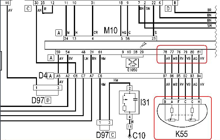

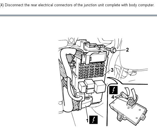

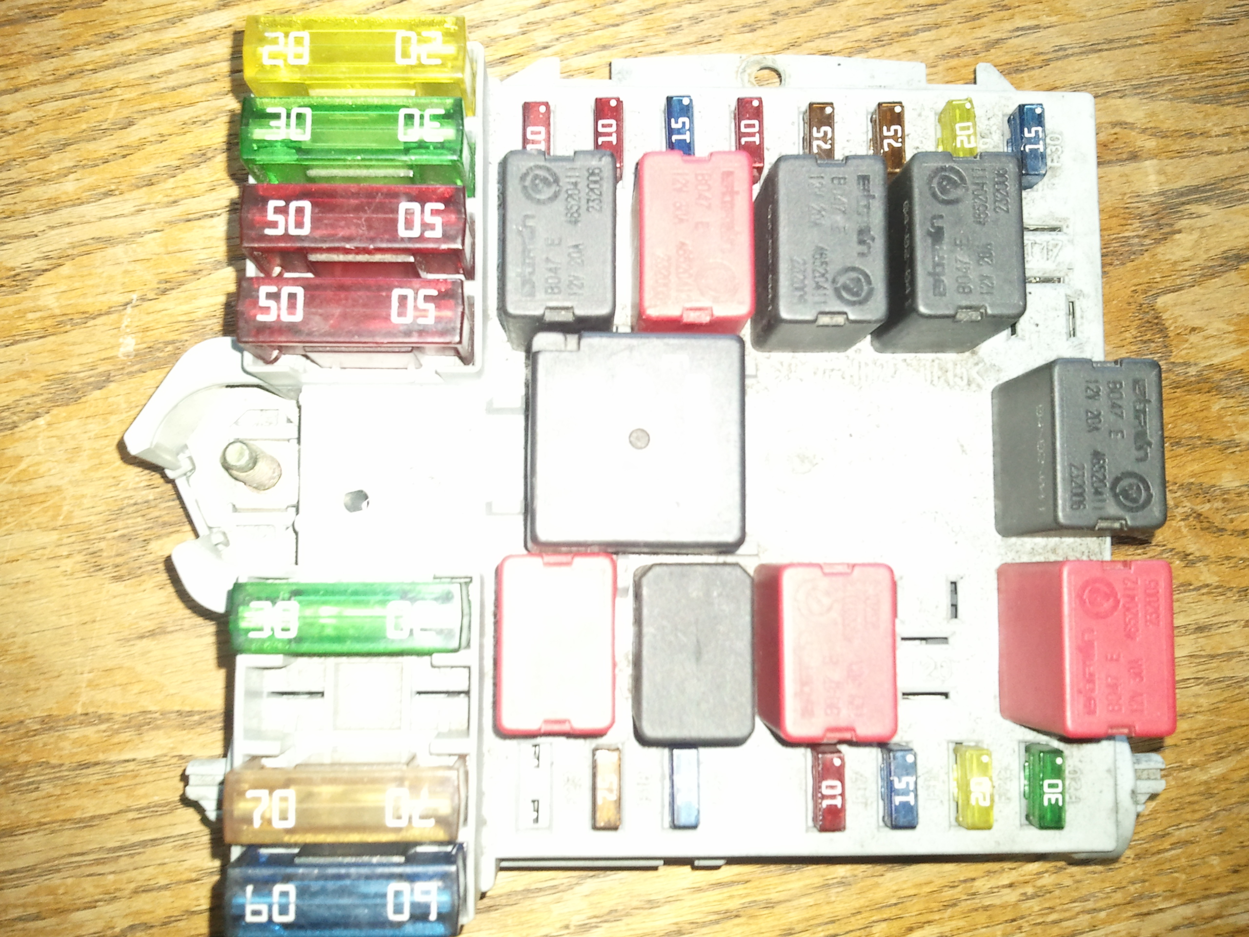

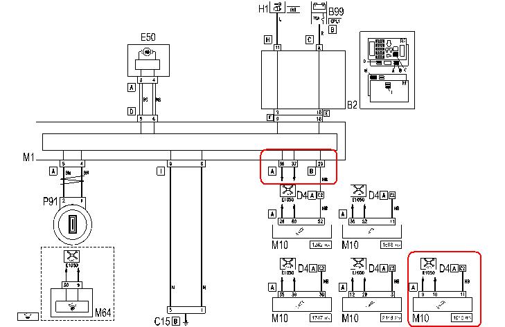

Fixed at last turned out to be a Can wire where it passed through the bulk head causing a short 10 out of 10 to shadeyman cost me £140 at Advanced Auto in Rockferry Wirral (Good Guys) and a big thanks to deckchair5 , davren and everyone else. I found some wiring diagrams in my car they may help someone the site is not letting me upload them ?just message me if you want them.
Thanks Again
Chris
Diagrams and photos may help some one
sorted was using wirar not winzip
  • Diagrams and photos.zip
