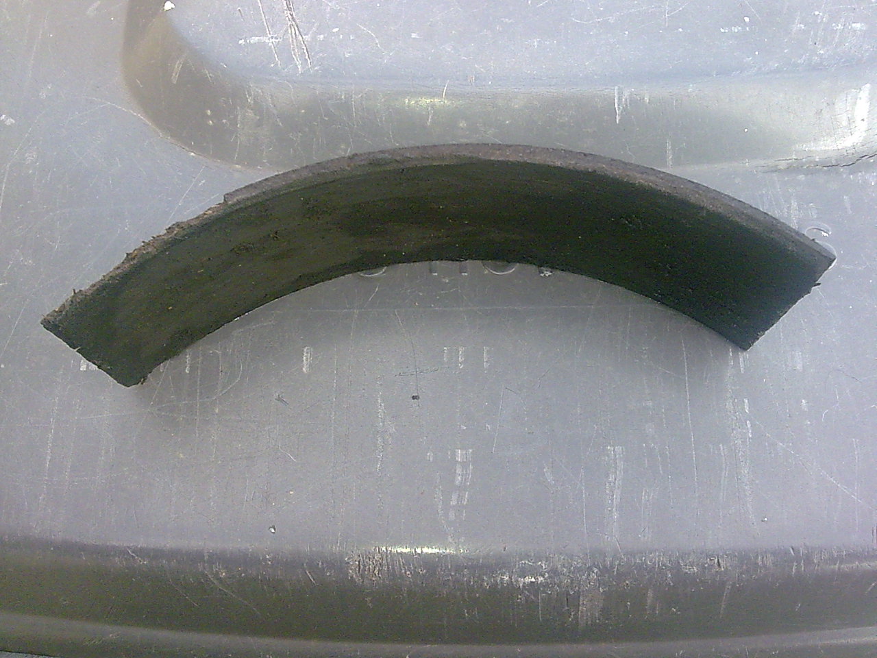

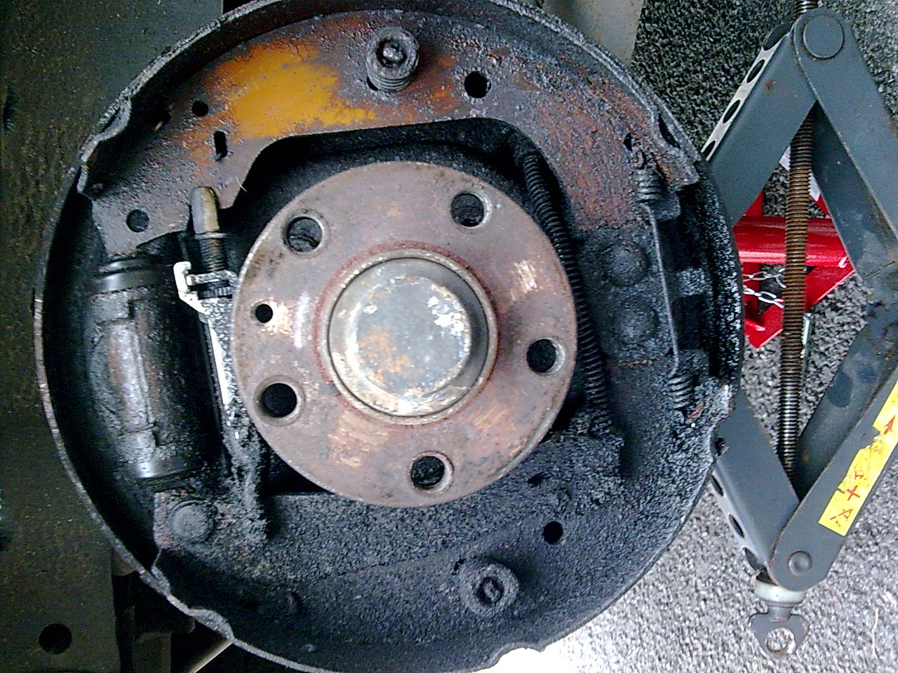

It was indeed the brake lining(s).

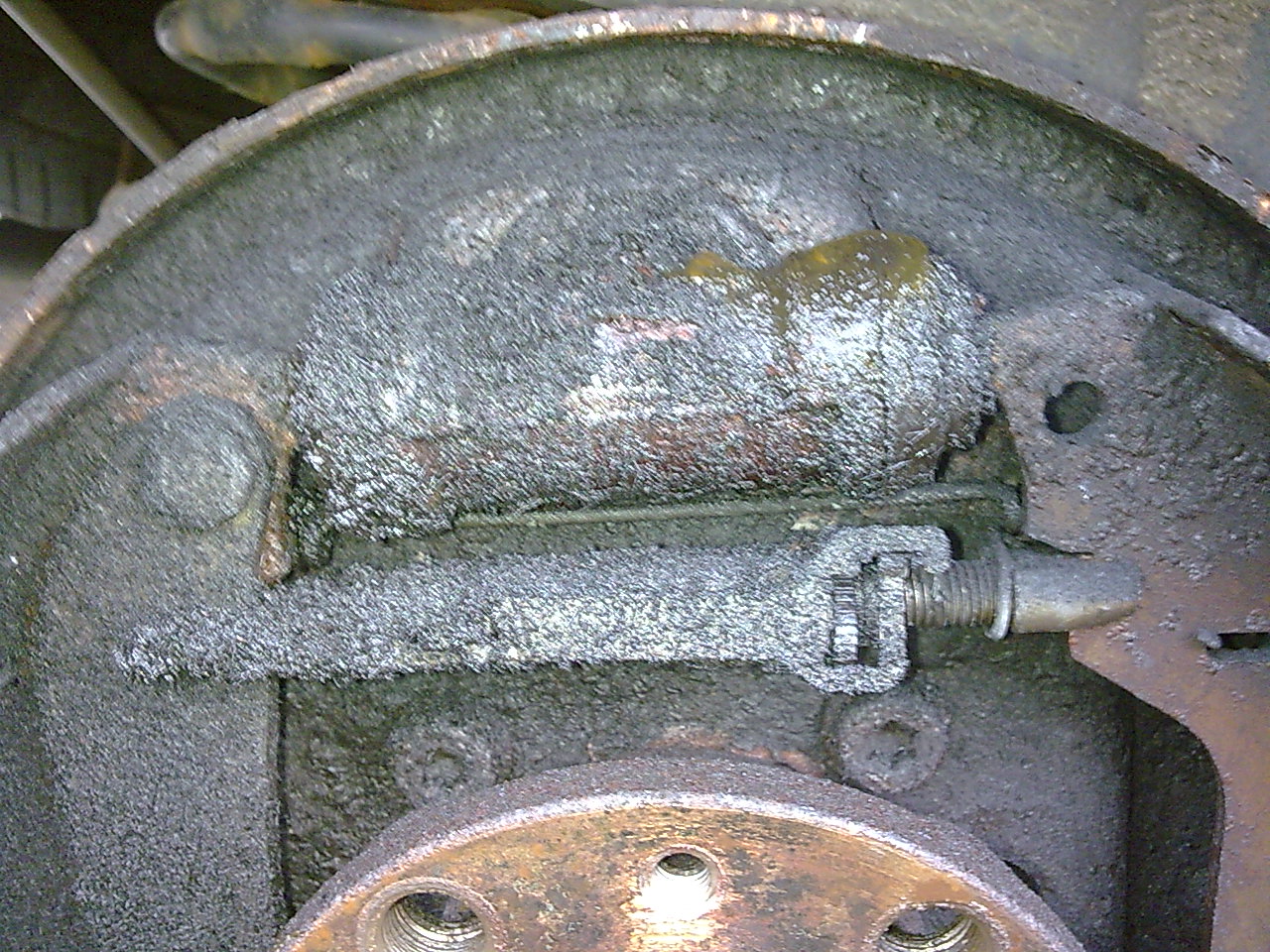

And the slave Wheel Cylinder.
Images attached.

That certainly one of the worst I've seen for a long time, with that leak surely you must have seen it weeping on the inside of the wheel?
FF, I check the oil, water and Brake fluid levels regularly. In the time that I have owned it, the brake fluid has only needed a small top up.
I check the back of the drums, because on a previous ulysse, I had an advisory for a minute leak of fluid from the connection of the Cylinder at the rear of the drum. Turned out that there was never a leak, but it had me thinking that they are often overlooked in checks dy the driver.
The answer to your question is 'No' I didn't notice anything on the wheel.
However, in my defence (not ignorance), I do have a small engine oil leak and if anything was on the floor in terms of 'Patches' - I would have put it down to the oil leak from the engine. (We park in differing directions all the time, so the patches would be possitioned in different locations on the road).
I take pride in servicing my car and buying and replacing parts with new parts even before they have actually gone. I have children and will never cut corners on safety. But this is a worrying situation at just how easy, something as important as this (brakes) can be overlooked.
Thanks for your input, it is appreciated.
