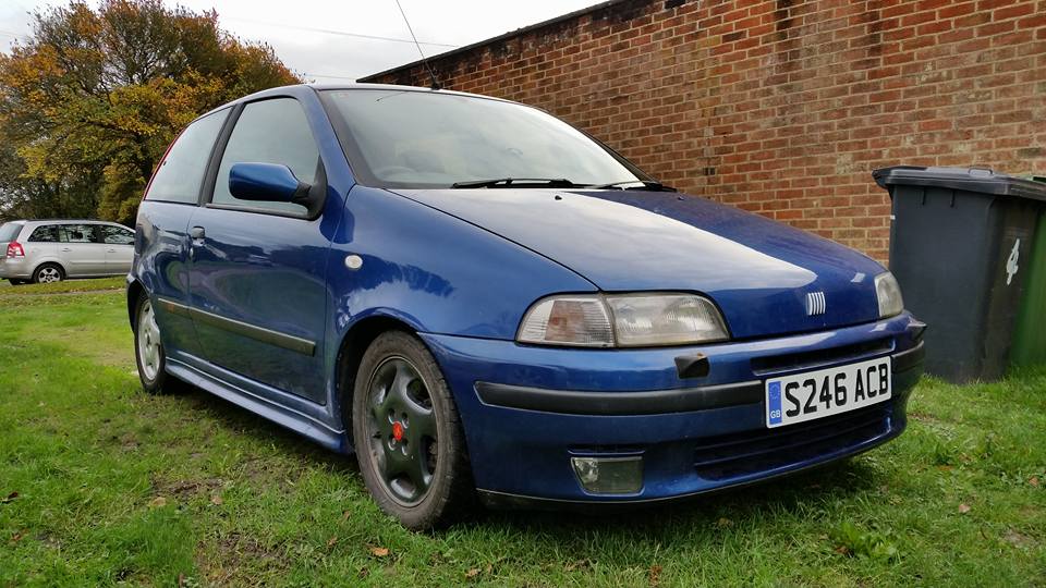

well good news,car runs,no longer jammed in gear,moves drives as she should :) mot is next,then tax and off i go :)

Well before that I replaced flexible pipe from turbo to cat and that's cured exhaust blow ,brake light and exhaust rubber next and sorted she can't fail,fingers crossed
productive day,all little things too!
started with handbrake light,seems wire snapped at the connector,soon fixed and works once more,
rear 3rd light wasnt working,multimeter confirmed was power so re seated all connectors and tada! working break light.
exhaust hanger rubber had failed comepletely,so chucked spare one i had one,
as mentioned before replaced flexi section but seems a little shorter than ebfore so not sat right,if rain eases up il have another go at getting it settled
