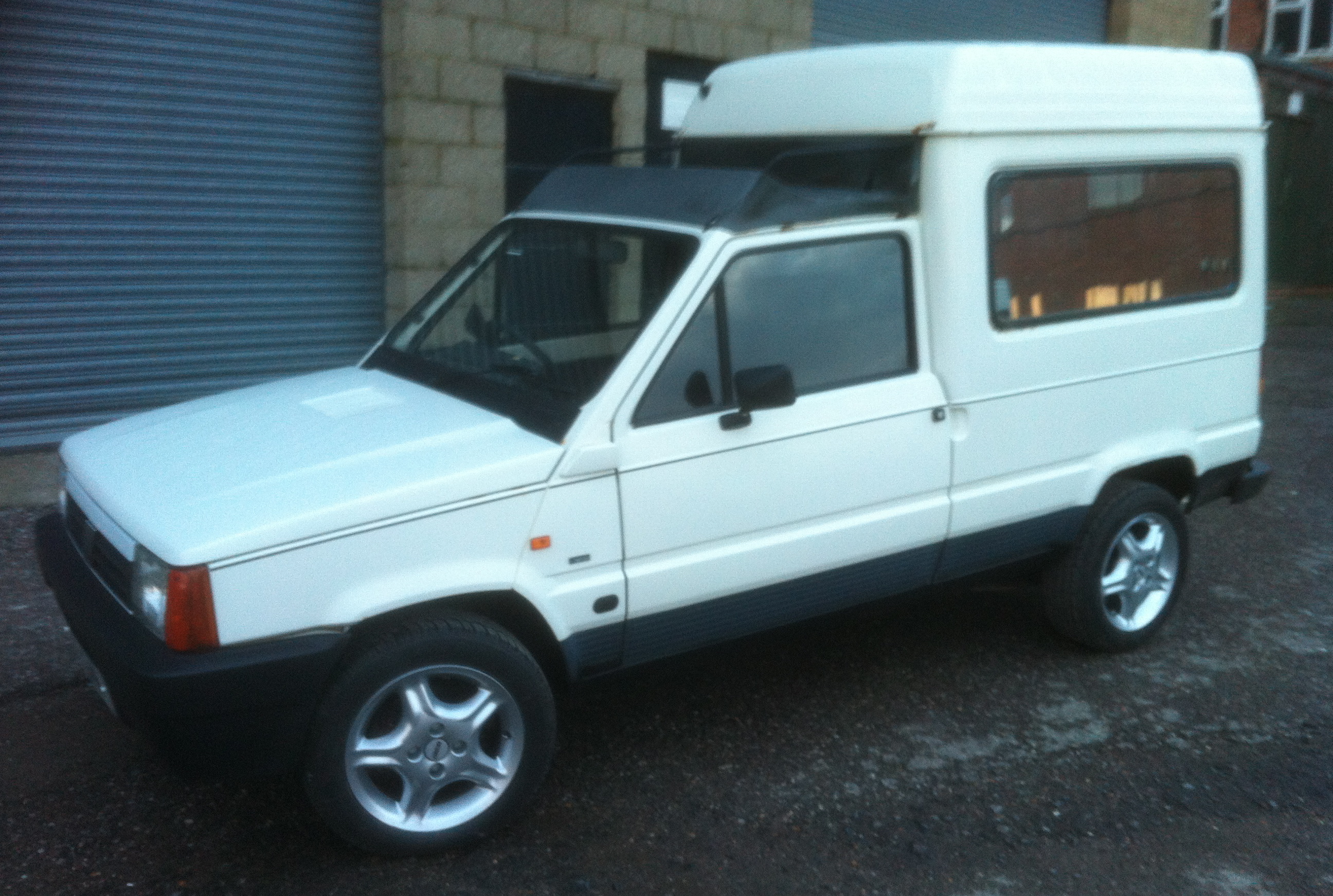

Well I finally managed to wash it today, and polish, and wax, and vacuum the interior. First Panda i've needed a ladder to clean. I don't think the roof had been cleaned for at least ten years :yuck:.

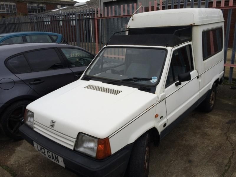

So, picked it up on Monday looking like this.......
And so far it now looks like this.......

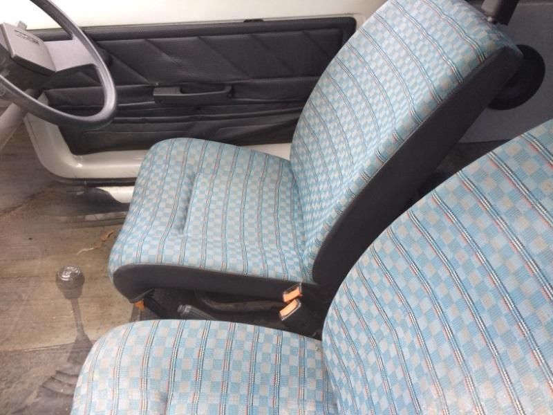

Interior received a little attention today besides the vacuum. These were the original seats...........
Good clean condition but not comfortable for long trips so, and I know I'm repeating myself here, but........

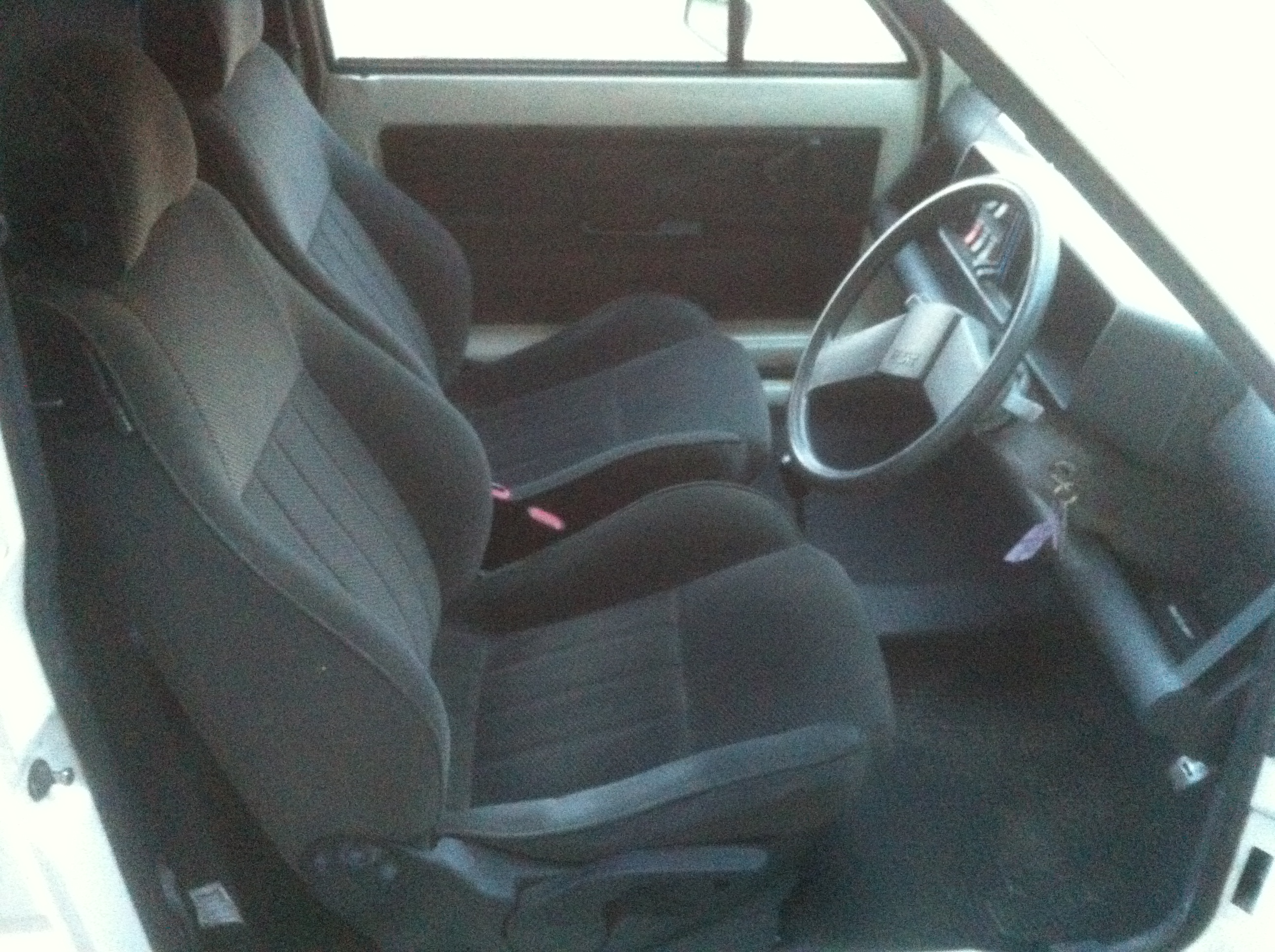

I just happened to have some spare Alfa seats kicking around, in fact the whole transformation has been made from spare bits and pieces. It was great to use them up but now I have just as many Seat parts :rolleyes:, which will be even harder to make use of.

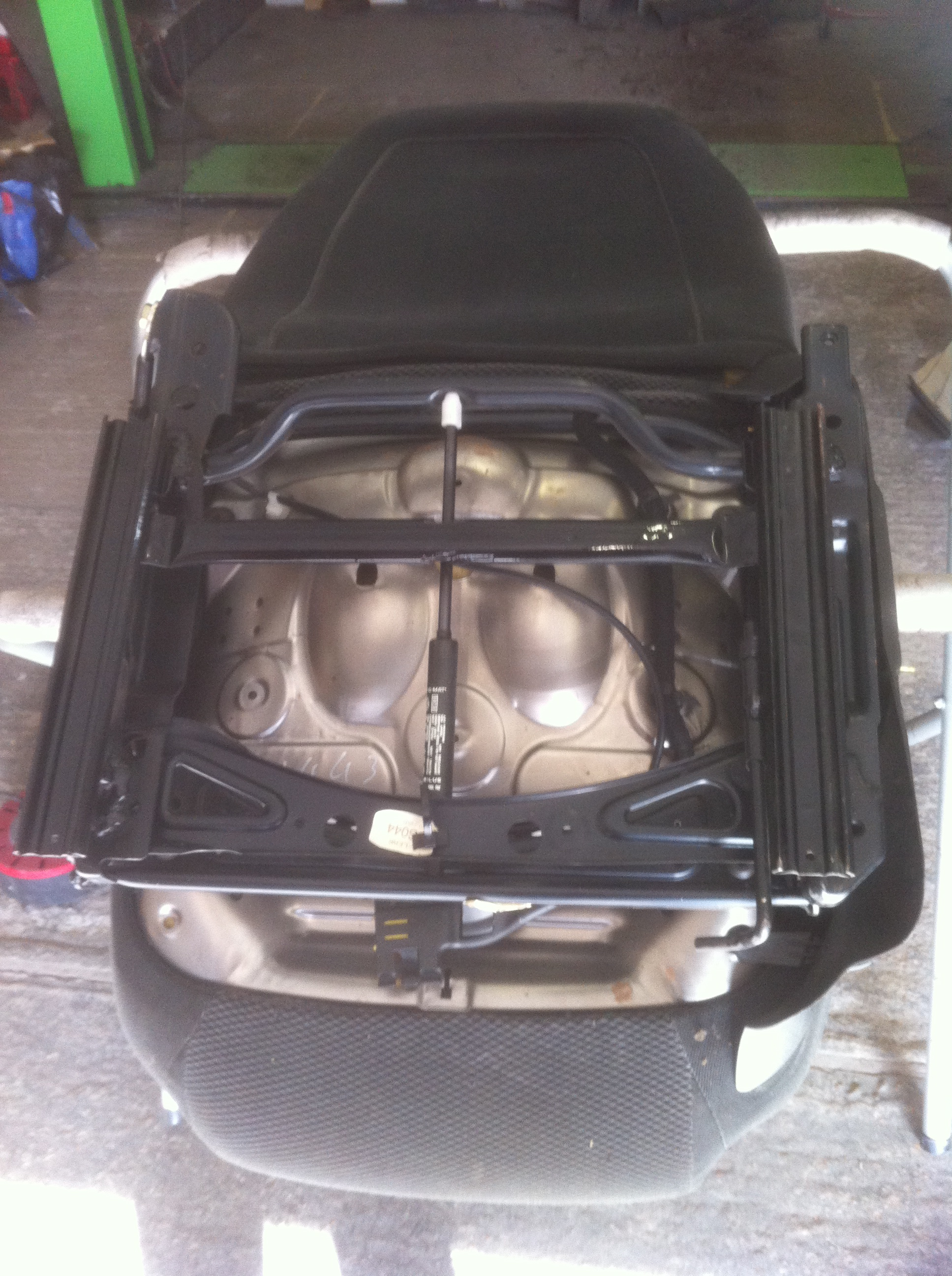

The Alfa seats are not only a better fit in a Mk1-esque shell but they are easier to fit too. No subframes were needed this time, I just cut the runners off a pair of Mk1 seat frames, unbolted the runners from the Alfa seats then welded the Mk1 runners to the Alfa frames........
Still have a couple of jobs to do, fit a radio and change the reflective window tint for limo black, but for now it's done. :)
