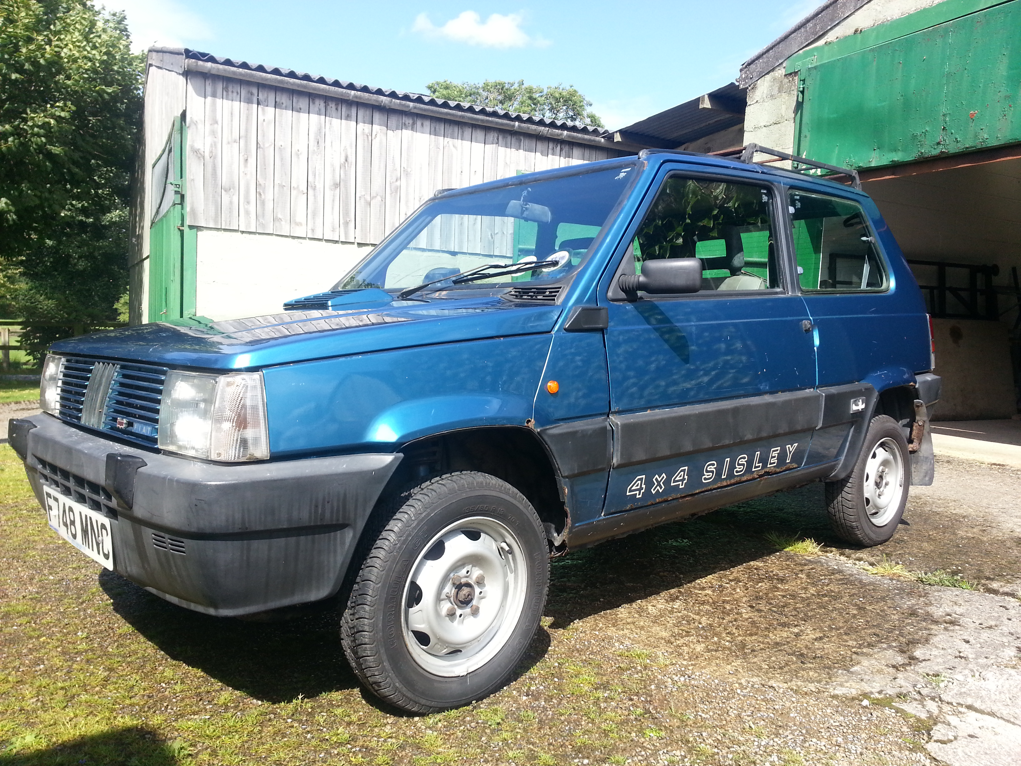

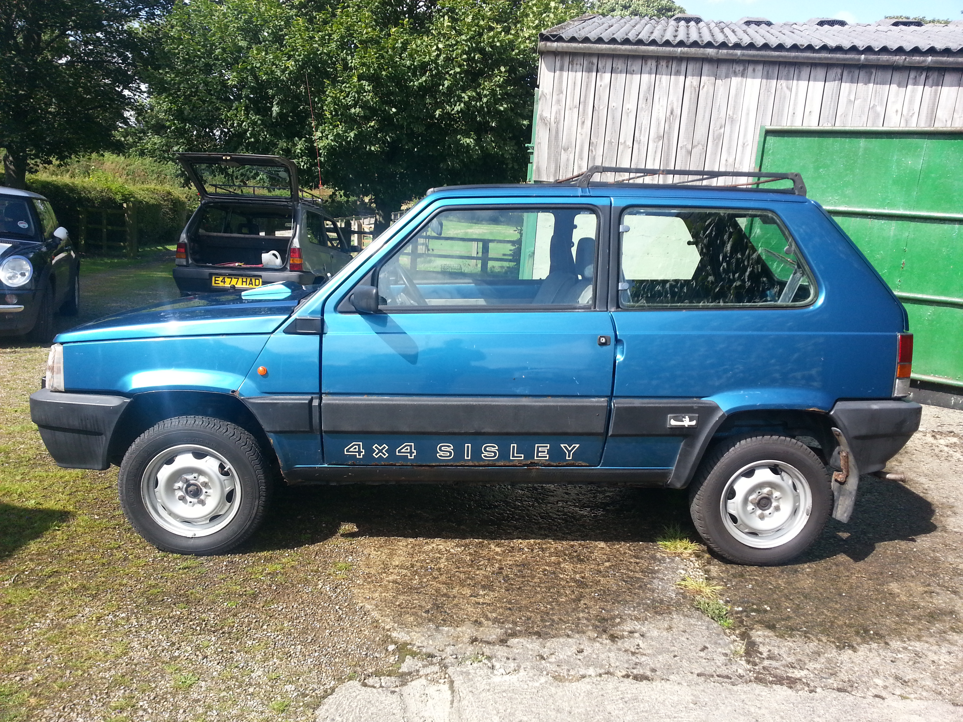

As Sam says she's had a good wash off thisafternoon, and come up remarkably well I think!
There are several areas on the bodywork where there are blemishes, small dents, chips and scratches, but it's to be expected. The front windscreen must have been leaking at some point as it's been siliconed in around both top corners. It's the original screen though with Fiat water mark and number plate mark.
All the windows are crack and chip free, both rear window locking mechanisms are working and none of the hinges are cracked either.
I pumped all the tyres back up aswell, she's running ultra skinny 135s but all four are brand new!

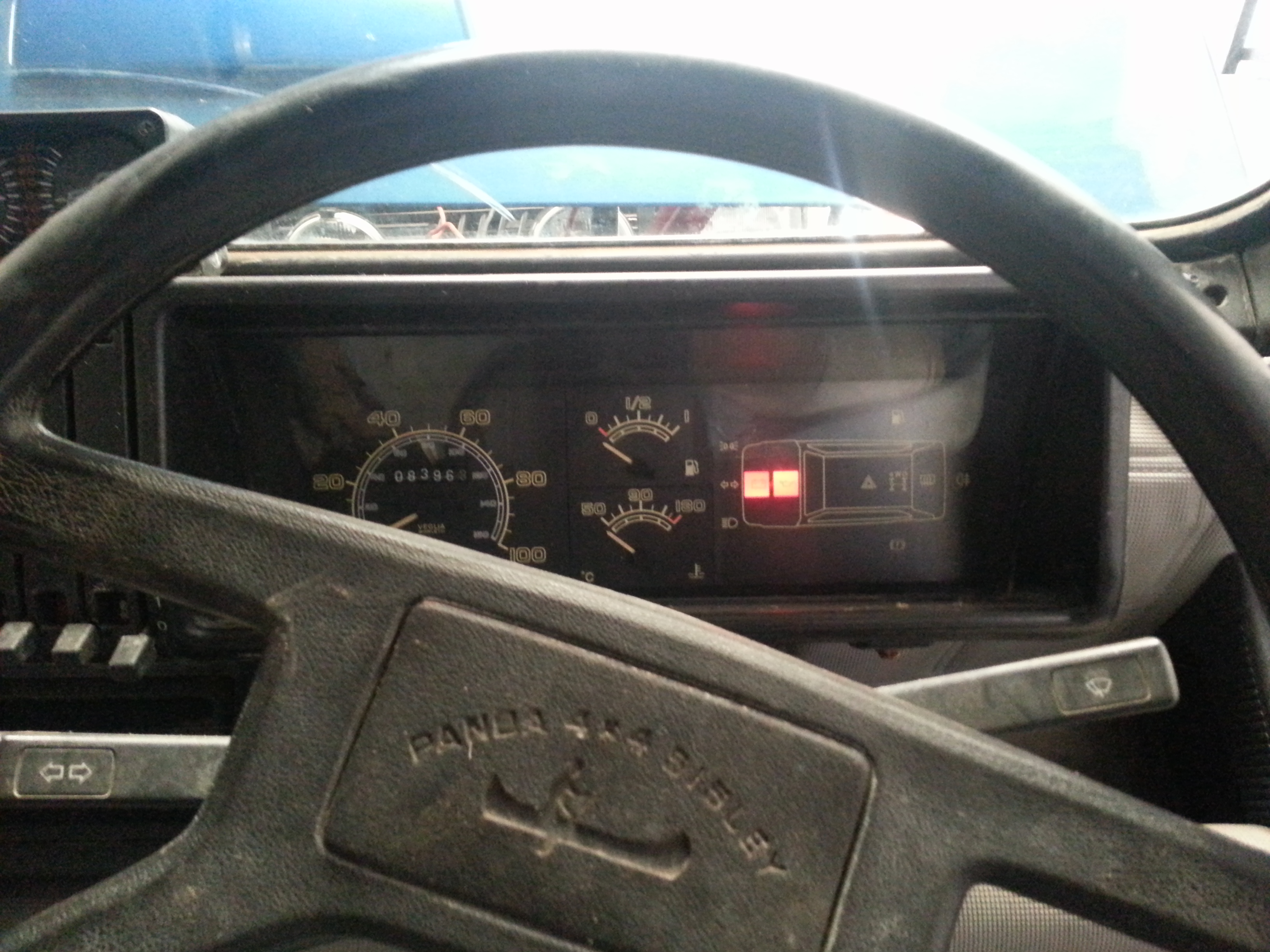

The next job was to check out the engine situation, we got Hadrian fired up with some jump leads on the check for the ignition...
...which is all working well, lights and fans all working good.

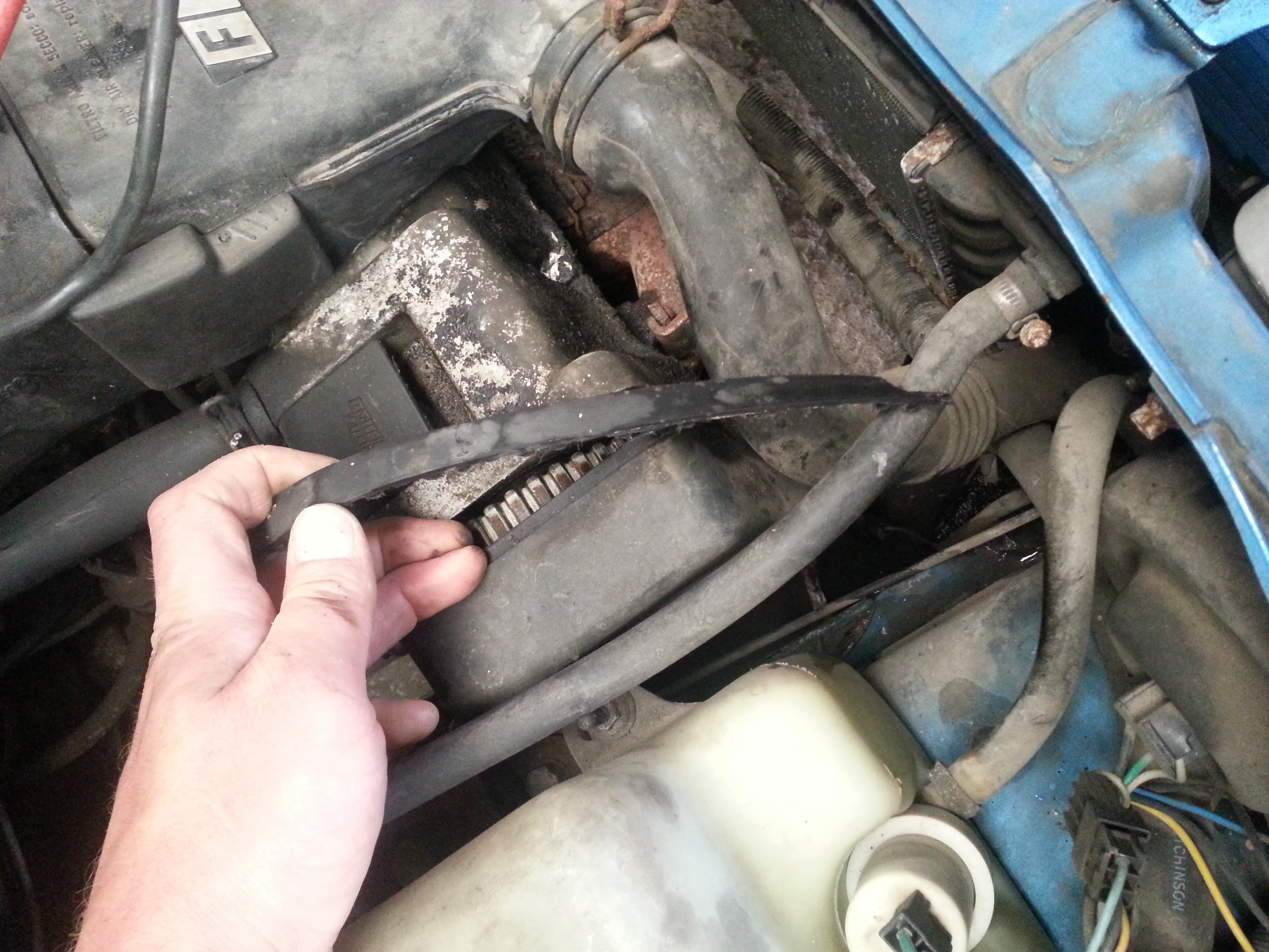

I wanted to check the cambelt though before anything was done with the engine and it's a good job...
So we now know why she's a none-runner! With her having done 80k miles and one owner, I am thinking that will be the original belt, and the reason why she was taken off the road in 1998.
So I'll get the new belt on and timed up, hopefully nothing should have got squashed inside with it being a none-interfearence engine.

Correct call on the cam belt mate , well done. If that wasn't done on time maybe the full service was overdue too?
And why did it snap - is the water pump spinning freely? Its easy to fly in and do everything, I think restraint and one step at a time is the right way if excitement can be contained.
At this rate September's event will be oversubscribed just with Sisley's.
Well I don't want to be optimistic about September, I can get the mechanics done but it's going to be a struggle to get it painted in time I think. But anyway as you say slowly slowly - if it hasn't run for that long who knows what could go pop, or infact bang.
The water pump does spin but the position where the belt has snapped was around the pump, plus about 8 inches worth of teeth on the belt have been stripped at that point. The header tank is bone dry but the engine does wind round on the bottom pulley.
