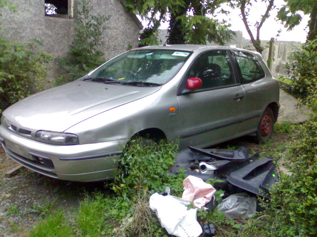

Heres the replacement for my highly abused yet extremely reliable Bravo.... Another Bravo (y) I'm moving up a year here :D Not going to be bitten like the last time, this is going to have a strip down and re-rustproof with a few bits to be thrown in too (copper lines all round are in the plans). Most importantly, this car is going to be converted to a van and painted black with some "toys" installed... More pics soon! :)

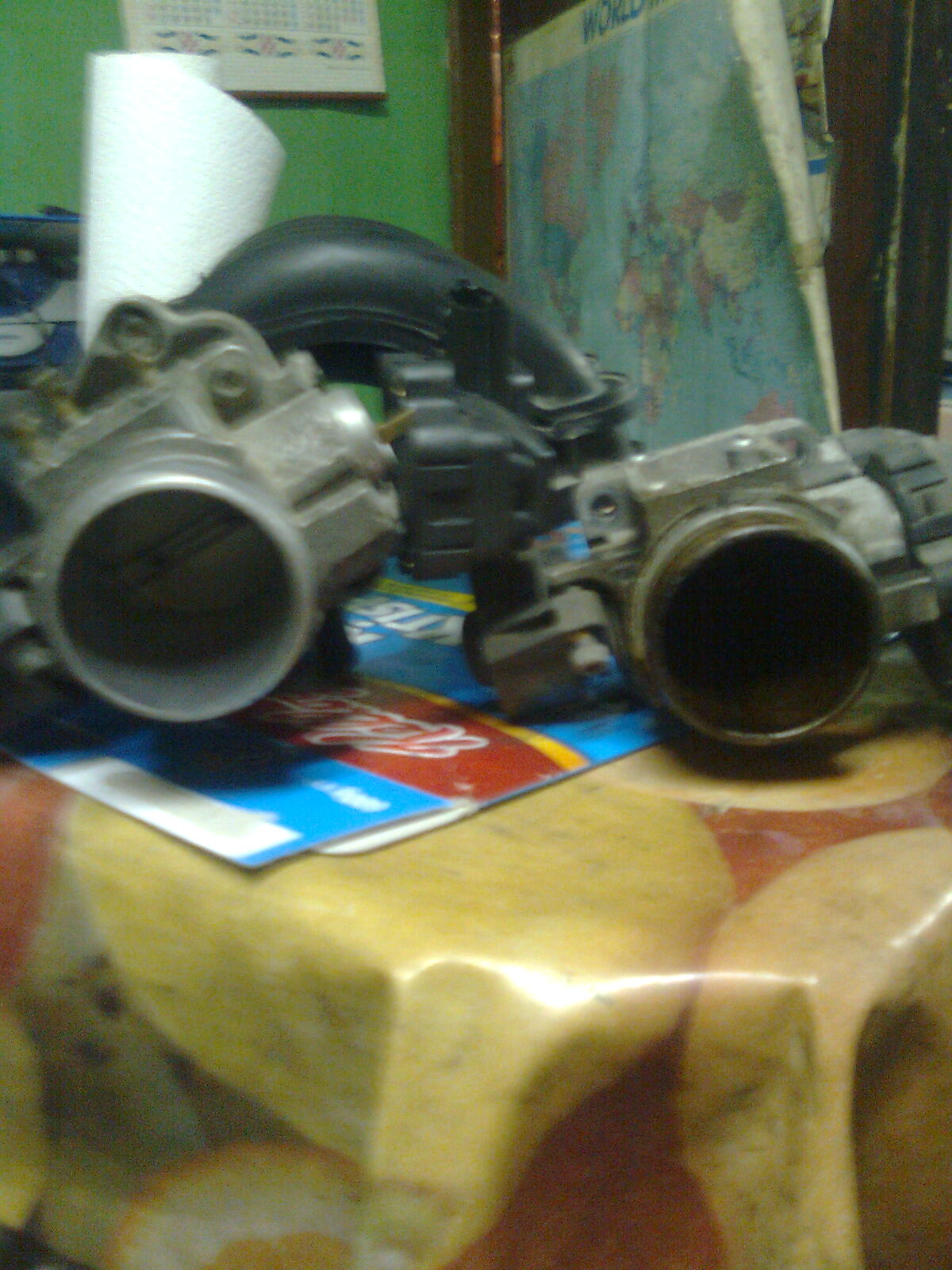

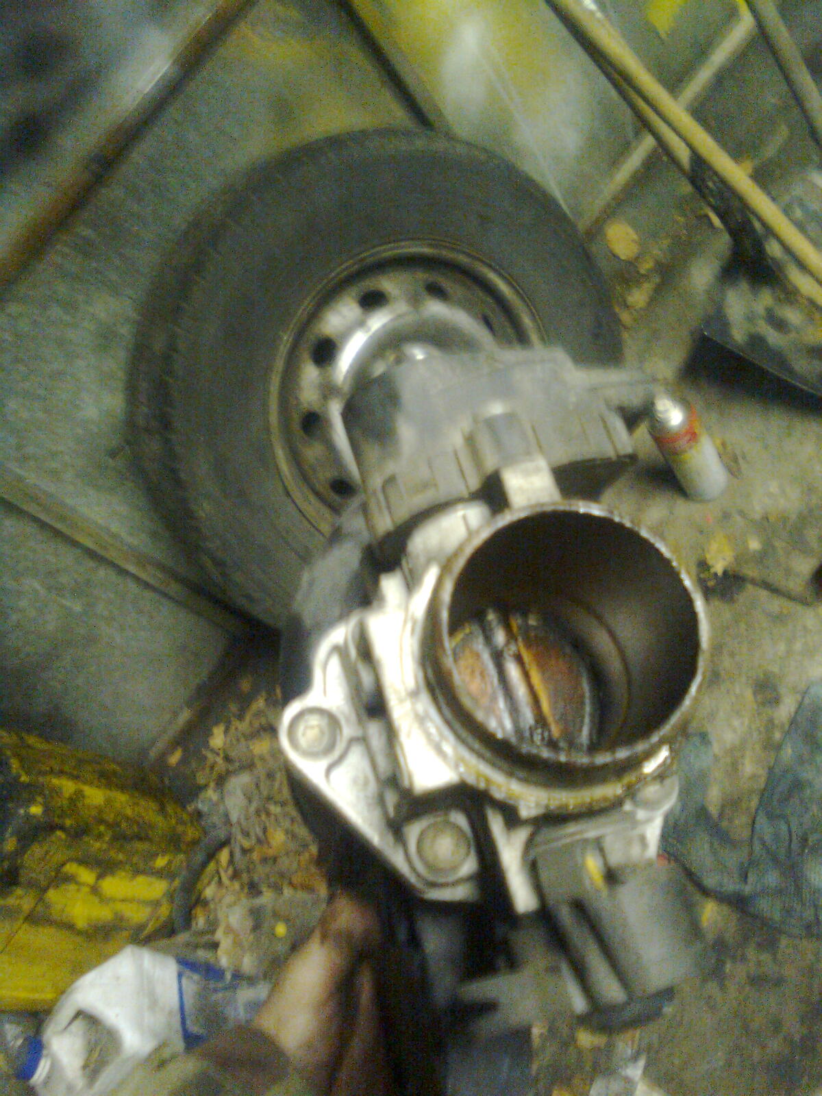

Now I have a few tbs lying about. Just have to get one, clean it a bit, sand it...
... and hey presto, smoothed and polished (y)

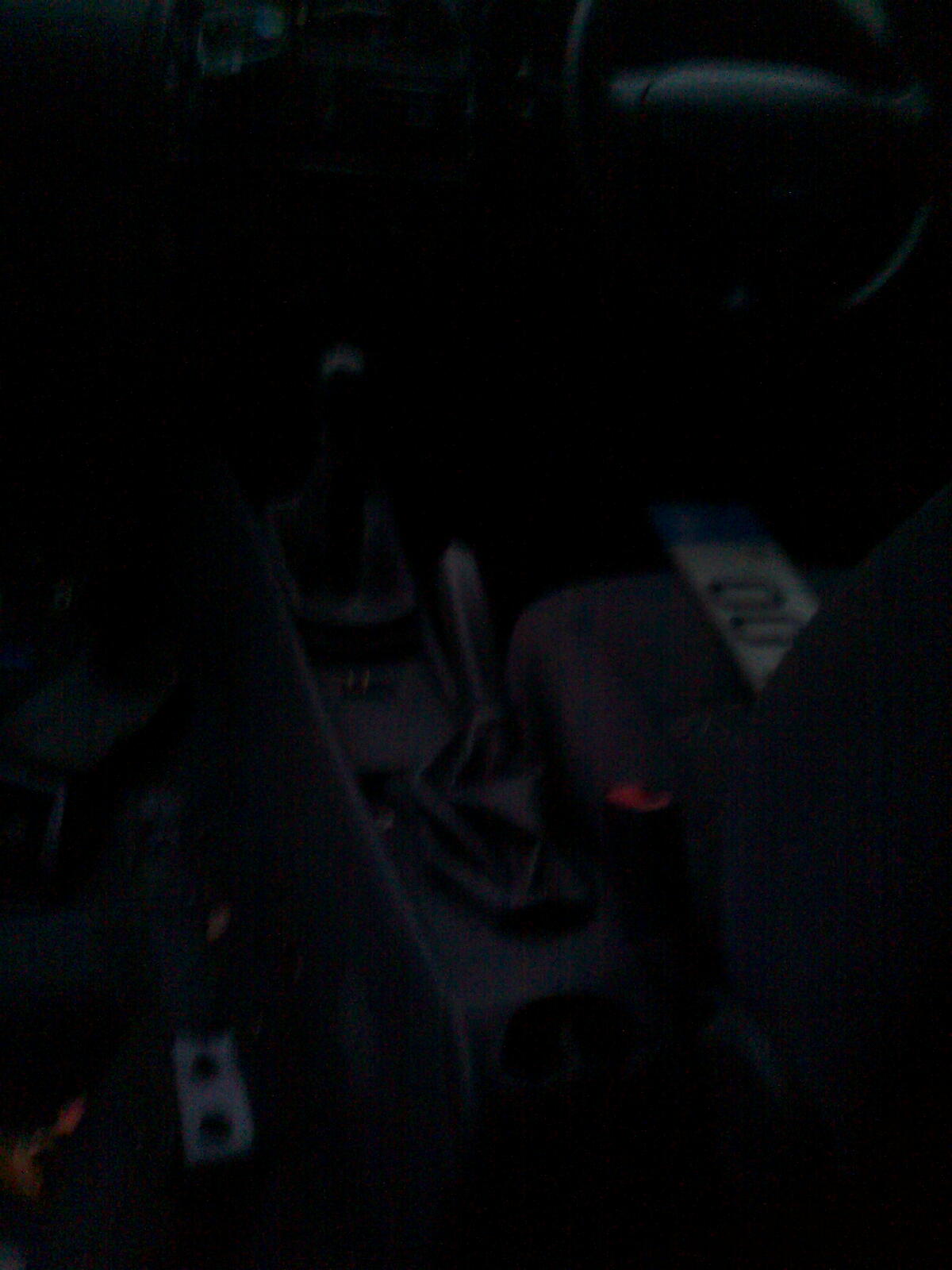

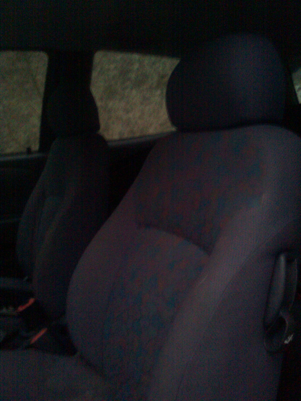

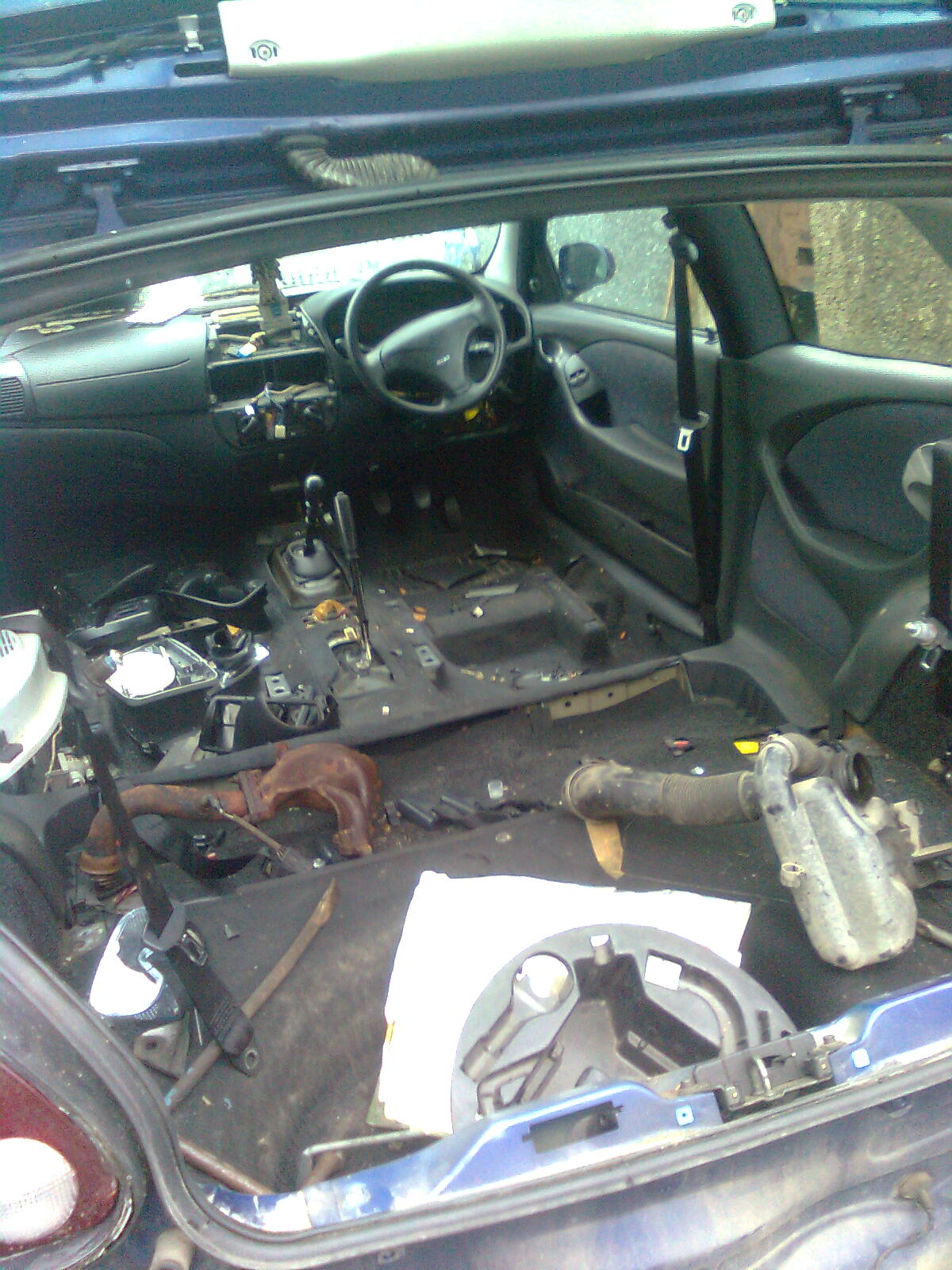

Not realy an update but I did get some stuff done in half an hour, seating for one and no friendly plastic guards atall (y)
But I need more time! What will be done for the next update I wonder.... :yum:

what did you use to clean + polish the TB with?
To clean: Standard cellulose thinners on a rag
To smooth: P60 + P400 grit sand paper
To polish: P1800 wet and dry + lots and lots of patience!!! (y)
Ive did this before on my old Bravo and it worked very well (the difference was instantly noticable, much better response and sound). Why did I do this again when I already had one done before? To see if I could still do it :p

ooh great, thanks Mal..i might try that myself, i could do with more response low down:)
how long roughly did it take ? cause i think i might do it this sunday:cool:
and mike when i took my tb off, without polishing it, it still came up really nice...and theres normally quite a bit of greasy oil inside too..tis good to clean it out once in a while :)

Your best bet is to clean it up realy well first then take it in small steps on how much to take off and trial running it. Its alright for me that has 5 to play with for the one car, if you get another tb first and experiment that would be the way to go. If it goes wrong the car wont run right atall, it will be getting the wrong amount of air and totally wrong airflow, trust me ive been there...!
Im afraid to say it took over 5 hours to do the sanding....!!! :eek: A good clean is a good start though and dosent take that long (y)

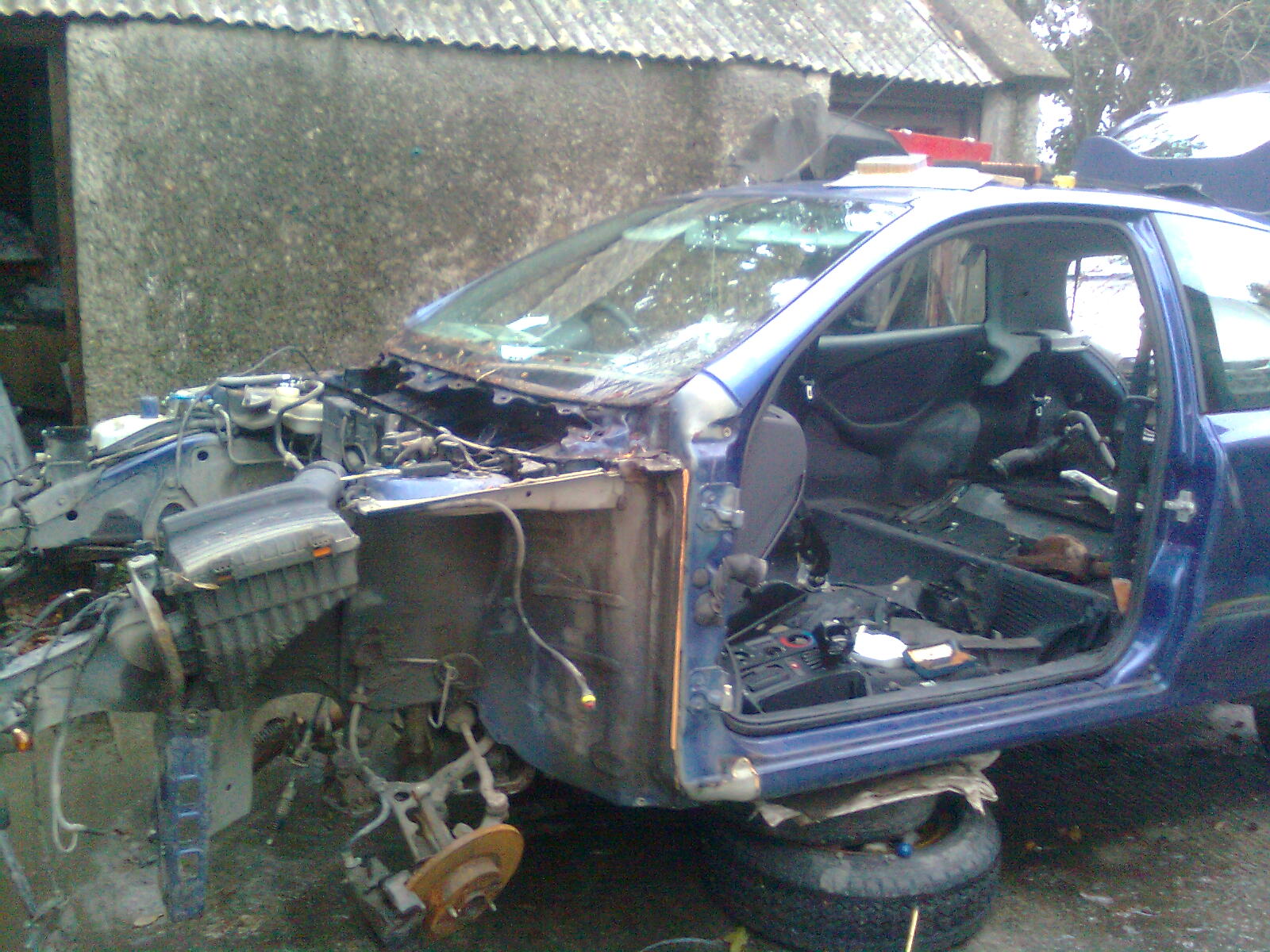

To begin with the car had to be relocated for the space to whip the engine out
Note the comedy ride height. Its abnormally high....
About 20 minutes later: Progress (y)
Wait a minute...
And that shouldnt be rusty either...
Ah not to worry, some hammerite will sort that :) The engines ready to come out :) But I need a second person. Onto the interior, or whats left of it :p

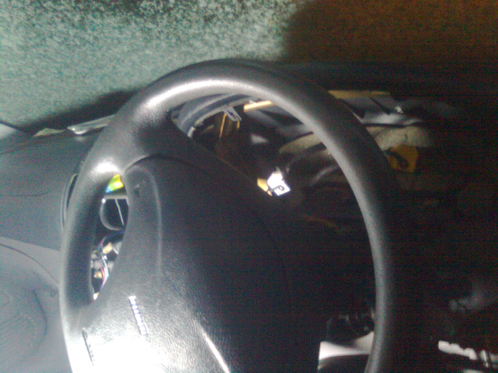

I despise those steering wheels, theyre sooooo ugly :mad: When the interior is fully out I have this for it. Keep the heat in the winter, keep the heat out in summer ;)

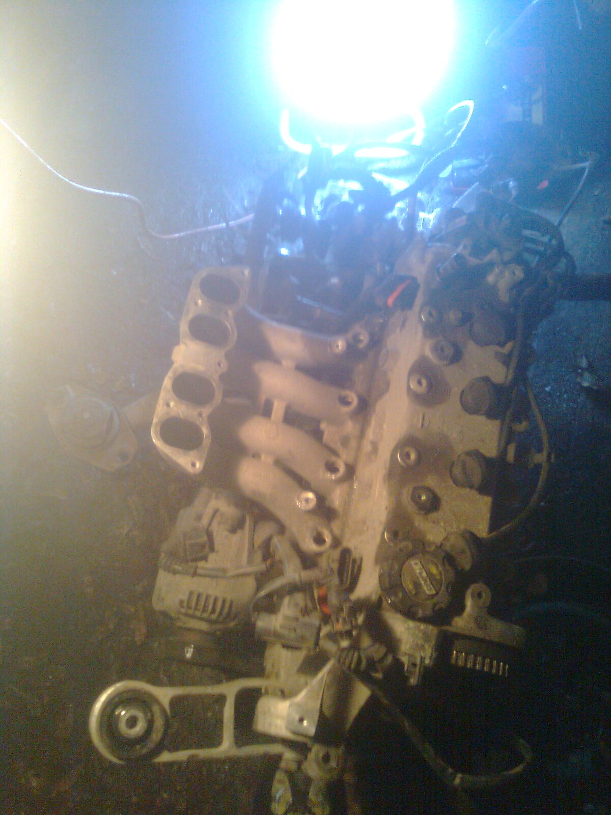

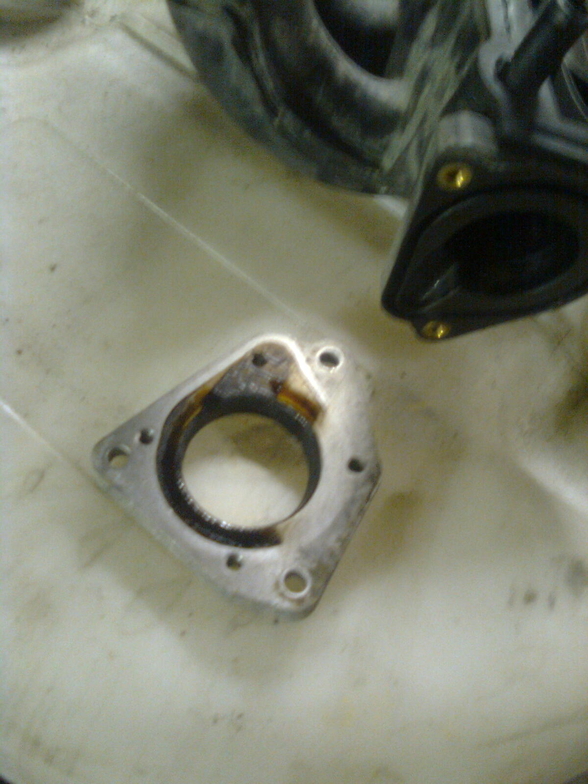

While I'm still waiting I decided to clean up my stinky manifold :D
Now I couldnt get the light to shine in right but the difference after was day and night. Just like the adaptor for the tb
Job done, time for a coffee (y)

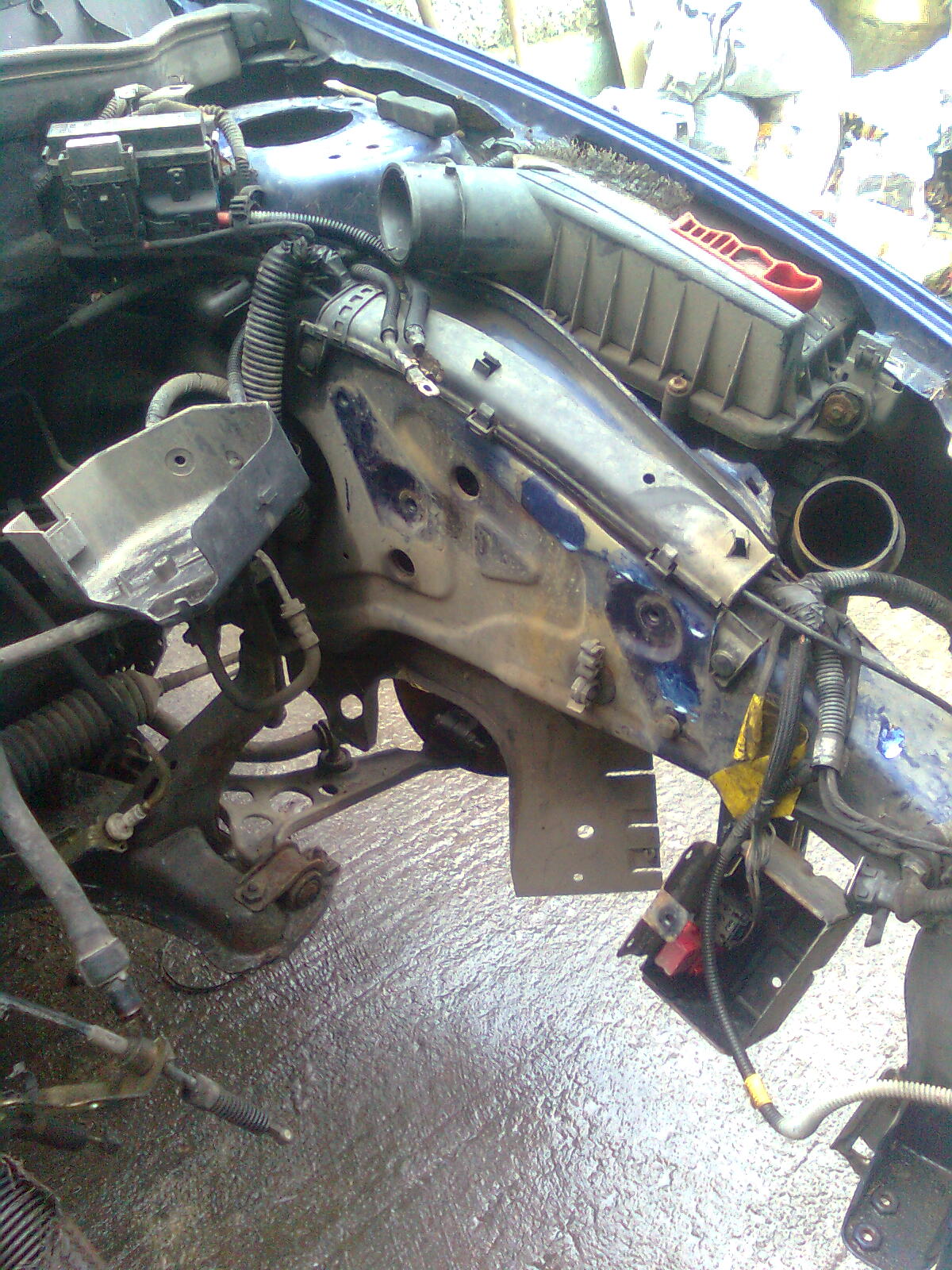

Reinforcement has arrived so its time to take that engine out (y) Its been freezing since the last photo...
20 minutes later...

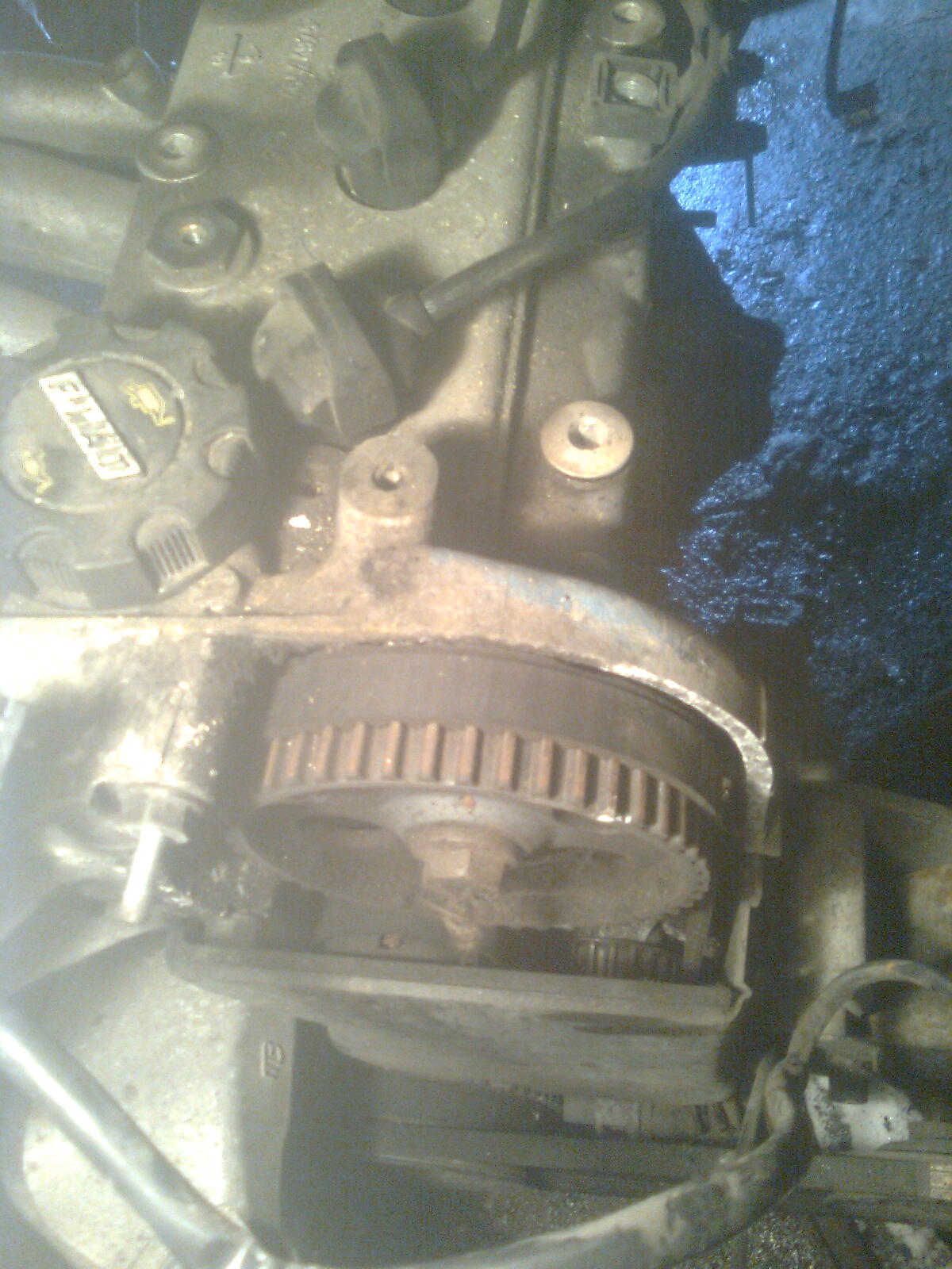

(y) Horay! Eh wait a minute that definetly dosent look right...

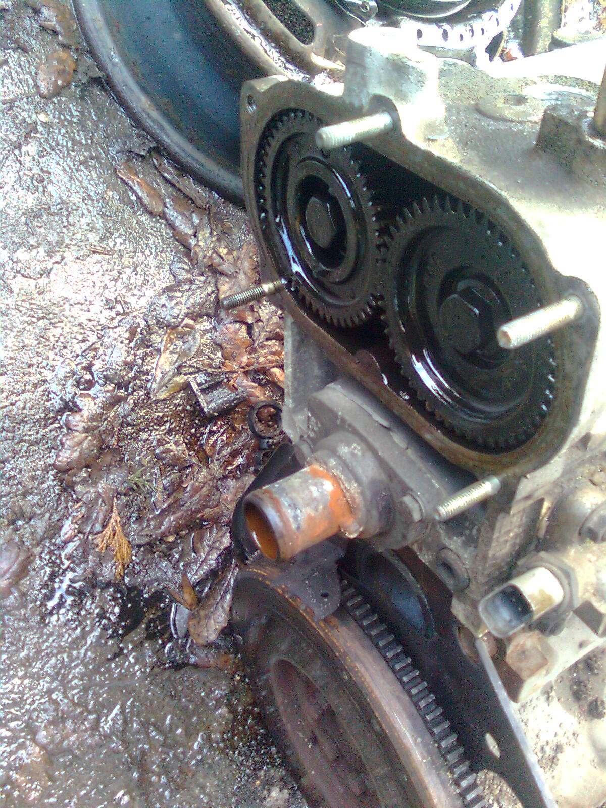

The so called mechanic that serviced this car put on a belt for a 1.2 8v :doh: Fortunate that the belt didnt break...

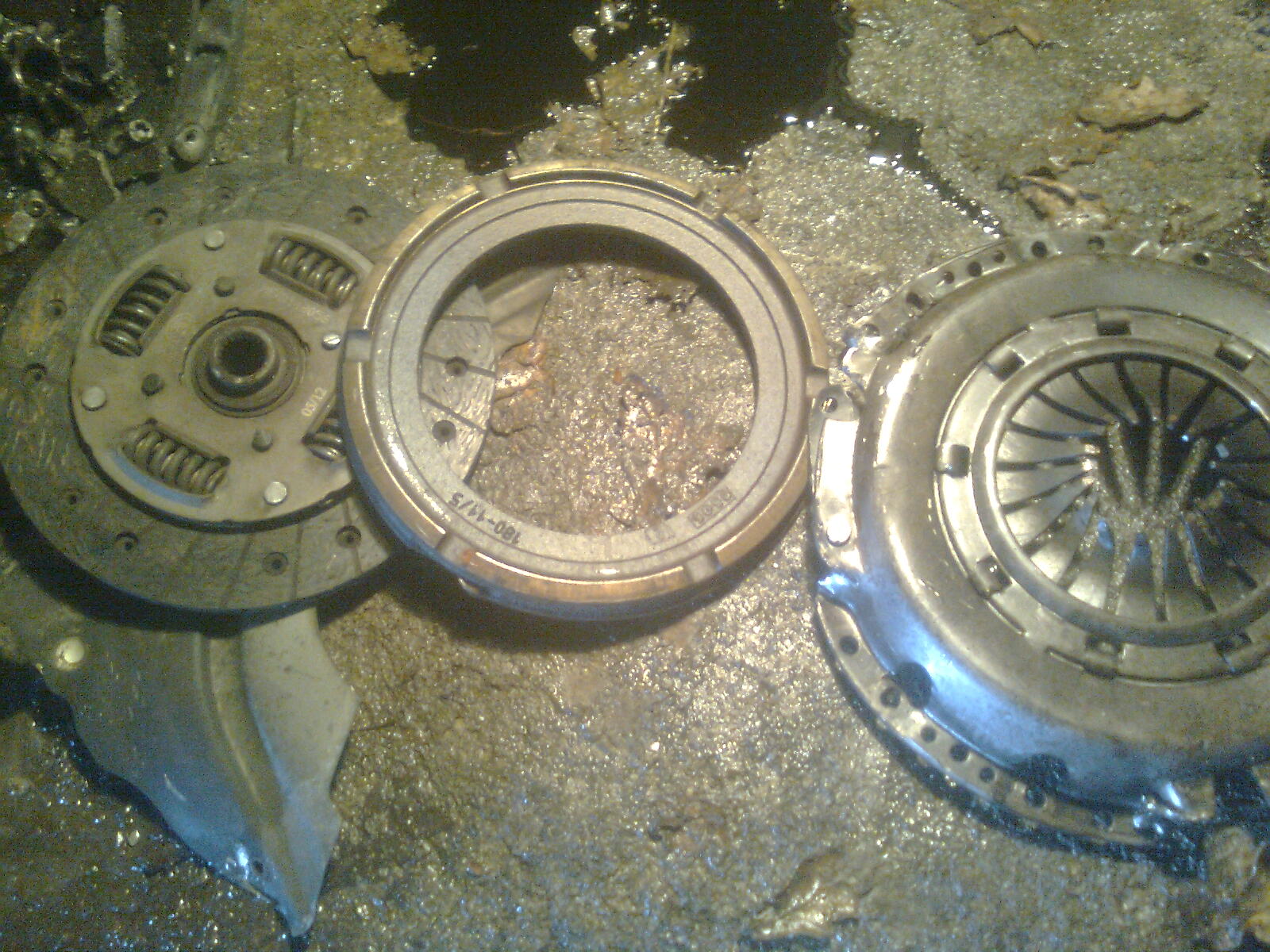

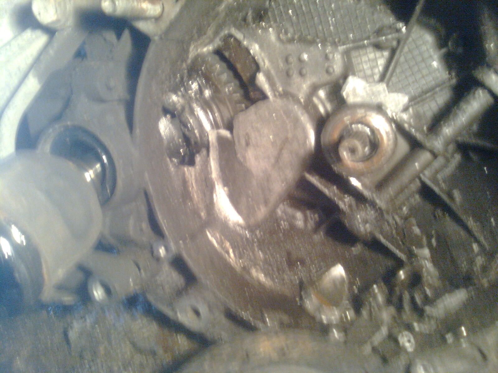

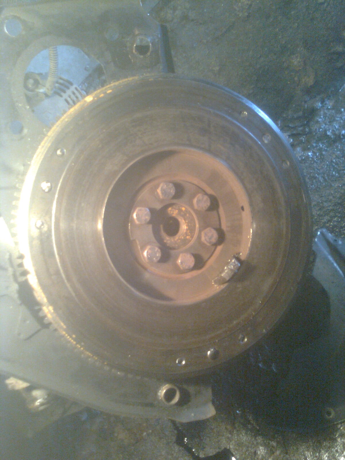

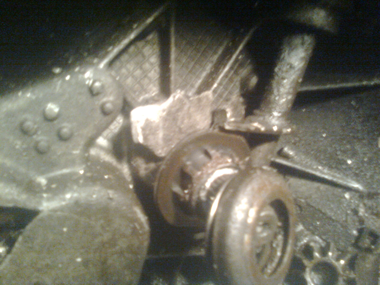

The previous owner said he stopped driving the car because it lost all gears. Ah this is the common diff failure so, simple to fix (y) Time to split the box from the engine...
Hang on somethings not right about that :confused: Lets take it off fully...
:eek::eek::eek::eek::eek: WTF????!!!!!!!!!
I have never seen that happen before, ever. Even the couplings didnt escape the torture :cry:
Maintained? By what a madman thats trigger happy with an airgun? This is by far the worst maintained Fiat weve ever had. To sum it all up, when we lifted the box up...
Words just failed me. I didnt get pictures of the injector rail bolts that were rang off. Or the missing manifold studs. Or the coil pack thats glued on. Or how tatty the loom is. Its a disgrace that a Fiat was let go into this condition (n)(n)(n) What wonders will I find next? I cant wait... :cry:

Blimey looks like its had a hard life. I notice all the bolts and dowels have snapped off on the flywheel, is the clutch the right one or where the dowels ground off to fit it?
Im enjoying the pics (y)
And there was me thinking this car had it handy, online pictures can be deceiving!! :D What we think happened was the clutch needed replacing (that is a new clutch btw, even if it is unusable) so they got someone to do it that overtightened the bolts, along with some hard driving (the bushes and ball joints are in bits) and to set it all off the common diff failure, which when goes causes an unholy mess in the bell housing (been there twice (n)). The release bearing actually had been crushed into a grey paste in some parts... Just goes to show, I thought I'd seen it all!!

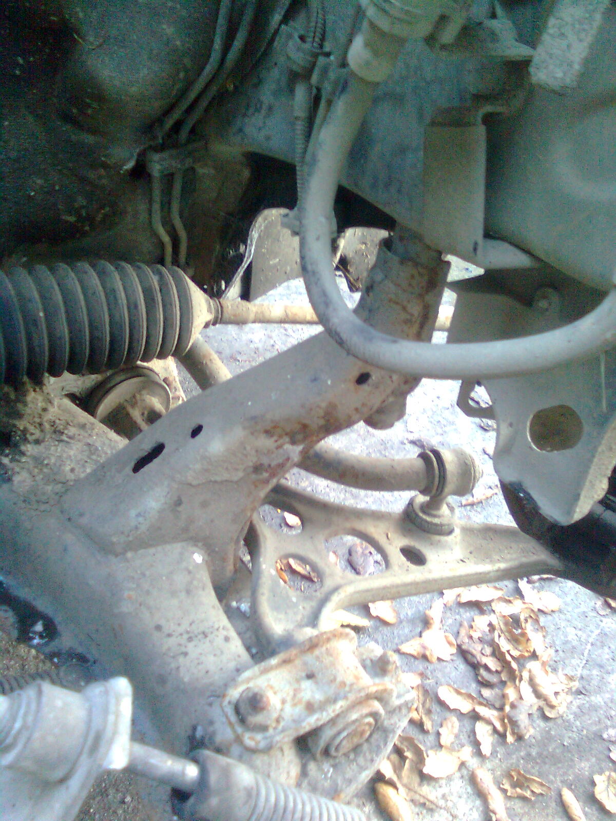

Now I knew that the exhaust was rotten but come on how could anyone not notice the racket inside?! A closer look at the subframe....
Oh dear, rust :mad:
These cars are rust proofed, how did this happen??? :confused:

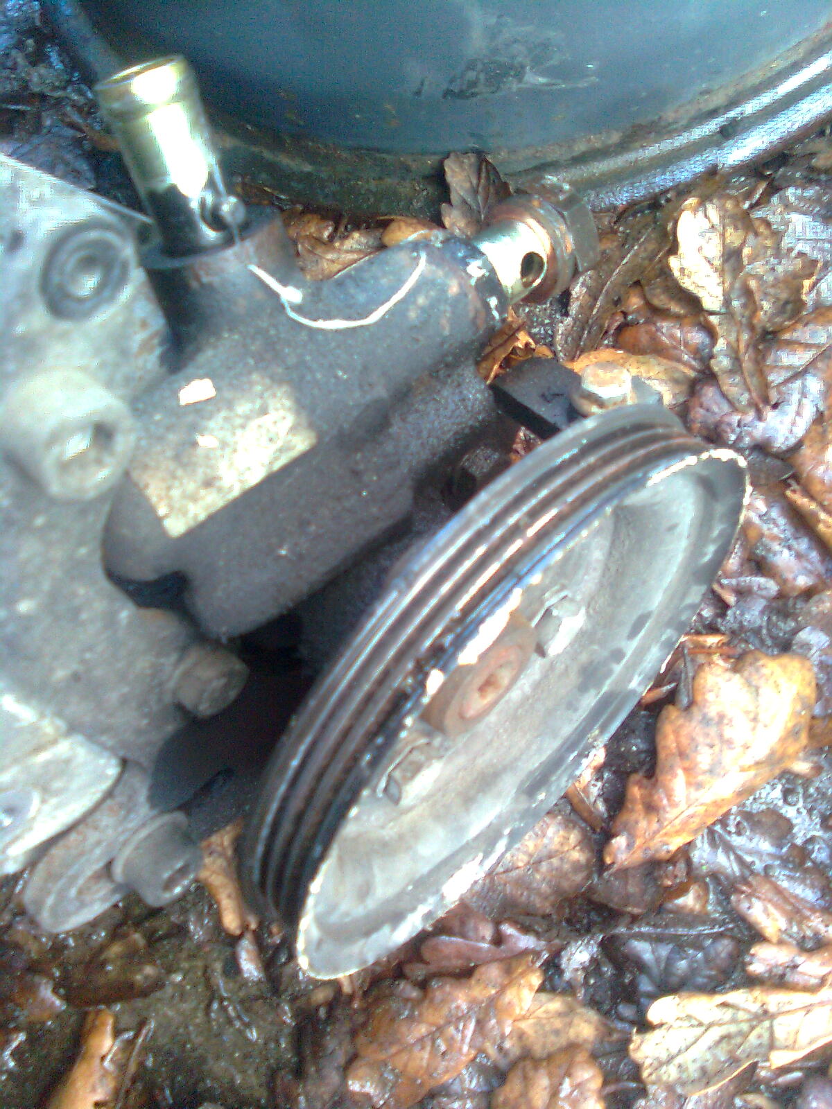

Scuffed power steering pump pully probably explains why this one has packed up (n)

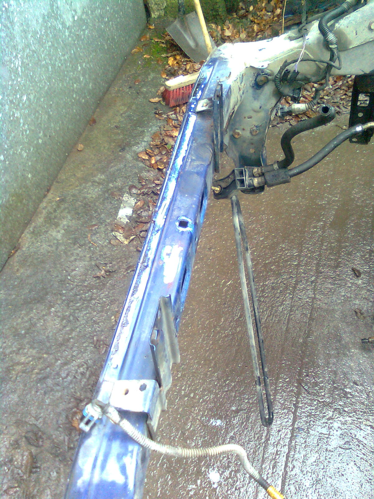

Bit of an update, couldnt do much due to that cursed snow :mad:

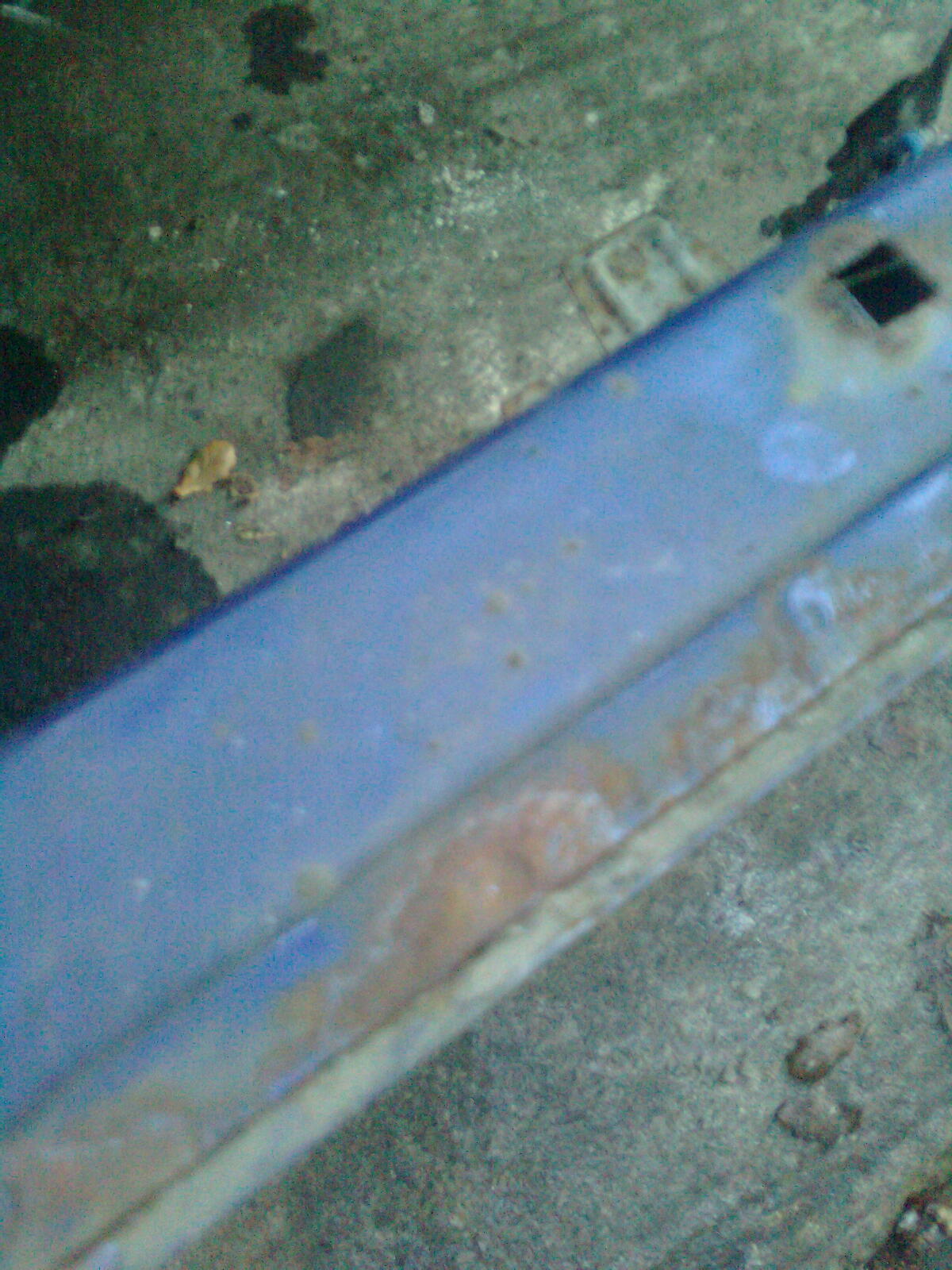

Had a poke round one night and found more rust
And a true quality repair job :ROFLMAO:
Needless to say, they were duly ripped off there and then (y) just have to fill in the holes now :mad:

The interior is nearly ready, just need the door cards out and the roof lining out
