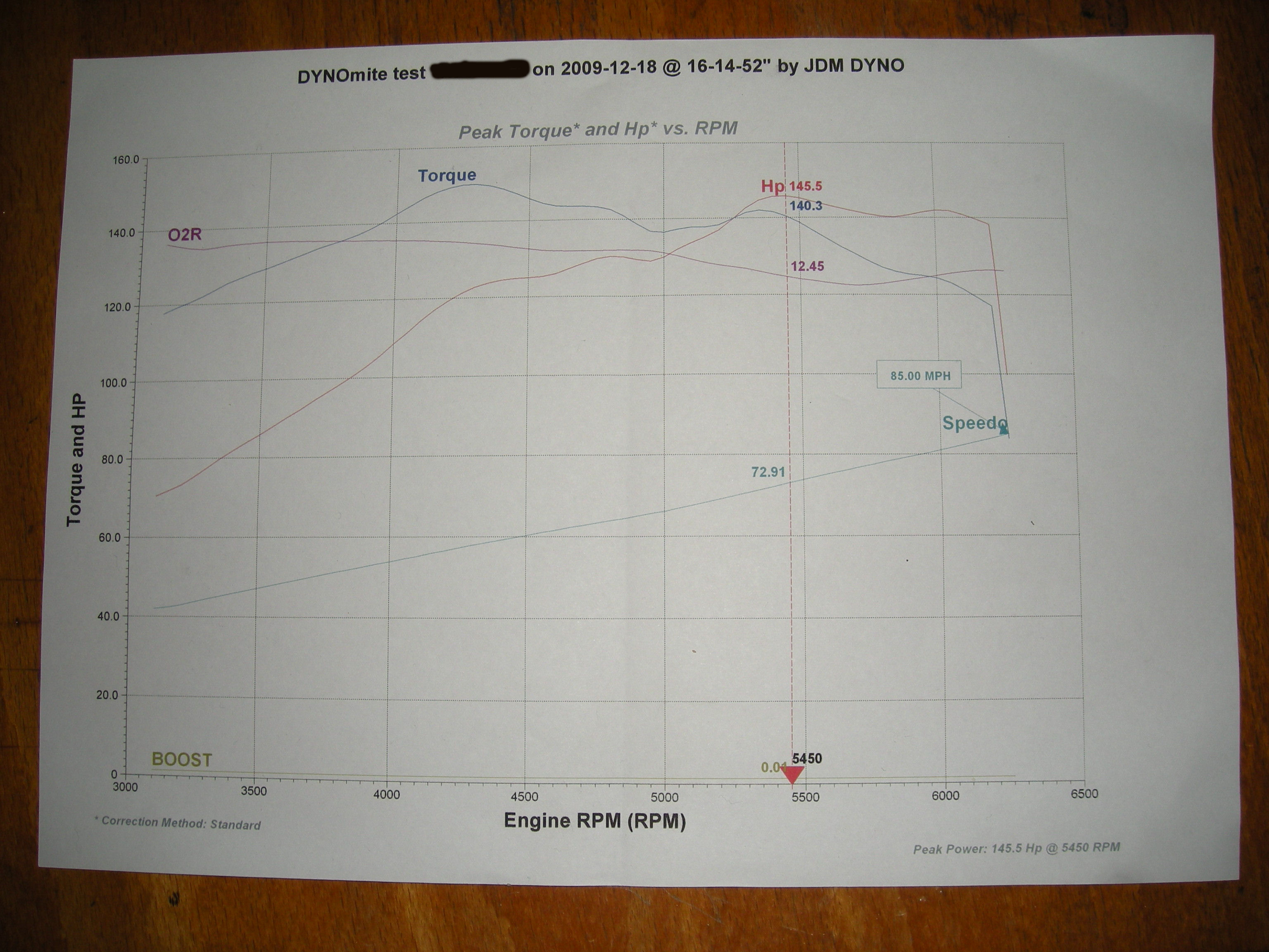

Power graph:

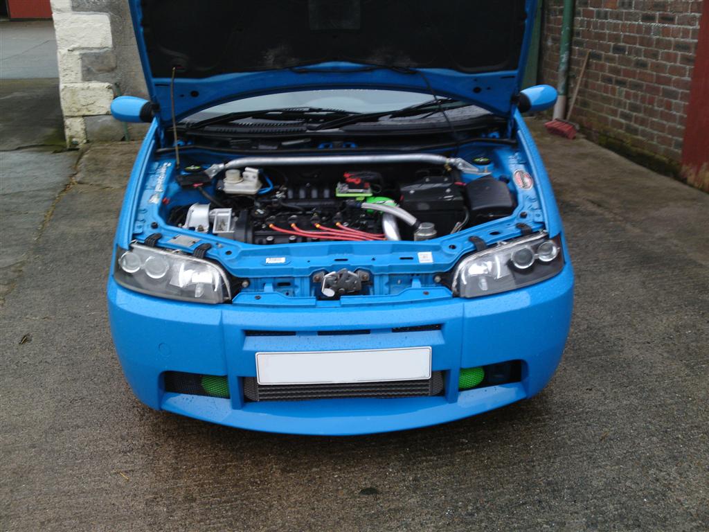

ENGINE MODIFICATIONS :
- Munkul-spec turbo conversion
- Munkul-spec tubular manifold
- Garrett GT1549 turbocharger
- Front mounted intercooler
- Ferriday 1.2mm decompression plate
- Greddy REBIC IV fuelling management
- MR2 FCD
- Modified inlet manifold with 8 injectors
- SFS green boost and intake pipes
- Supersprint backbox, custom munkulbodge downpipe and centre section
- Magnecor KV85 HT leads
- CG Motorsport 3-paddle cerametallic clutch
- Sump modified for oil return
- Alloy/stainless oil catch tank with stainless braided lines
- Stainless relocation bracket for brake fluid reservoir
- Carbon Fibre battery cover
- Lots of stuff i cant remember

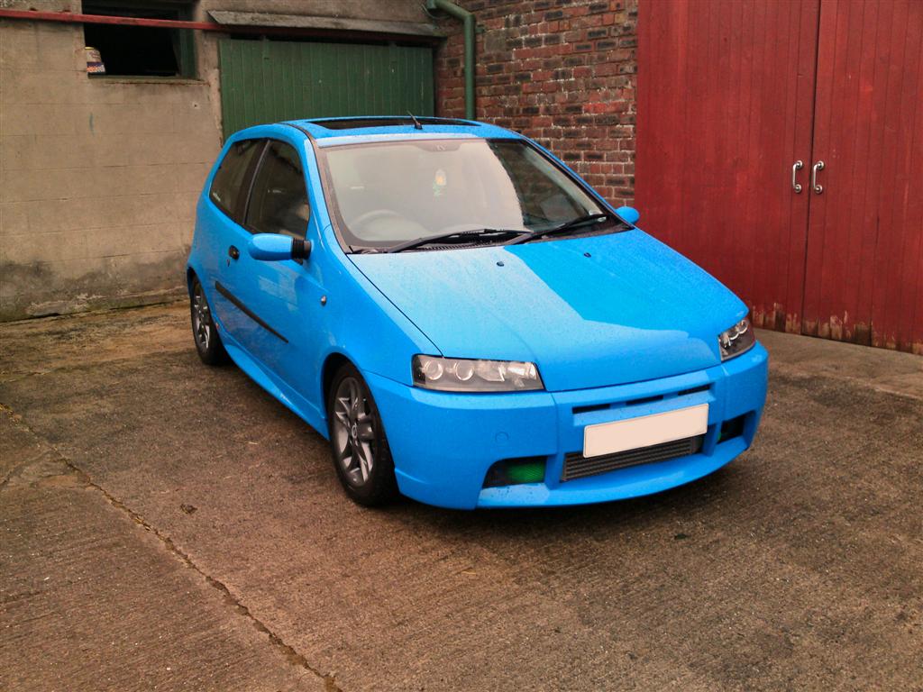

STYLING MODIFICATIONS:
- Full Abarth bodykit
- Colourcoded mirrors
- Black/silvatec side repeaters
- Mk2b rear lights
- Detangoed headlights
- Debadged boot and bonnet
- Short ariel

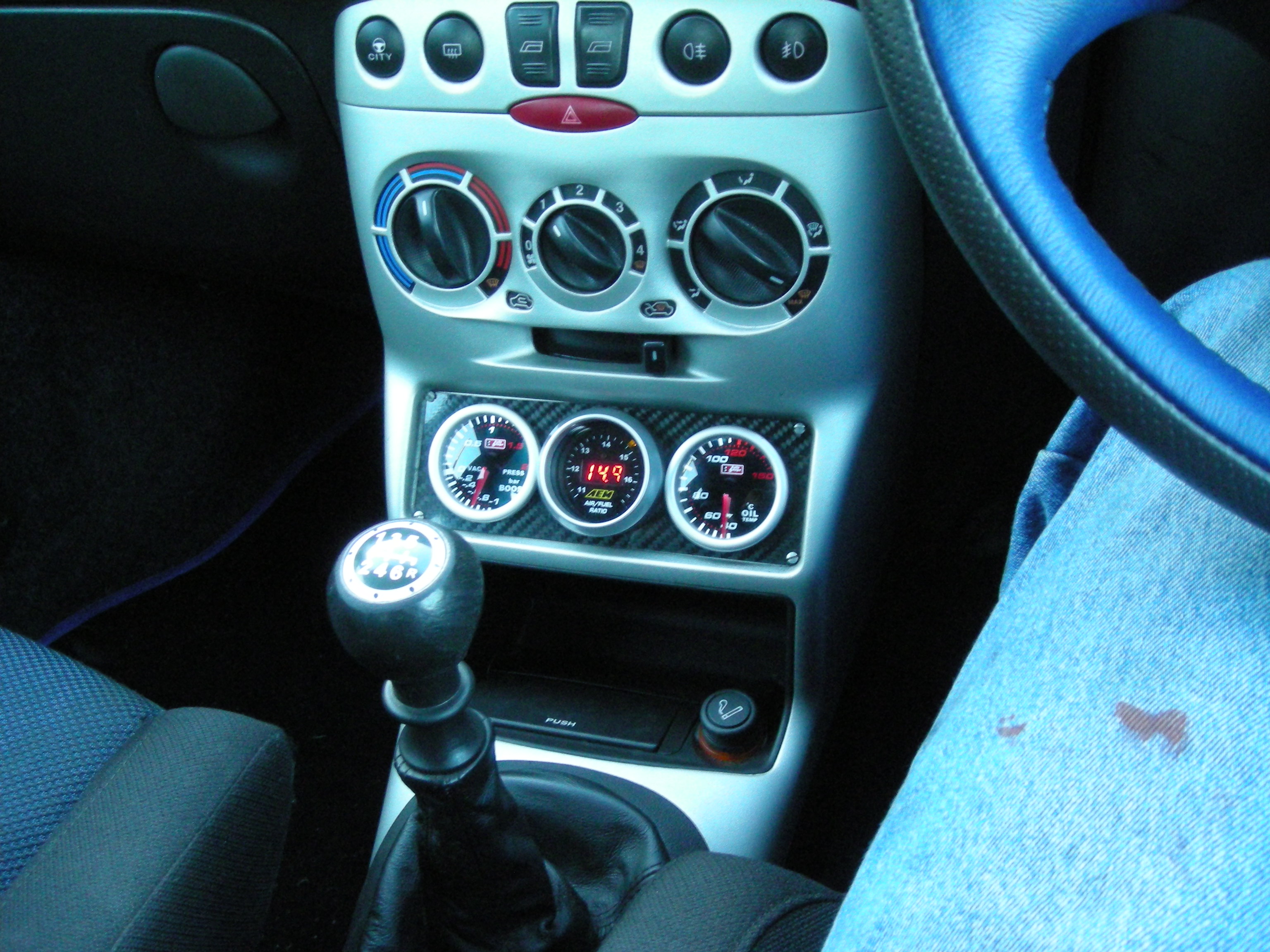

- AEM wideband AFR gauge
- Autogauge boost and oil temp gauges
- Carbon surround
