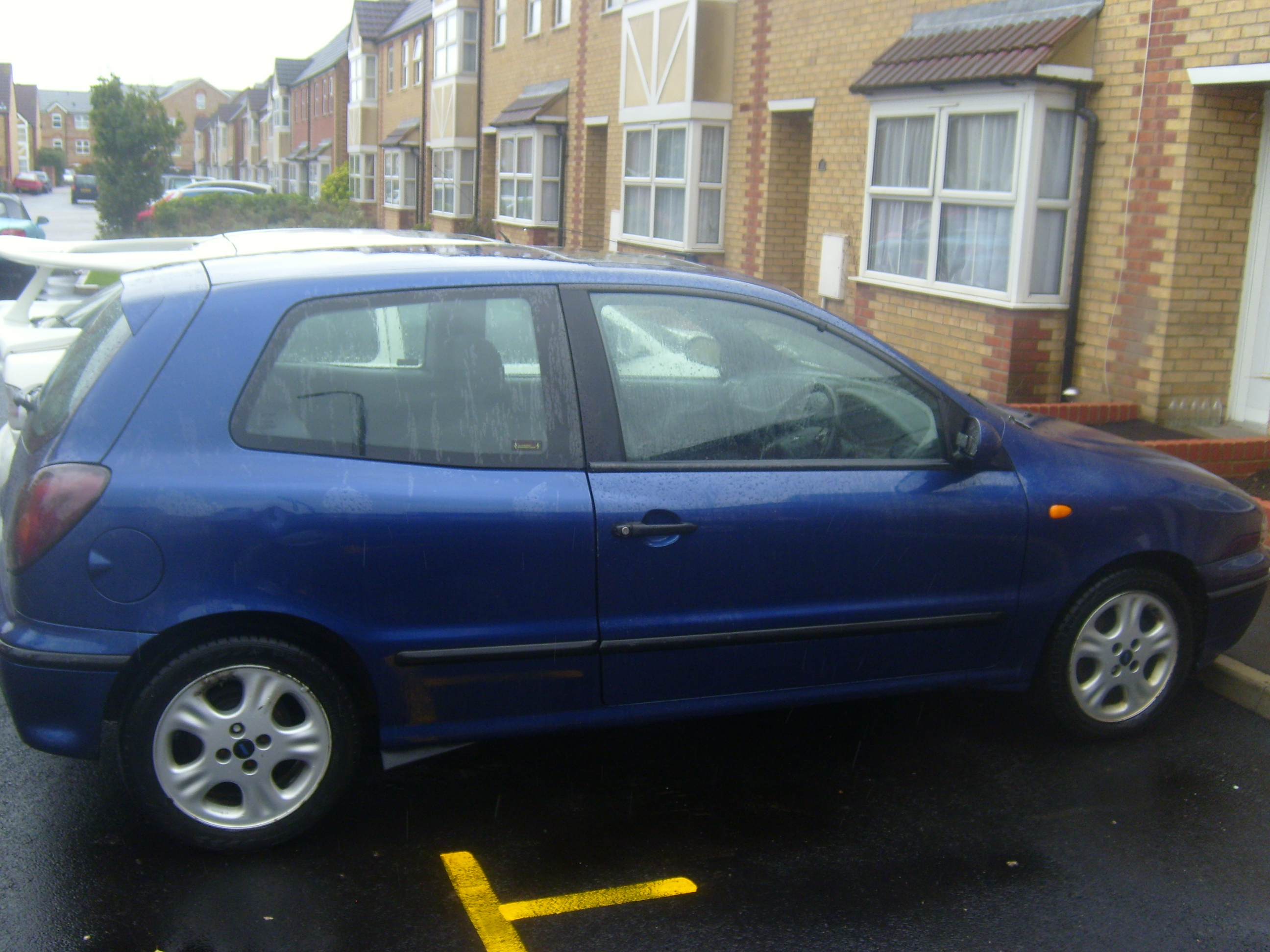

Bravo (Classic) the £90 bravo 1.8 hlx

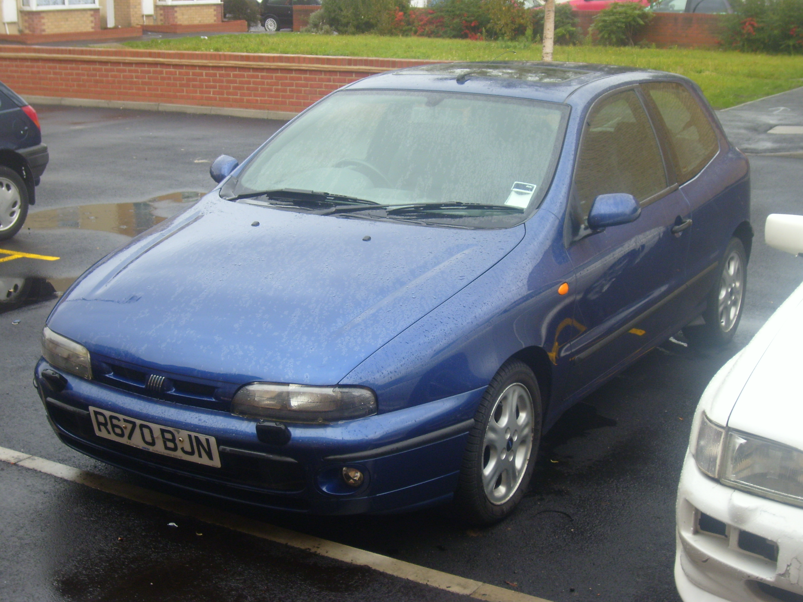

couldnt say no at this price! :D mot failure on brakes- which il be able to do within an hour at cost of about £35 (y) but not in this weather :( pissing i down. its really nice to drive though, feels so more solid compared to my punto, bodywork isnt great but its nice and again much better than my punto.
My god for £90 that looks in pretty good shape, excellent find (y)

admit it, the bravo makes a mk1 punto seem crap and dangerous.

and yeah, the bravo is much better, even than the mk2 punto.
cant really compare it to the uno cos i dont think you can get much more 'crap' and 'dangerous' lol
