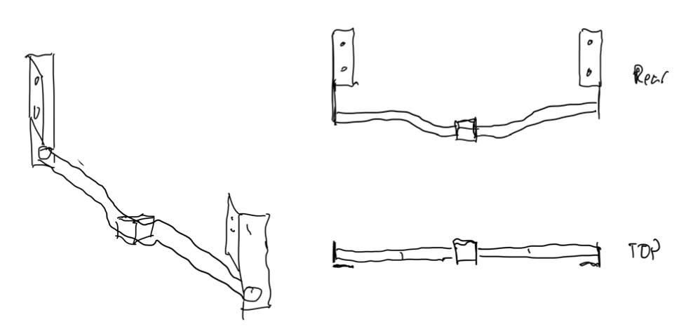

The bumpers only attach to thin sheet metal at a perpendicular angle - they're not designed for any vertical loads . So use of them for a bike rack would probably quickly lead to tear out unless you put something to distribute the load. Your best bet may be to engineer something that sandwiches between the rear engine support panel (that the bumper attaches to) and the body itself or fabricate a tubular crossmember that uses those same mounting points, but dip below the bumper to hold a 1.25" hitch adapter (quick and dirty draft idea attached)... or some iteration of a Seasucker setup.

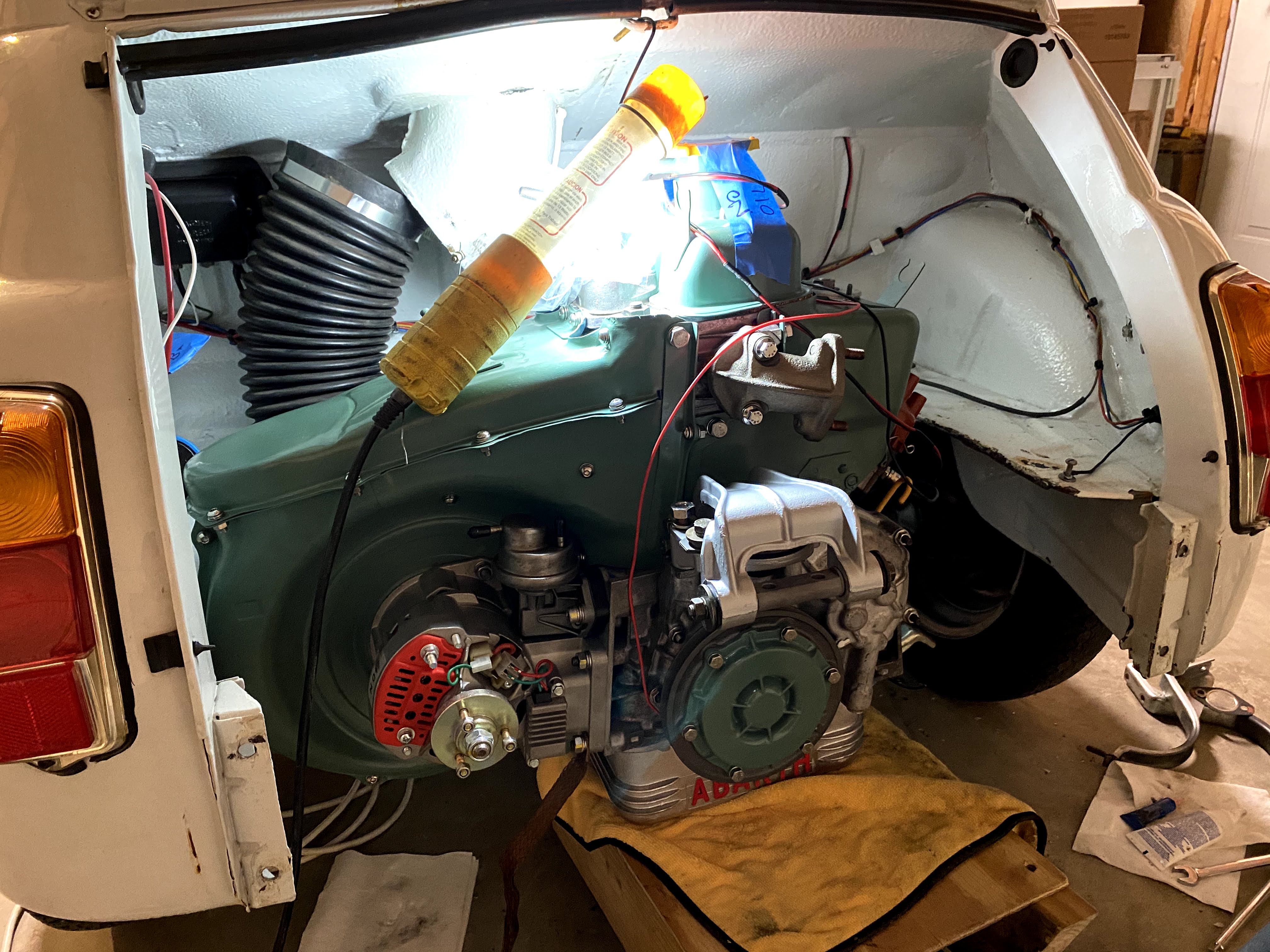

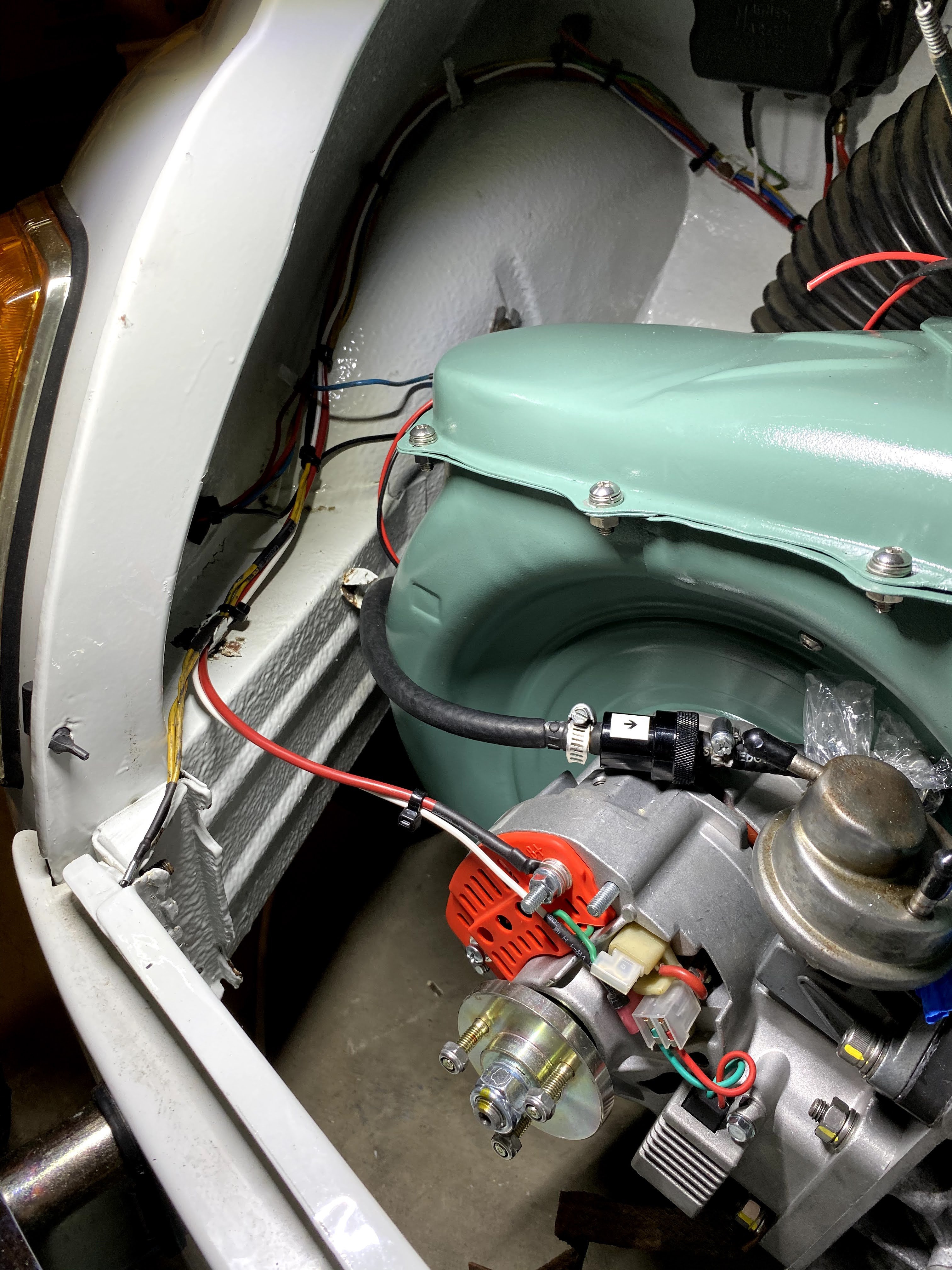

Here are some pics of the mounting points without the engine support/bumper panel and with it installed.

Thank you Matt! I was going down the same line of thinking - e.g. using the engine mount structure, but trying to come up with a way that does not require moving the engine mount bar. I am thinking what you sketched out, but maybe with some additional support rods that bolt into the body further in as well. Really appreciate the input!!
Sure thing. You’re basically just making a custom Class I hitch. You can google image search to get all kinds of design ideas for already-established products.
