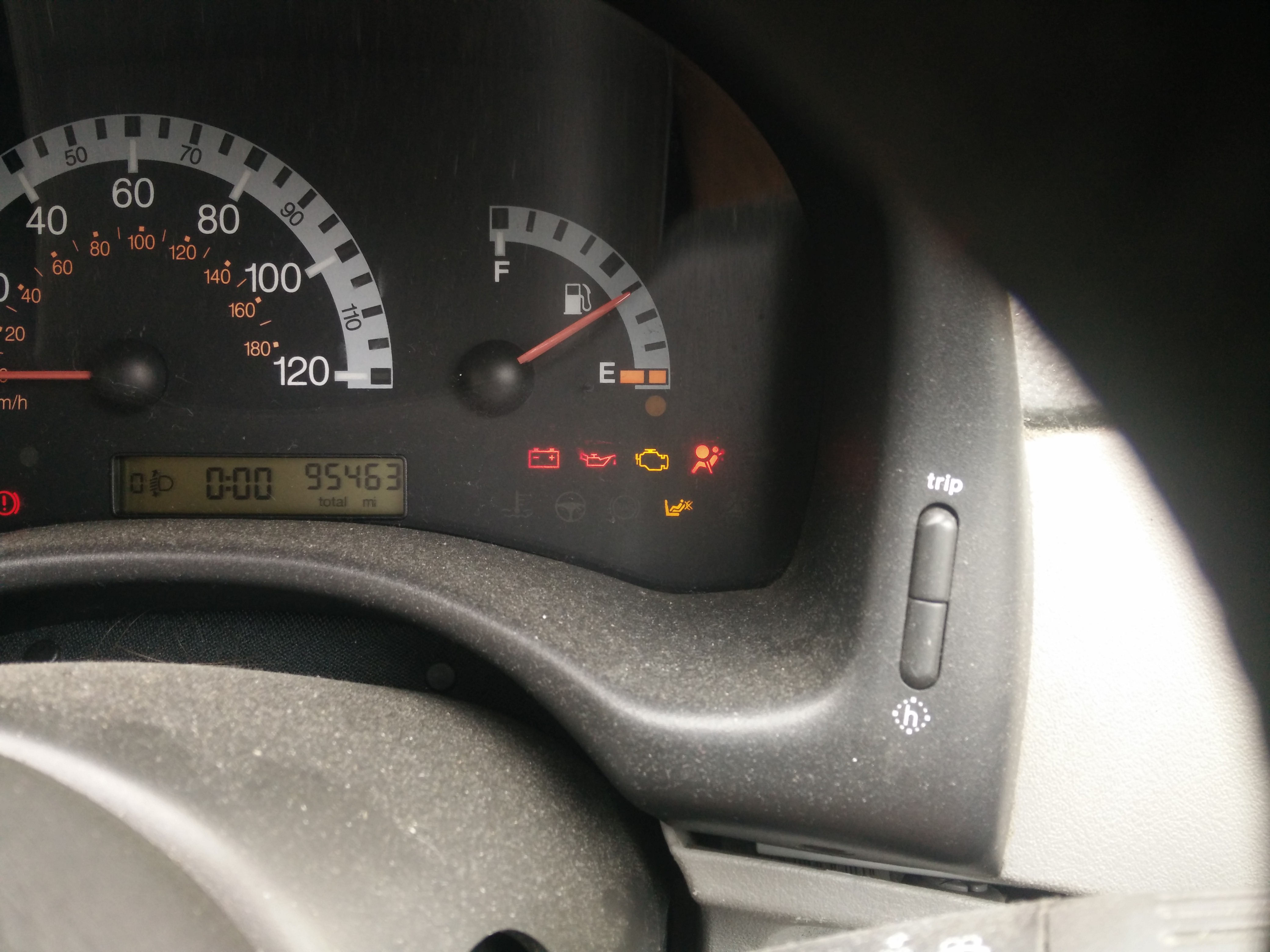

Lights when I turn key but not ignition in picture.
When I turn the whole way it just sounds like a dead battery. No lights are on at that point.
If I then turn off and then on without ignition get a flicking of lights coming on and off including code light which then turns off.

Check all the battery and earth cables, pay sepcial attention to anything you moved when removing the ECU, guessing ECU is on side of batery box same as Panda.
Check/swap/charge the battery.
It's a power problem, not an ecu fault.
Battery is fine, the weirdest thing happens after I turn key i get all the pumps sounds but no lights then the lights up and then go off then come back up.
If I turn on the heater fan the dash lights go out the fuel gauge drops to zero.
when Iturn off the heater fan the lights come back and fuel goes up again. electric windows do the same thing but dont have enough power to move them.
Sounds like a short somewhere but I dont have a clue where to start looking?
Not a short, but a lack of current.
Check the earth (black) cable(s) on battery and where they connect to the car.
Could be live, but more likely earth.
To get the ECU out, you'd have moved these around, if thet're old and a bit corroded they could have broken at one end.
If the car was working before, it will be something you touched, or connected to something you touched, so start there.
Try connecting a jump lead from battery negative(black) to the engine, see if that makes a difference, then try it to something bare metal on the chassis, like a big bolt.
