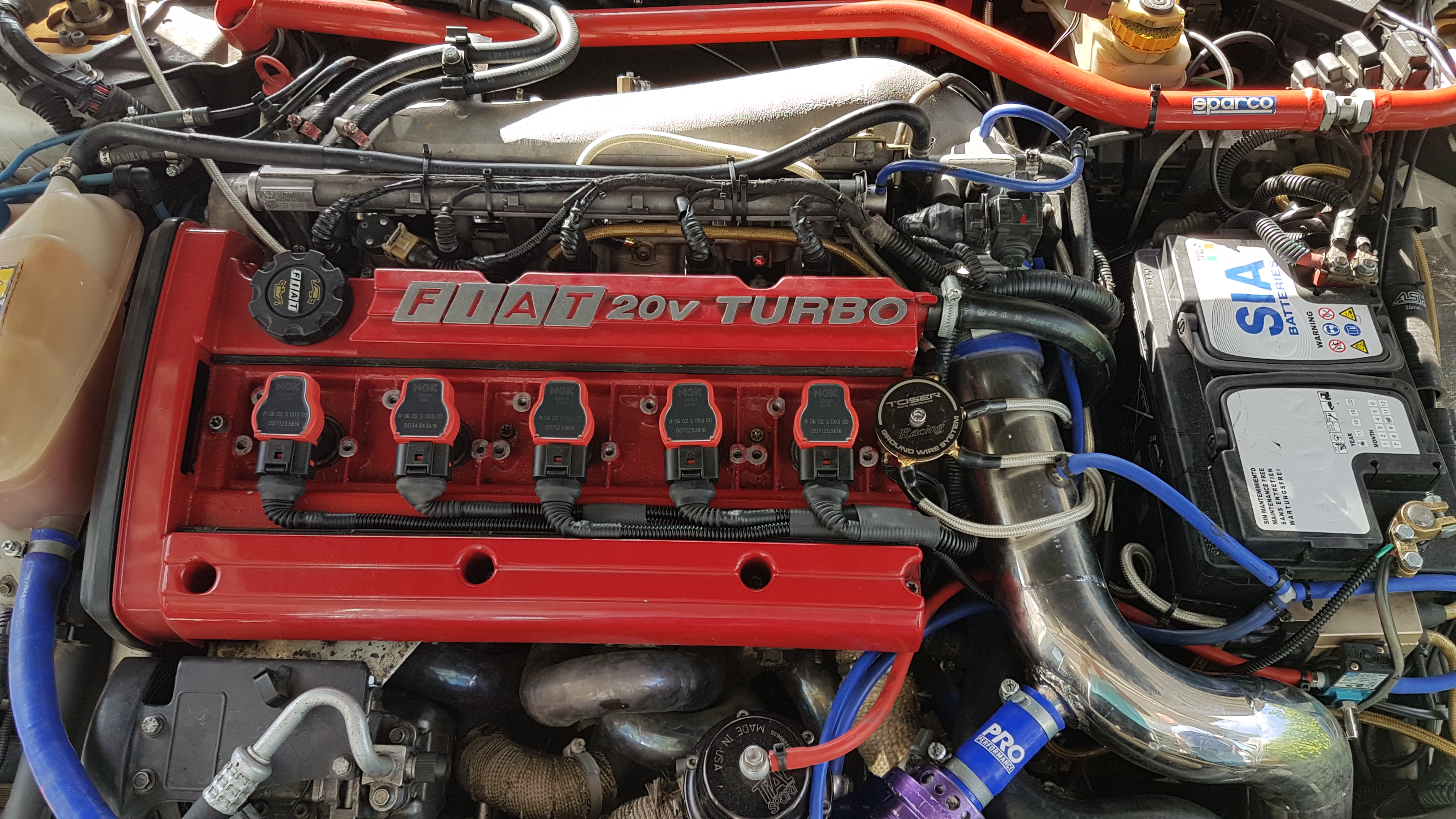

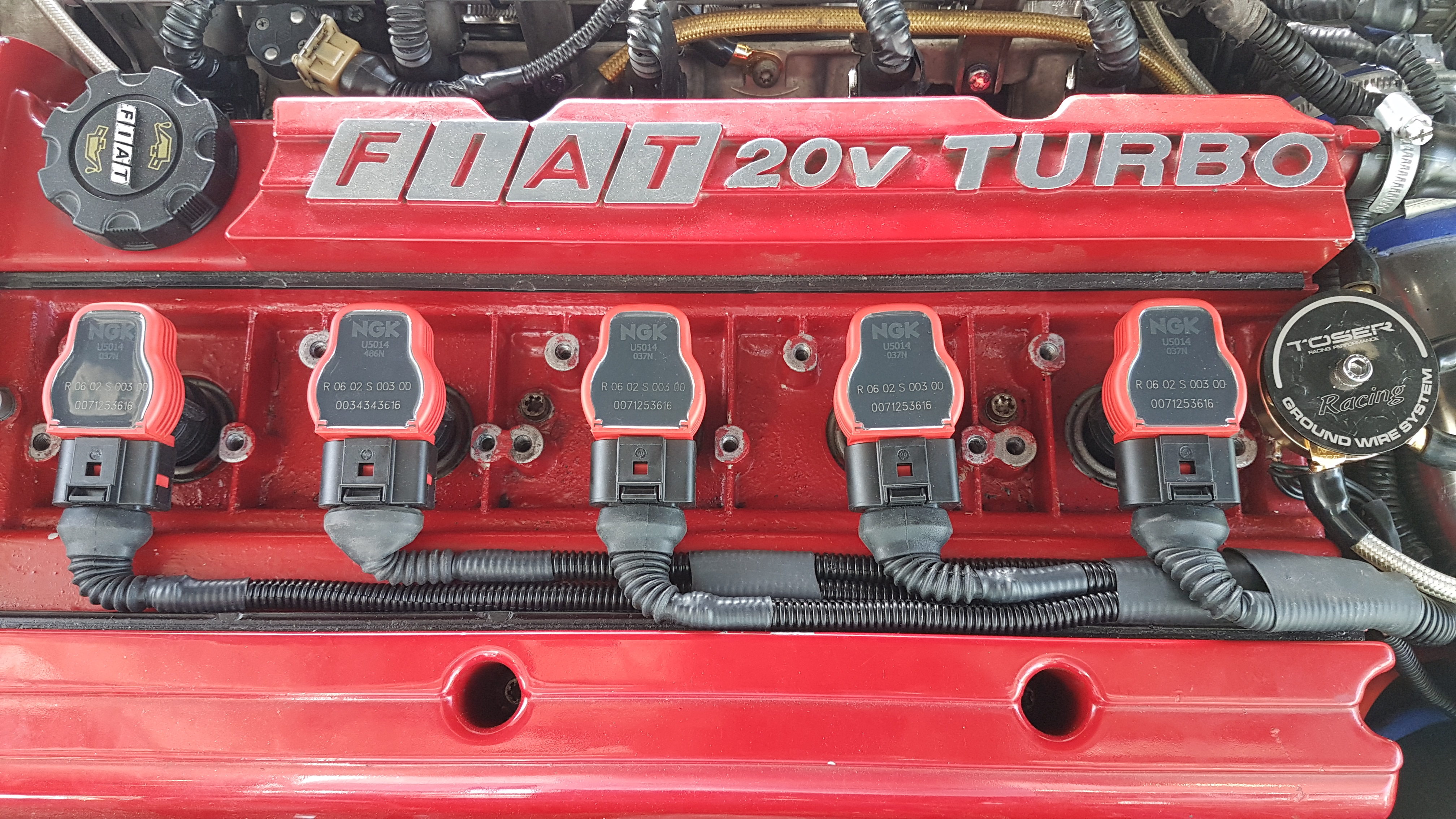

Hi,
After a long time of r&d we are proud to have a cop kit with 5x ngk platinum spark plugs,5x u5014 famous ngk-vag coils,wiring,and electronics pcb conversion.
The kit wil provide a very stable idle and a hv spark up to 2,7 bar of boost with
no misfires using the std ecu.
