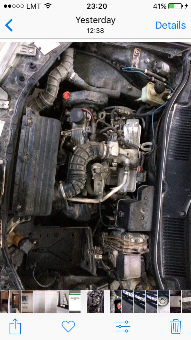

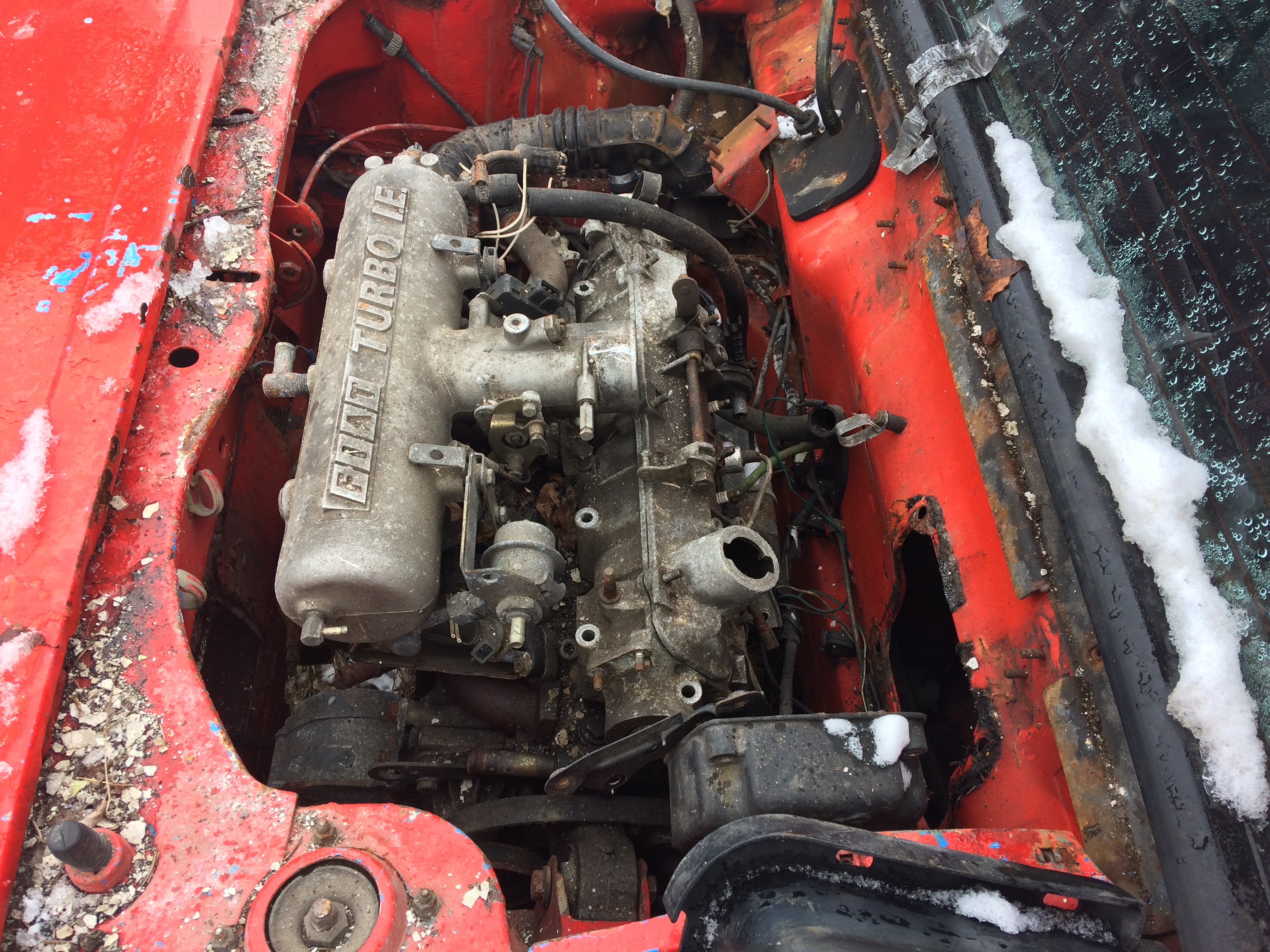

Hi
I have x19 with uno turbo engine in it, shape is unknown, been sitting at least 14 years with cutted belt in deep corner.
Also now have Punto 1,6 90 in good shape as engine donor.
About fiats my knowledge is near 0, used to drive others classics.
Could You please tell me, can I mix these engines? For example use turbo with uno ecu on punto engine? And If can, what else I'll need that I have and that don't have?
Hi! Yes the engines block is the same family. I think the idea is sound. You might need a lower compression ratio on the punto engine and fueling might be an issue with the larger capacity with the uno ecu but it may be ok for reasonable power.
