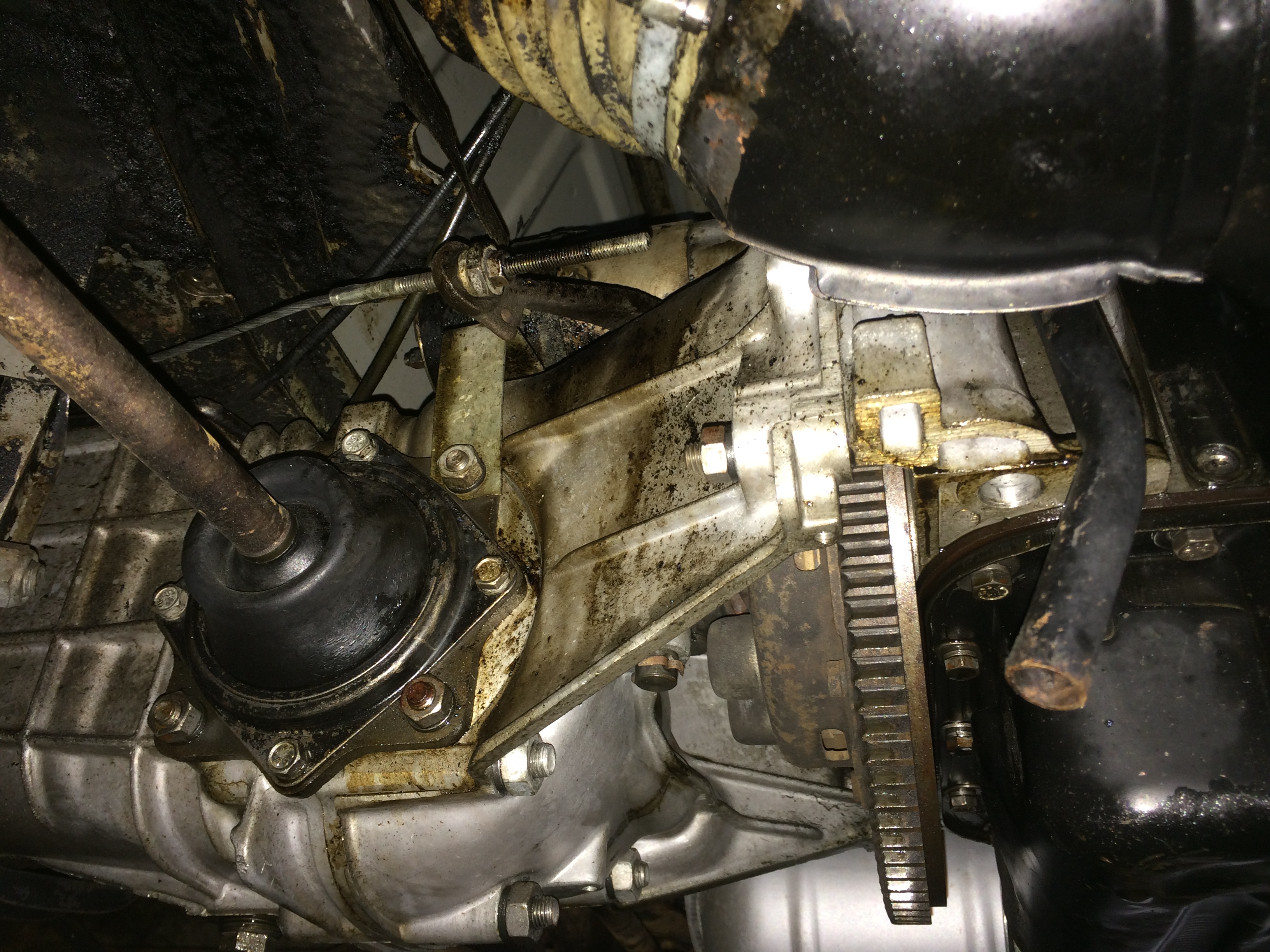

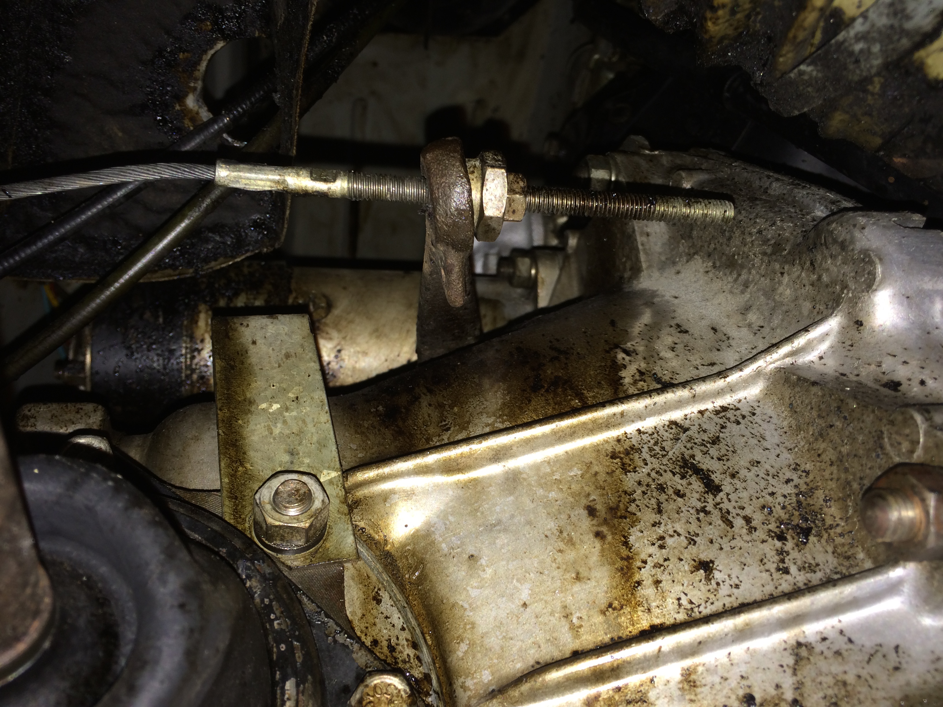

I have been poring over this, as well as the manual and even the youtube video a user posted on the clutch heel toe thingy and the non-synchro gearbox. But still clueless...
Starting from the beginning, ie yesterday, I went for MOT and took the car for the longest drive she's had since purchase. Egads it was stressful, to the point I almost turned back.
Essentially I cannot change gears without a crunching sound and an awful feeling that something bad is happening transmitting up the clutch pedal. I am double clutching on downshifts to no avail, and slowing markedly trying to gently ease it into gear. Admittedly I haven't tried the accelerating a little while in neutral as this seemed counterintuitive to rev up when trying to change down. But the crunchiness is on both up and down shifts.
I pulled the carpet back to rule out any restriction on clutch being depressed all the way, but that failed, and so as a first step I'm keen to adjust the cable - but I have no idea how! The manual is, to me, totally cryptic :(
I've looked at these pictures and wonder if I adjust the nut one way or another that Peter had been playing with, then I'll have some luck?

Not sure if this is the issue - comparing mine with the post from fiat500 there's no spring
Although this seems to be more to serve the purpose of re-engaging the clutch.
Also I have oil everywhere! Will have to replace the sump gasket and see if it's that, hoping its not gearbox oil

It could be the clutch cable needing tightening as in my post, it might be the position of the gear lever needing adjusting at the side of the internal tunnel, the clamping of the clutch cable has cropped up many times on here, but my guess is that the rubber "lollipop" connection from gear rod to gearbox actuating rod is damaged or loose or too tight. The MOT man may have pulled on an already weak component to test it or inadvertently been a bit rough with gear-changing through unfamiliarity.
It is least likely to be an internal gearbox issue.
Fiddle around with it or at least upload some images of the underneath arrangements for our perusal. Good luck.(y)
Thank you fiat500 does the lack of spring on the clutch lever underneath as in the pics seem a concern.
The gears have been iffy since I got it, but I hadn't got it above a few trundles around the street so it didn't really alarm me, so thankfully it wasn't the garage.
Would I access a view of the internal tunnel accessed from inside the car, or underneath?
