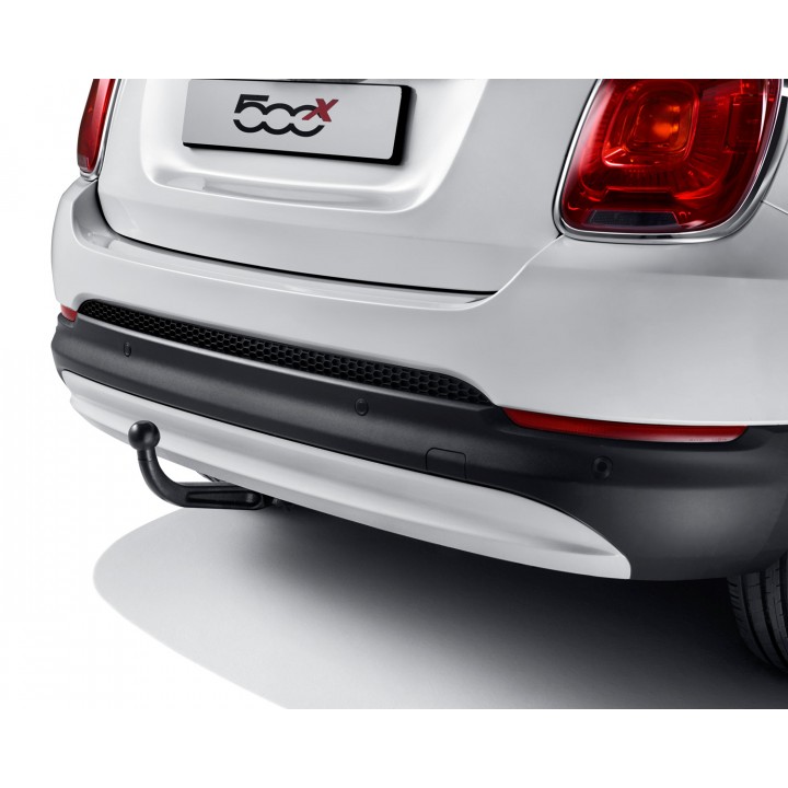

To fit the tow bar is dead easy. All the required holes, mounting points are already drilled and filled with blanking plugs which you just remove. Just follow the supplied instructions. My tow bar was a Brink detachable but I've read the instructions for WestFalia and GDW and they are all pretty much the same.

I personally chose not to use a dedicated wiring kit as this has to be routed through the car requiring cabin trim removal and fiddling around under the dash etc. Even if you fit the dedicated wiring kit (which is expensive) it will only cater for trailer/caravan lights. They do no support caravan battery charging and fridge etc. so one will still have to do this as well. I used the standard AND REQUIRED 7 way bypass relay and voltage switching relay. The disadvantage of using a bypass relay is that the parking sensors will not be disabled. No big deal IMHO. I'm also pleased to note that with the detachable swan neck tow hook attached to the car the reversing sensors DO NOT detect the hook.
With the Brink tow bar then the foldaway 13 pin socket when wired with a normal rear entry socket WILL NOT fold up. I also suspect that this will be true for other approved tow bars. The reason for this is that the socket plate is only 15mm to 20mm away from the rear valance metal work or the car. One could cut some metal to get around this but I chose not to. On speaking to Brink they supplied me with a cable side entry rear socket cable gland but to fit this one has to also make an accurate corresponding semi-circle cut in the side wall of the socket. Even then one would have to bend the wires immediately at the terminals which I think will be very very tight and may still be a problem. The company that supplied the tow bar also kindly made extensive checks with various 13 pin socket manufacturers and nobody appears to make side entry sockets.
