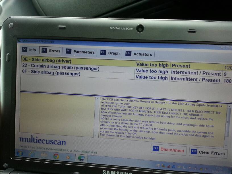

Ok so had the codes read big thanks to varesecrazy (charlie) at the autoitalia show. Anyways on his screen we found this
can anyone help on what the exact reason for this is. Is it a case of dirty contact any help appreciated thanks andy
The ocs has had the emulator added for the mot six months ago so ruling that one out but will defo check the rear switches I think and contact cleaning under the front seats aswell
Ok update on this disconnected the battery undid all connects under the seats in the glove box and in the boot gave them a good spray with electrical contact cleaner left a few hours to dry reconnected them and reconnected the battery and bingo the airbag light has turned off cheers for the help on this one guys
