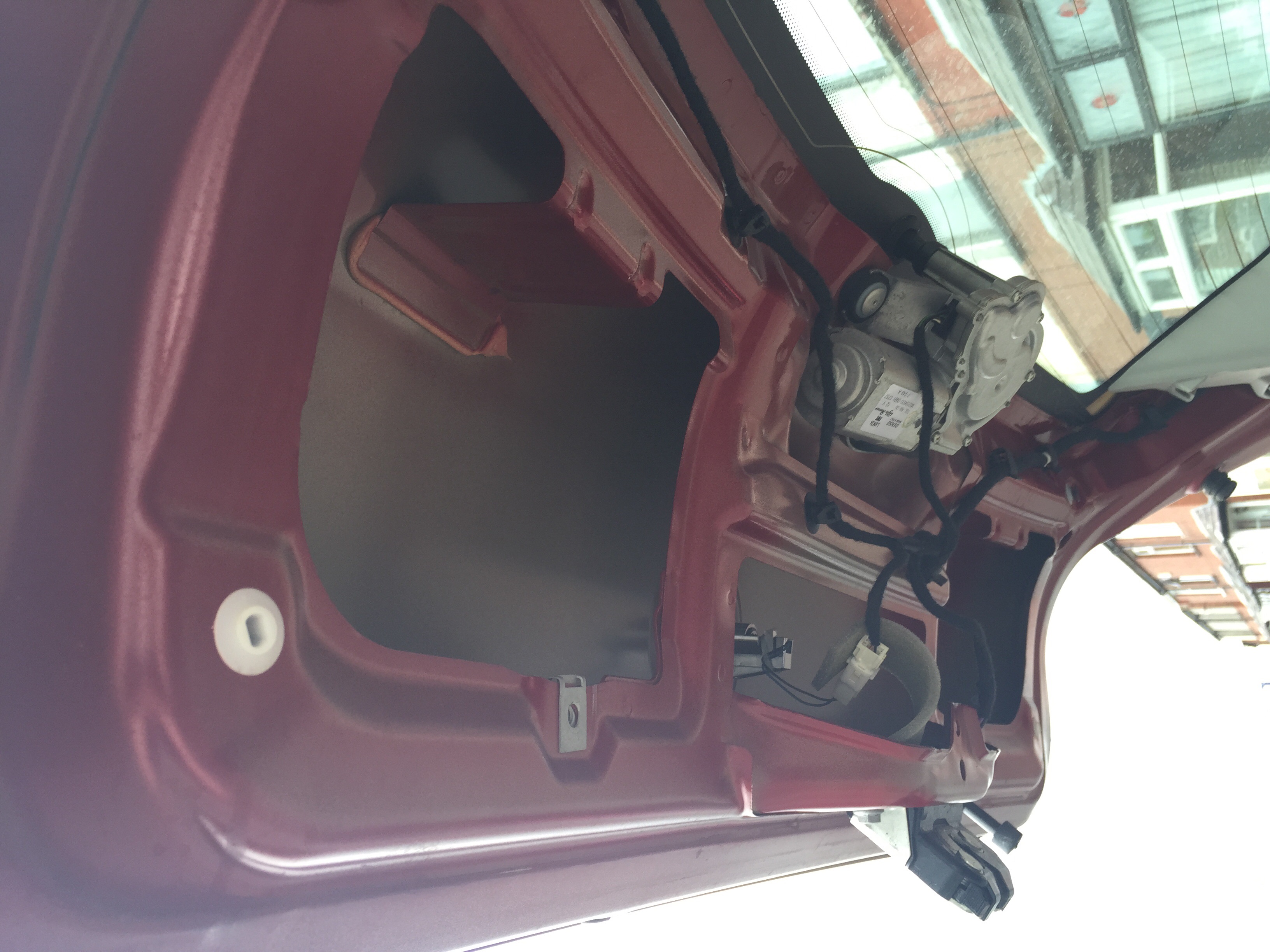

Then remove the black plastic panel that covers your boot gubbins. This is done using the Allen key bolts located in the boot handles. Keep the bolts safe. Once the bolts are out pull down slightly on the handles and the panel will drop. Pull the panel away from the boot popping each plastic fastener. It may sound like you're breaking it but you're not.
Once the plastic panel is off, locate the back side of the badge and locate the wire coming from the switch. Follow this till the first connector, probably wrapped in sponge. Unplug the connector.

If everything's fine, refit the black plastic bootlid cover. This is where you need a bit of patience. Before trying to refit, make sure all the black plastic lugs are where they should be on the cover and not stuck in the White receiver in the bootlid or you'll have a rattle and I'll fitting panel. Everything should clip in ok, but letting go it will end up dropping off under its own weight. Refit the Allen key bolts and tighten up, give a good press near the location of the plastic lugs (suggest pressing up from inside as you are pressing down as if to close the boot) and make sure everything is in place and rattle free.
