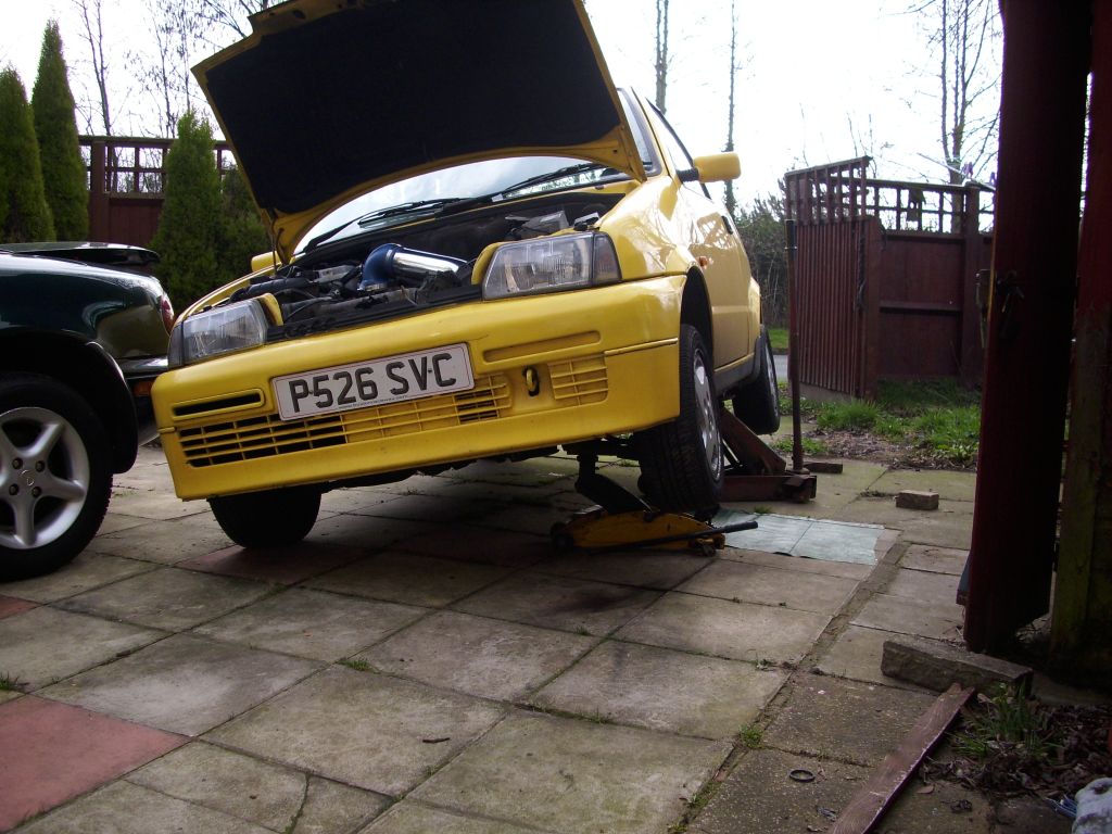

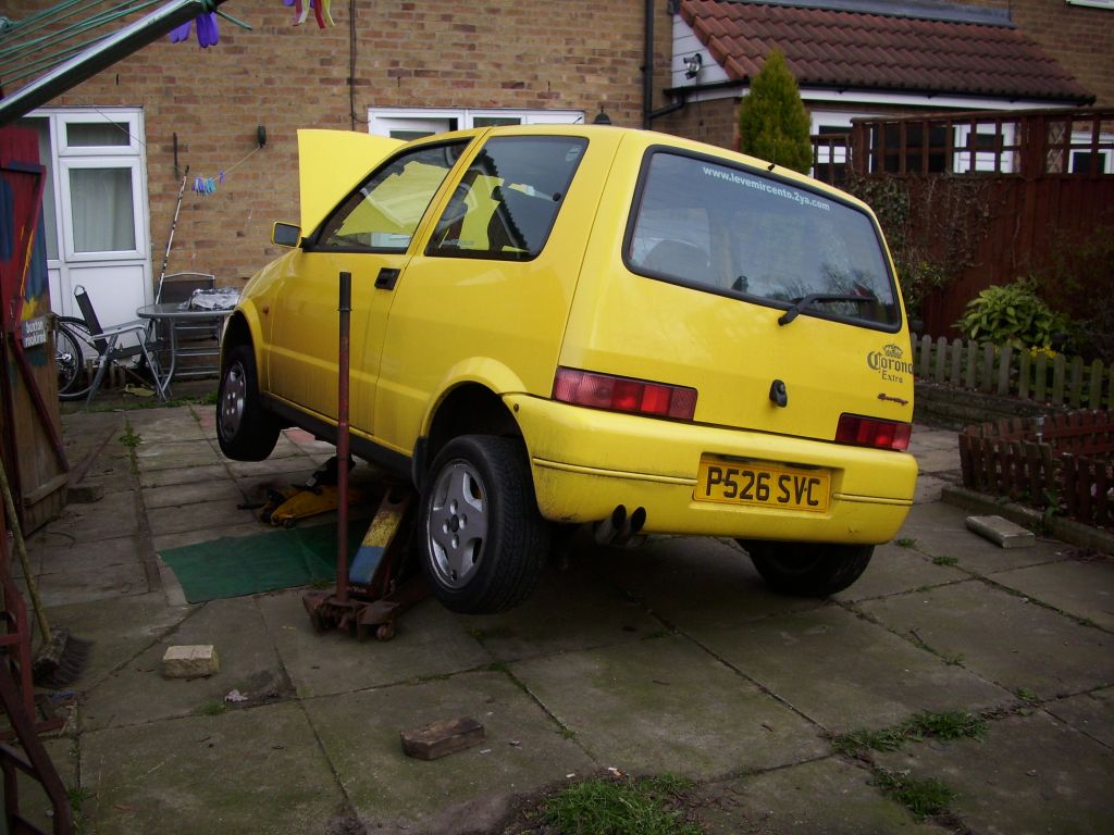

First off, you need to be able to have good access underneath the middle of the car, do this via ramps, or jack the car up, I used two jacks and jacked up one side, now I fully trust my jacks, and I wasnt going to be pushing or pulling anything underneath which would potentially make the car fall on me, however the sensible thing to do would be to use axle stands and dont go underneath until you are sure its safe to do so

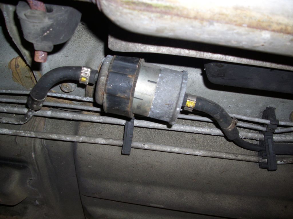

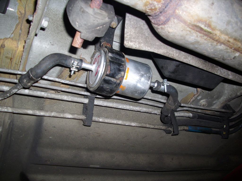

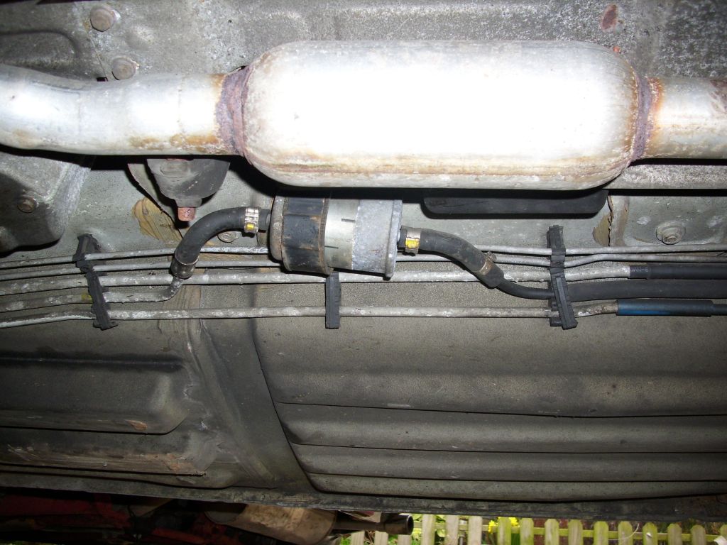

Here we have the fuel filter, its on the drivers side of the tunnel next to the exhaust expansion box, the filter has two small flexible fuel pipes fitted to it

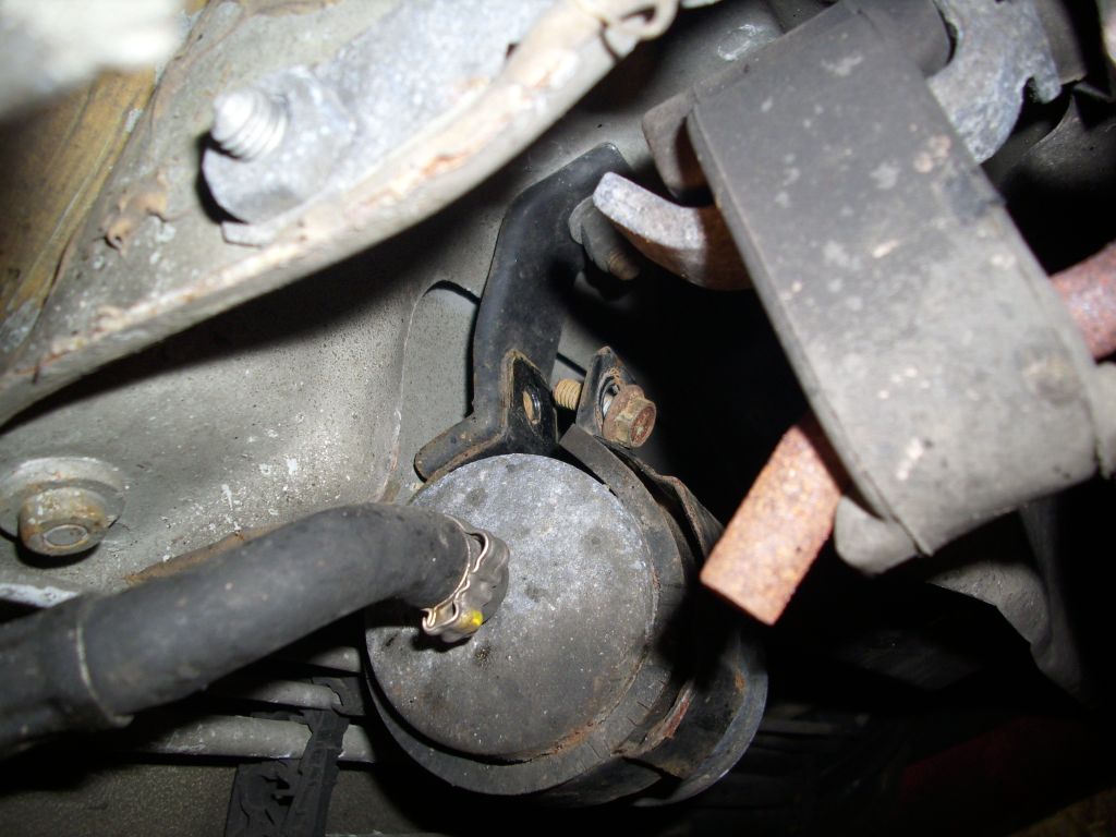

Using a 10mm socket, undo the bolt located at the very top which holds the metal clamp around the filter, this is fiddly to get to and this is where a good amount of access underneath really helps, fully remove the bolt
Pull the metal bracket from around the filter, it just bends out of the way, dont lose the rubber sleeve

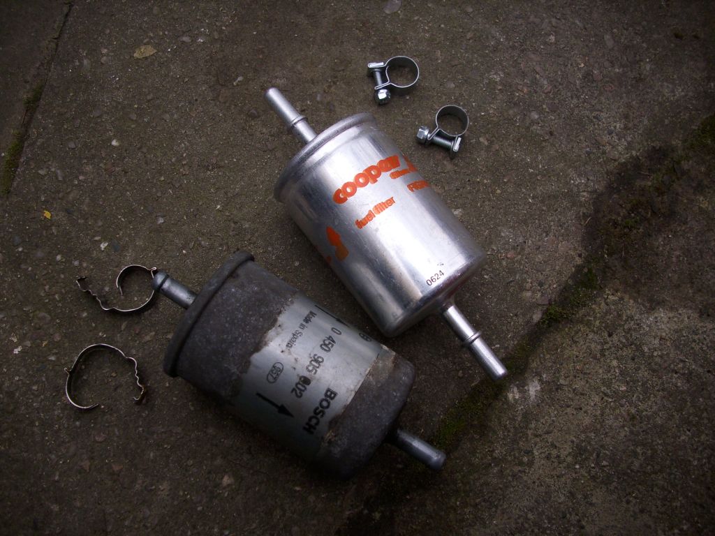

With the filter removed, compare it to the new one, my "lucky dip" find off ebay was just the same, except slightly longer on the inlet and outlet pipes, spot on that'll do for me.
Fit the new clips to the two rubber fuel pipes, then fit the filter back to the car noting the fuel flow arrows, the arrow must point forwards to the front of the car, this is the direction of the fuel flow, important.
