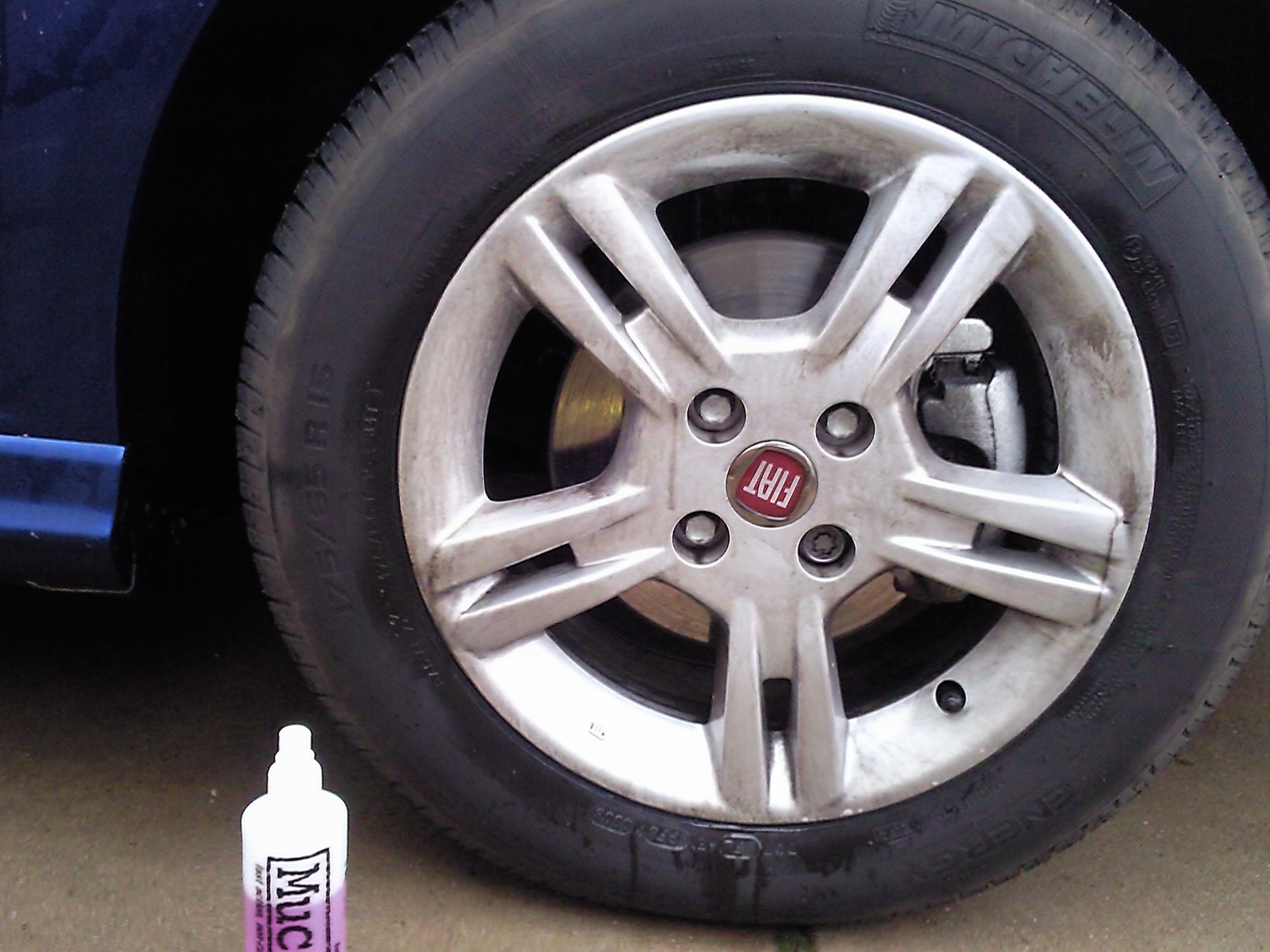

No doubt your wheels are in a state like this:
i) spray on wheel cleaner
ii) leave to dwell for a few minutes
iii) either spray again and aggitate with a wheel brush or
iv) jet wash off
This should leave your wheels looking somewhat better like this:

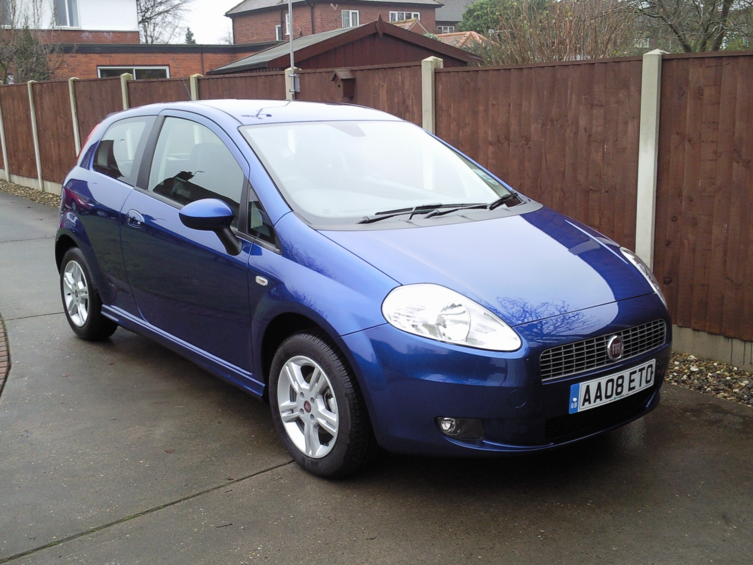

You should now be left with a pretty clean looking car. Heres one i did earlier:

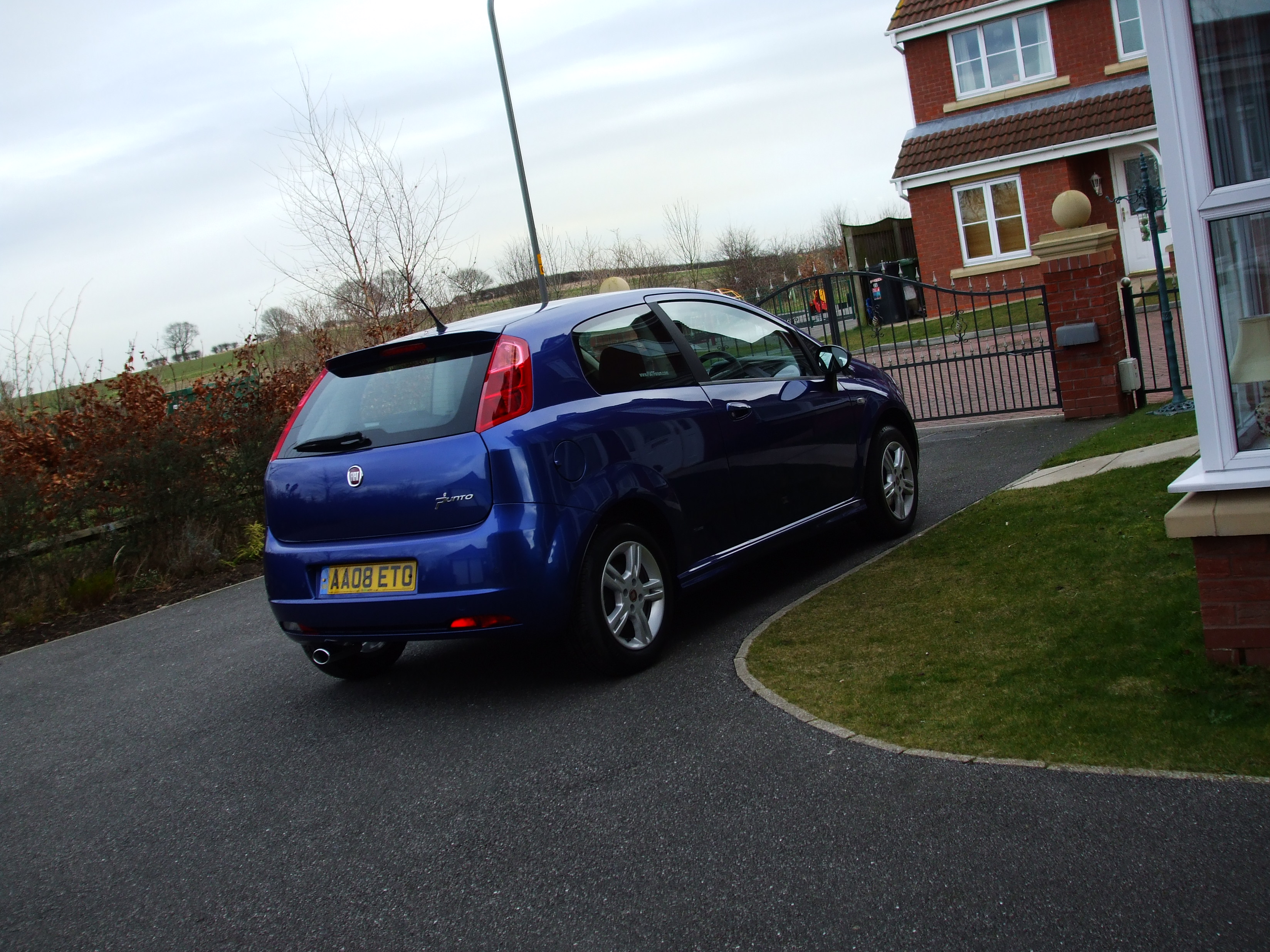

This is basically it, after this, your car could look as good as these:
sure you dont mind Matt and Andy.
