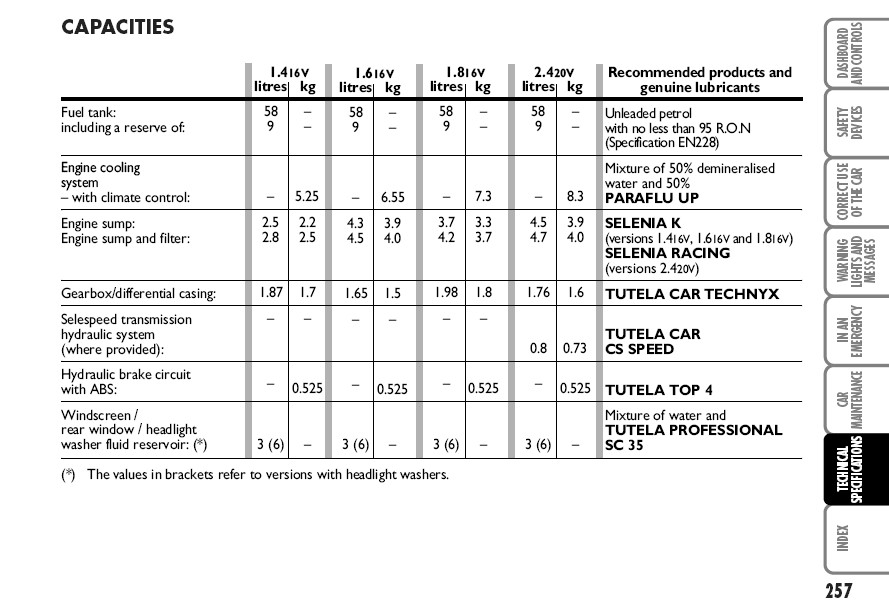

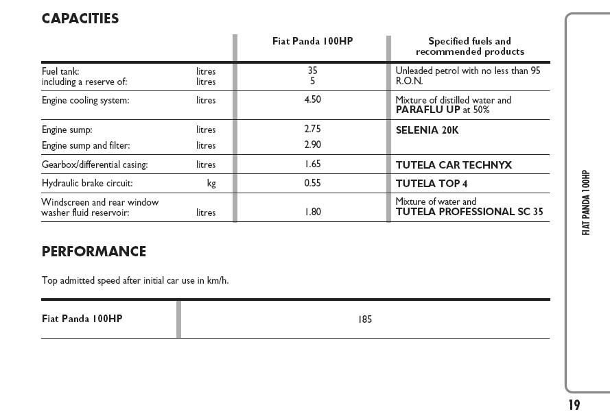

This do?
do you mean you removed the cam variator? the variator is hydraulic, but that wont affect oil capacity (only your high rpm performance).
looks like it does from above figures by 100ml
ive just changed oil an filled up as per the non vvt engine above figures an no smoke yet. last time i filled to max on the stick an it smoked after driving only a few yards down the road
