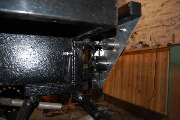

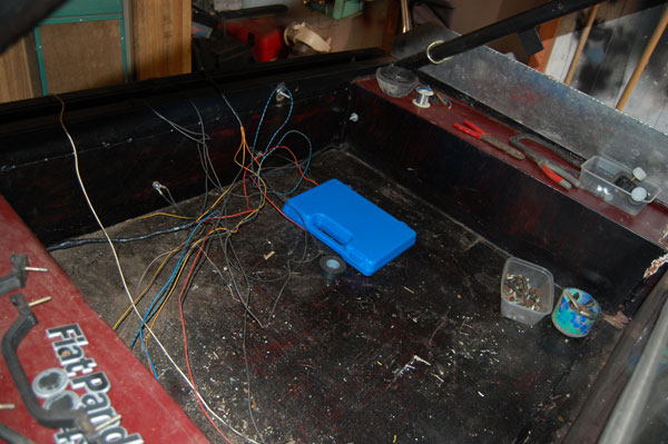

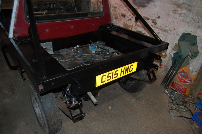

Just thought I'd post some recent pictures of the Rat build. It mostly concerns the wiring so far but I've also fitted the front and rear number plates and round reflectors to the rear bull bar to complete the rear lights.
The rear wiring looks pretty messy at the moment but it works. Once I've bought and fitted the fog and reversing lights I'll tidy it up properly and that will be the back end finished! Woohoo!

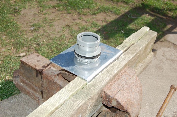

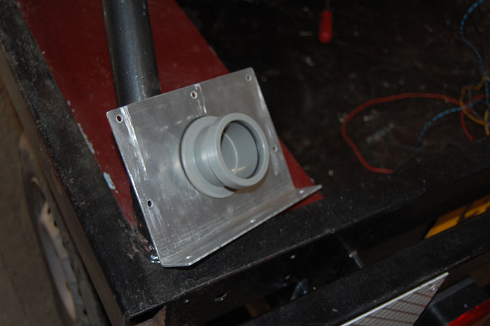

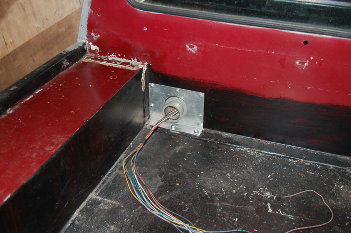

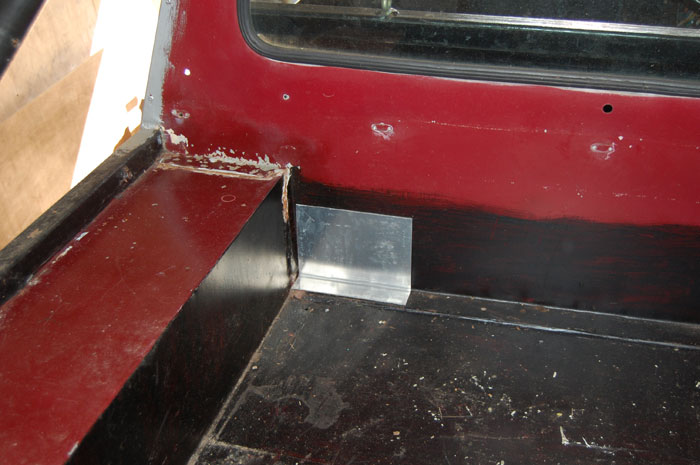

I decided to make a conduit for the wiring to go from the cab to the back end. Originally there was a small slot cut out of one corner of the cab at the back and the wiring passed through here and was sealed with a large dollop of silicon sealant. I wanted to make something a bit tidier so I started with a small aluminium panel cut from a bigger sheet, which I bent in a hastily constructed Heath Robinson style bending machine:

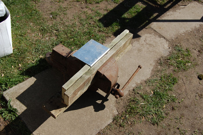

I had a suitable plumbing fitting lying around which I'd previously bought for something else but was ideal for this job. The idea was to cut a hole in the panel I'd made and fit this for the wiring to pass through. It had to be big for the multi-plugs to fit through.
The finished panel:
And the panel fitted with the wiring through it. I intend to get hold of some rubber from somewhere to make a suitable grommet that will force fit into the round opening to seal it.

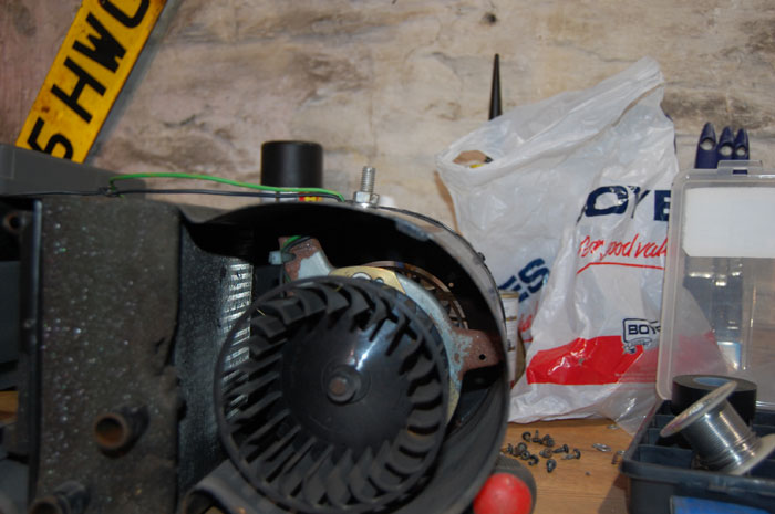

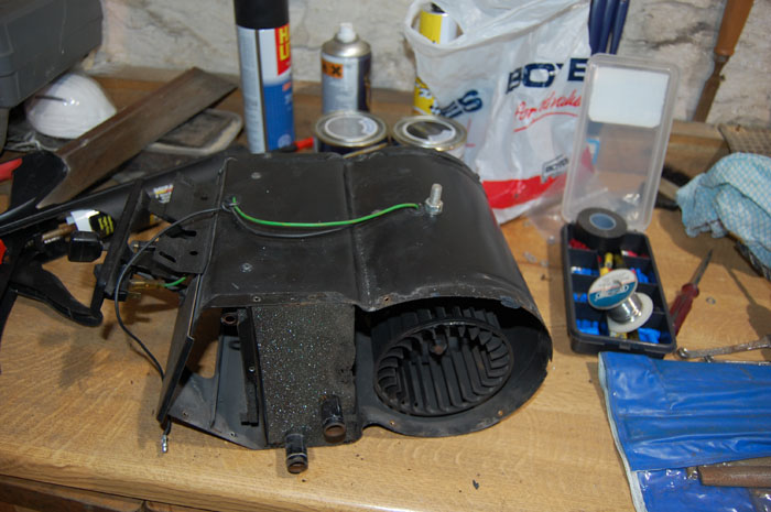

Another job tackled today was to start fitting the Mini heater. It wasn't as easy as I'd hoped it would be but then things never are. I started by modifying it slightly by drilling a hole in the top of it to pass a bolt through. This bolt will pass through a hole in the bulkhead to secure the rear of the heater inside the car. There is a small panel on the front of the heater which is where the fixings are for use in a Mini which I will use in the Rat but I need to make a suitable bracket for this. For now, the heater is dangling on the one bolt while I sort out how the air and water plumbing will work.

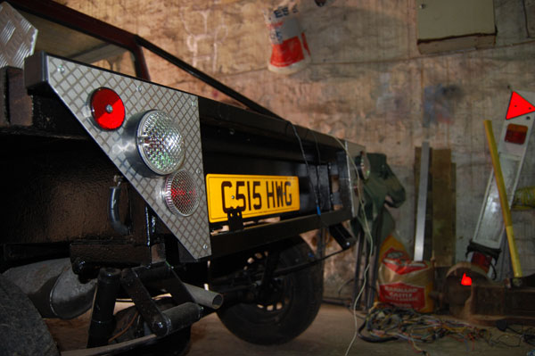

And lastly, I took off the rear bull bar so that I could finally paint the rear end. When the bull bar goes back on tomorrow it will be finally bolted. That will mean the back end is finished! I just need to get all the lights working properly, which is tomorrows mission.

No pics today, sorry. Carried on with sorting out the rear lights. I've finally got them all working and tidied up the wiring. This took most of the day. Finished off with a bit more painting. The weather has turned nasty so might not get much done tomorrow. Hope it clears up.
